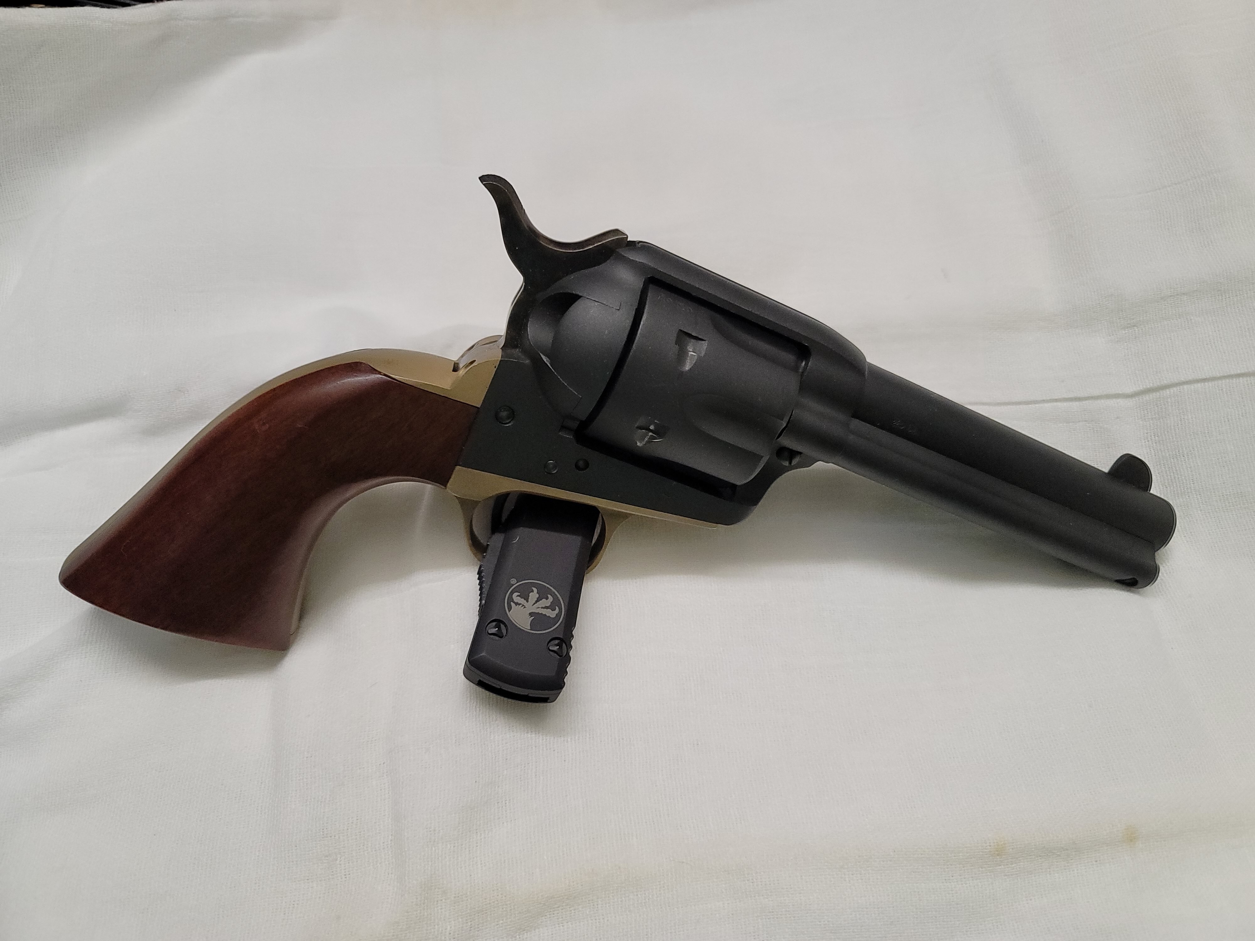

Got a decent deal on a .357 Cattleman, but absolutely HATED the finish.  Looked like it was spray painted by Earl Sheib.
So with a little elbow grease I turned it into something much more appealing IMO.  Also changed the hammer spring and trigger spring, a little polishing here and there and it's mo'betta.

Is the first pic a before pic?   It looks like someone  cerakoted  the poor thing.  It looks almost like a Ruger Wrangler.
your afters have given it a nice looking patina.  Much better.
great,   from Earl Shieb paint job   to a  Mo Betta shirt.     you sir are a Magician,,,,

Yes, that was how it came out of the box from the factory.  Horrid.

Really did not bother me, as I said I got a decent deal on it and I know from past experience how to remove the ugly.  I have a 45lc that looks pretty much the same, guy I bought it from told me how he did it.
Little oil, a couple scotch brite pads, I cheated and used a wheel that had a scrub pad like material on my Dremel.  Took about 4 of them, but did much quicker than pads by hand only.
When Uberti first came out with that finish, ~20 yrs ago, it was called Millenium Finish.  I don't know if they still call it that.  Usually guns with that finish will also have brass gripframes as those are also cheaper than steel (that's why a Navy grip opentop costs less than Army grip).  Antiqueing them is the way to go, IMO.
