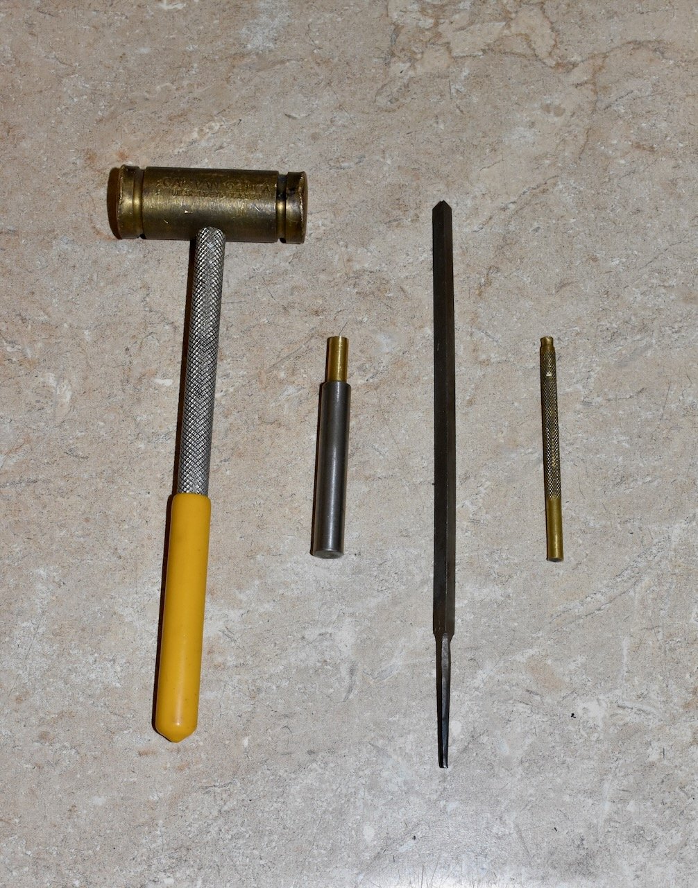

The problem with fitting front sights is that the barrel dovetail is a "nominal" .375. The sight has a "nominal" .375 dovetail. The problem is that in many if not most cases neither are .375 and if you try to install a .378" sight into a .373" barrel dovetail it does not matter what tool you have it is not going to work well and you are going to damage the sight. Here is what I use to install front sights on rifle barrels. A brass hammer. A homemade brass drift. And, most importantly, a dovetail file. (These only have teeth on one of the three sides.) The skinny brass punch that comes with most punch sets like the one on the right are pretty useless. Those little inertia hammer front sight installers are neat IF the two dovetails are the proper size. -

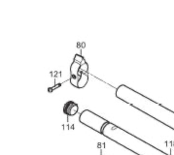

What "flange"? There is no flange in a Uberti tube. It is a straight tube. 19" models are carbines. Doe it have a barrel band that holds the tube to the barrel? If so did you remove the screw or pin holding it to the mag tube? Often that screw or pin is sticking into the mag tube and will block the follower or tube liner from going in. -

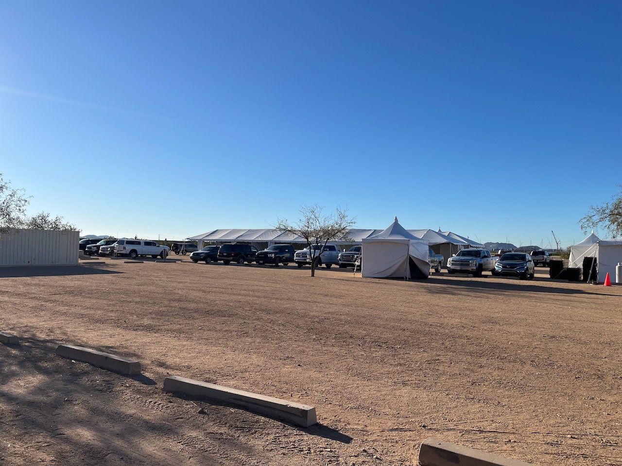

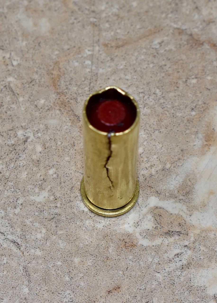

ACSA (Arizona Cowboy Shooters Association) started their annual EOT warmup today. ACSA shoots at the Ben Avery Shooting Facility where EOT also takes place. People were jammed in-between the EOT tents. The match was packed and sold out. Set-up for EOT begins this Wednesday, February 18. Meanwhile over at Cowtown the Fire and Ice EOT warmup takes place this coming weekend, February 21-22. It is sold out. The top photo was from the warmup yesterday. The bottom photo and todays weather - Sunny and 75. Tomorrows weather? Who knows.🤠I always hate being out of the match on the first stage but it happened this year. I was shooting the rifle and it jammed. Finally got the "empty" brass out but was not sure exactly what had happened so I quit after nine rounds. Turns out it was a split case with the bullet shoved down into the case. This was Starline brass and it was only the second loading. Had two other split cases but the rifle cycled so they must have split on firing. Poo.

45 Colt Split Cases
Larsen E. Pettifogger, SASS #32933 replied to Preacher Clint's topic in SASS Wire
Nickle keeps cases from getting verdigris if left in leather belt loops but embrittles the brass. Won 500 new nickle brass at a match one time. Loaded them with BP and tossed them after one firing. -
