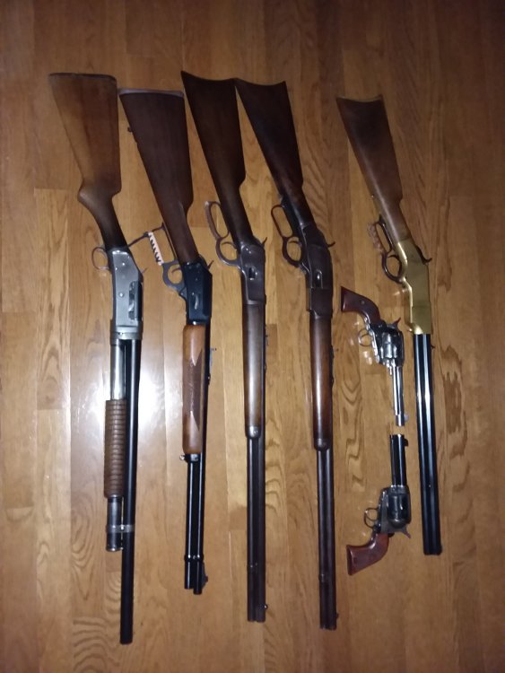

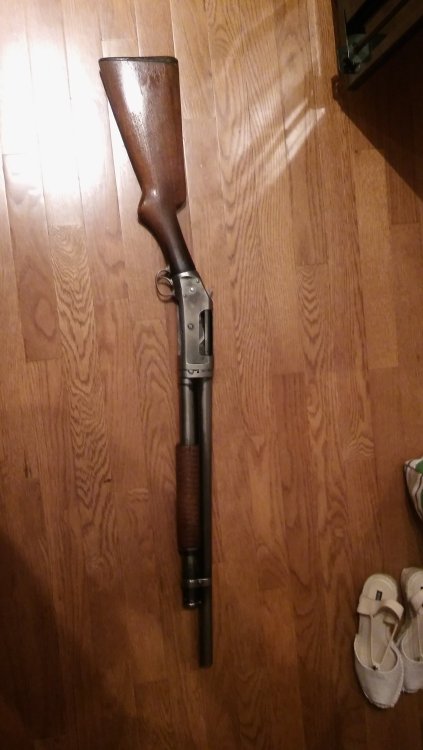

Tom Bullweed Posted August 28, 2022 Posted August 28, 2022 I recommend the your check that barrel length. My shortest 1897 is 18.5". I can easily get 4 fingers between the end of the mag tube and the muzzle. Your photo looks a bit short.
Tom Bullweed Posted August 28, 2022 Posted August 28, 2022 Just now, Tom Bullweed said: I recommend the your check that barrel length. My shortest 1897 is 18.5". I can easily get 4 fingers between the end of the mag tube and the muzzle. Your photo looks a bit short. Wrong 97. That one is 22". This one is 18.5"
Hells Comin Posted August 28, 2022 Posted August 28, 2022 5 minutes ago, Tom Bullweed said: Wrong 97. That one is 22". This one is 18.5" His is about the right length yours looks long.
