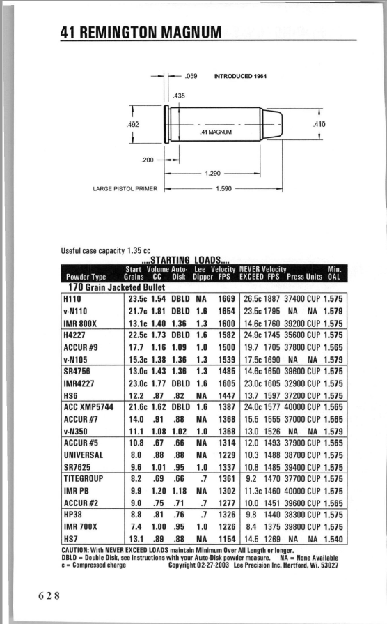

John Ruth Posted April 20, 2021 Posted April 20, 2021 So I have 3 reloading manuals and cannot find a load for a 195gn SWC for the 41 with 231 powder. Does anyone know where I can find that data? It needs to be 231 since that'd really all I've got in any significant quantity. Thanks all!
Sedalia Dave Posted April 20, 2021 Posted April 20, 2021 HP-38 is the same powder as W231. Load data is 100% interchangeable.
Imis Twohofon,SASS # 46646 Posted April 20, 2021 Posted April 20, 2021 I have a Winchester loading pamphlet from 1995 that lists a 210 gr lead bullet with 7.4 gr of 231 for 1125fps and 28000cup. No other data for lead bullets in .41 mag. Imis before I posted this SD commented, hope this helps
Marshall Matt Dillon Posted April 20, 2021 Posted April 20, 2021 I have 11 reloading books. None of them list 195gr swc bullets. Closest lead bullet is 200gr, but not that powder. closest bullet using that powder is a 210gr jacketed xtp running 1089 fps.
Tom Bullweed Posted April 20, 2021 Posted April 20, 2021 MD Smith reloading page is a great resource. 200 grain jacketed HP-38(W-231) 6.9 gr = 903 ( max load) -10% to start = 6.2 gr Lead conversion of .3-.5 hr = 5.7-5.9 grains

Marshall Matt Dillon Posted April 20, 2021 Posted April 20, 2021 1 minute ago, John Ruth said: 3 screw blackhawk, so less concerned with pressures and such than I would be with 'inferior' guns. But still sound advice regardless! Yep, but some of the loads posted are jacketed data. A little hotter then lead data. That powder is only listed in my books for jacketed bullets. I did forget to look at my “ruger only” data. I will check it
