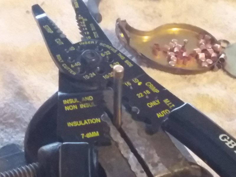

Cypress Sam, SASS #10915 Posted December 25, 2020 Posted December 25, 2020 Is there any reason that #11 caps couldn’t be swaged down to #10 size?

Warden Callaway Posted December 25, 2020 Posted December 25, 2020 46 minutes ago, Cypress Sam, SASS #10915 said: Is there any reason that #11 caps couldn’t be swaged down to #10 size? It works. I used a drill bit that measured .154. Drilled the wire tool out. Pinch cap and turn 90 and pinched again to remove slight ridge formed from first pinch. They run through the Ted Cash capper fine. Fit tightly on Pietta nipples. Shot maybe a 100 without issues.
