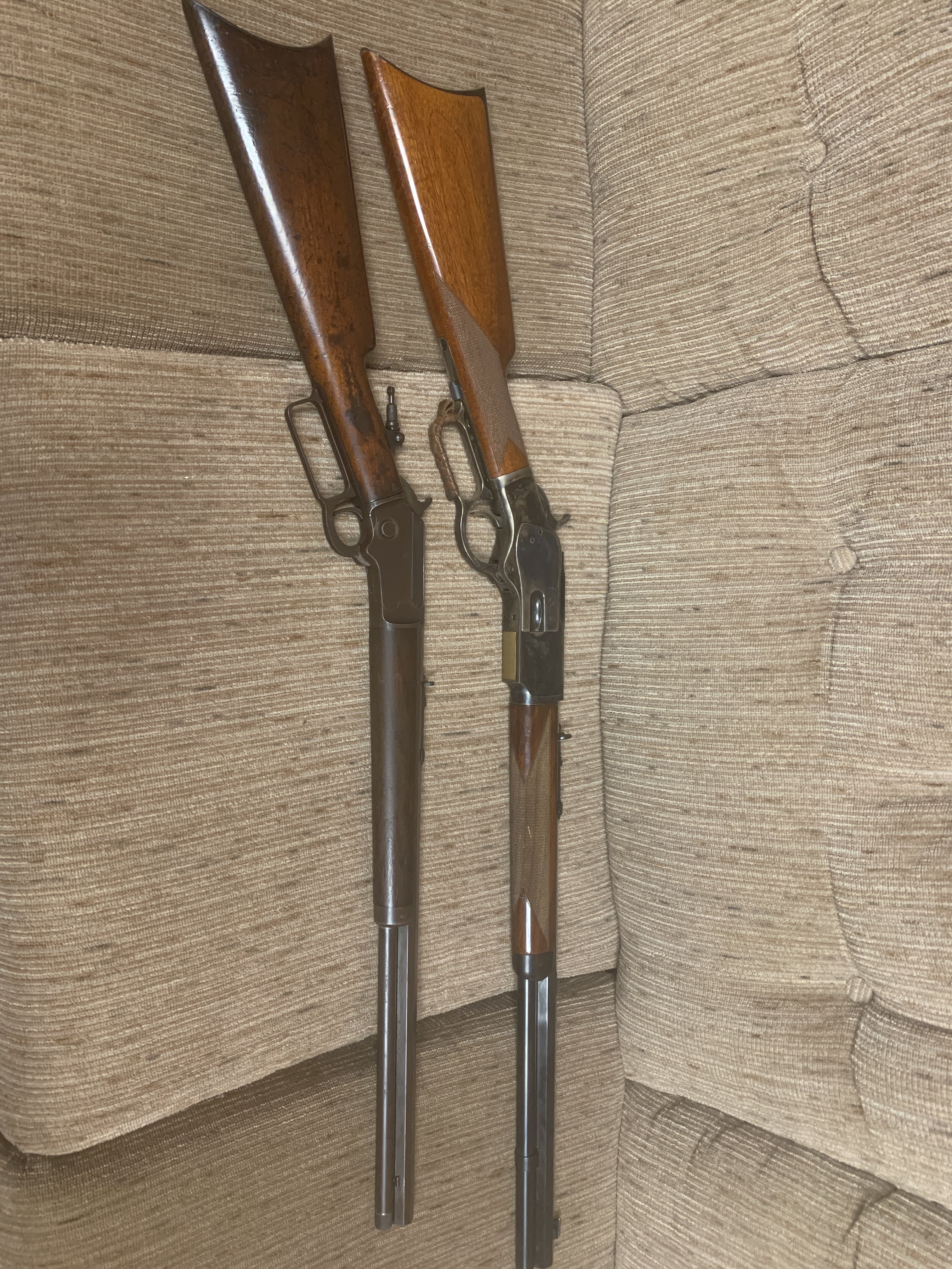

I have a 1873 converted to 32 S&W Long - think of it as the same setup as either the Navy Arms 73 in .22 or the 45 Cowboy/ACP conversions, you take the same gun/frame, easier if starting with a 32-20 gun, setback and rechamber to 32 S&W and add a carrier that stops the shorter cartridge from coming all the way back, relieve bolt to pass the cartridge stop. It has the barrel turned down and shorted to 17" and is still the same weight as a 38cal 1873 carbine.
Also have an 1892 Marlin converted to 32 SW Long, some basic gunsmithing required, chamber cutting, right firing pin, spacer on the lifter to adjust cartridge length etc.. Barrel cut to 19" which requires reworking the magazine, but this length allows 10 rounds with a little room to spare.
Since you can load both 32 and 38 down to 60PF, recoil is going to be primarily a function of the gun weight, 100gr is my bullet for both.
Gave each to my soon to be Young gun to test and she prefers the Marlin, If I was dead set on a 32 cal lightest rifle and not paying ~2K for 1 of the 600 1894's,  the Marlin 92 would be the route I would go, but it would take two steps, buying the rifle and getting it converted.

You need someone who is able to rechamber = lathe, since the original 32 cartridge was slightly smaller that the 32 SW you are just reaming the camber , all of the original threading, extractor cuts, ect.. remain
If you want to shorten from the original barrel length, dovetails need recut for the mag tube and the front sight = milling machine
Need to understand how cartridge length is used to control feeding in combination with the lifter.
New firing pins are available via http://www.wisnersinc.com/ that is the only difference in the originals between centerfire and rimfire.
Here is the one i just did, the donor rifle was $460 to my door (C&R) off Gunbroker last month. Placed my 20" barreled  1873 main match gun next to it for scale.
I am blessed to be able to do my own work.
