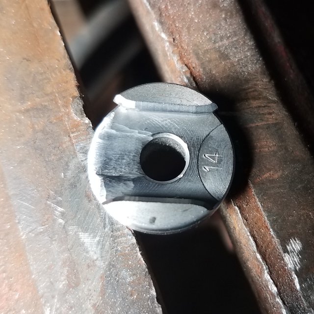

Sedalia Dave Posted February 29, 2020 Posted February 29, 2020 The APP X-press shell holders use the same numbering scheme as their other shell holders The Lee part number is just different. There is an error in some Lee charts. They list 45 Colt as a #14 when it should be a #11 38-40, 44-40 and 45 Schofield use a #14. Lee APP X-press shell holder chart

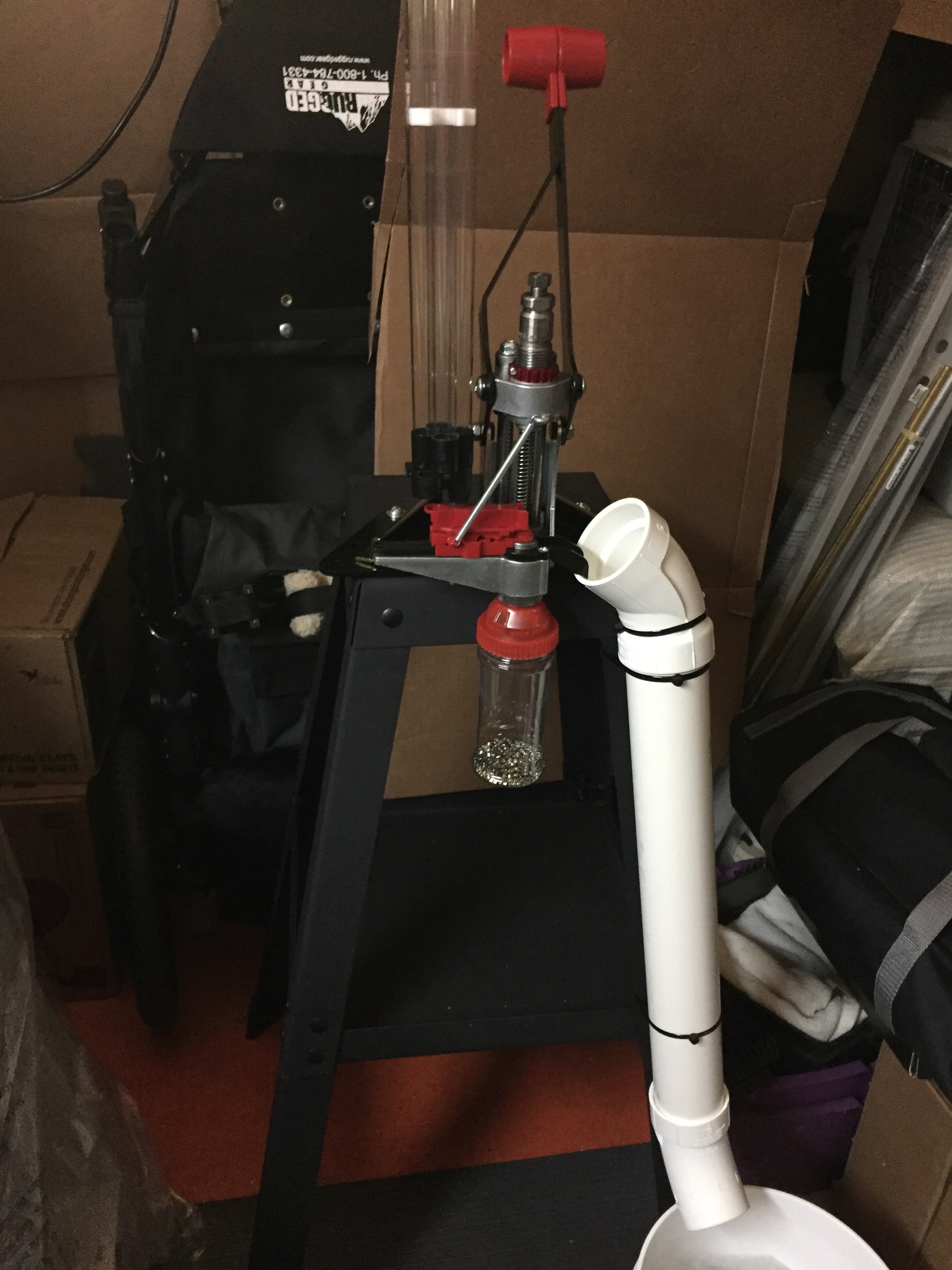

cajun bandit Posted April 4, 2020 Posted April 4, 2020 got one for depriming .38 brass and works like a charm.installed a small funnel on top of the loading tube,fast loading of tube. will later install a 4 tube loading system
Warden Callaway Posted April 4, 2020 Author Posted April 4, 2020 7 minutes ago, cajun bandit said: got one for depriming .38 brass and works like a charm.installed a small funnel on top of the loading tube,fast loading of tube. will later install a 4 tube loading system I just skipped the tube all together. Pull, drop, pull, drop. Works right right along. But the 4 tube with collector would probably be faster yet.

Sedalia Dave Posted April 4, 2020 Posted April 4, 2020 I have noticed that some of the Lee shell holder tables incorrectly list a #11 shell holder for 44 WCF / 44-40. A #11 is for 45 Colt. 44 WCF / 44-40 requires a #14 shell holder.

cajun bandit Posted April 7, 2020 Posted April 7, 2020 On 1/28/2020 at 2:43 PM, Warden Callaway said: I thought I seen a video of one with a 4 tube feeder attached but I've not found it back. Couldn't you use the collector on one tube and just plug the other 3 holes? a small funnel works just fine

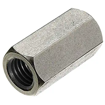

Sedalia Dave Posted April 22, 2020 Posted April 22, 2020 One thing to make adjusting the case/bullet feeder easier is to replace the bottom nut with a 1/4-20 coupling nut. The longer body makes it much easier to turn with your fingers and get a wrench on to tighten. Picked one up at the local hardware store.

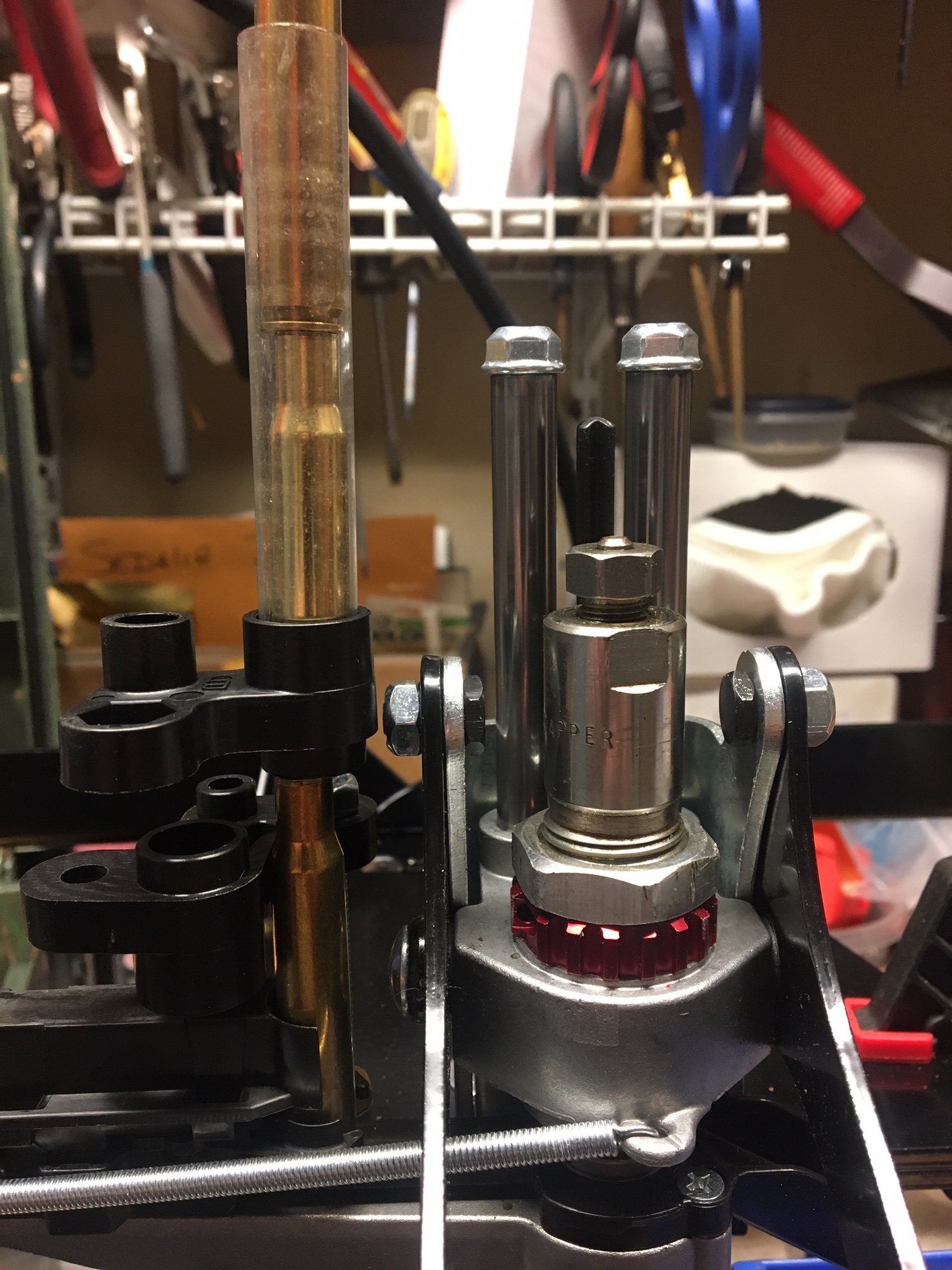

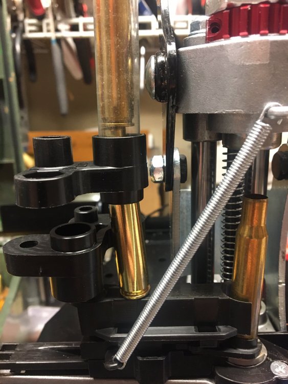

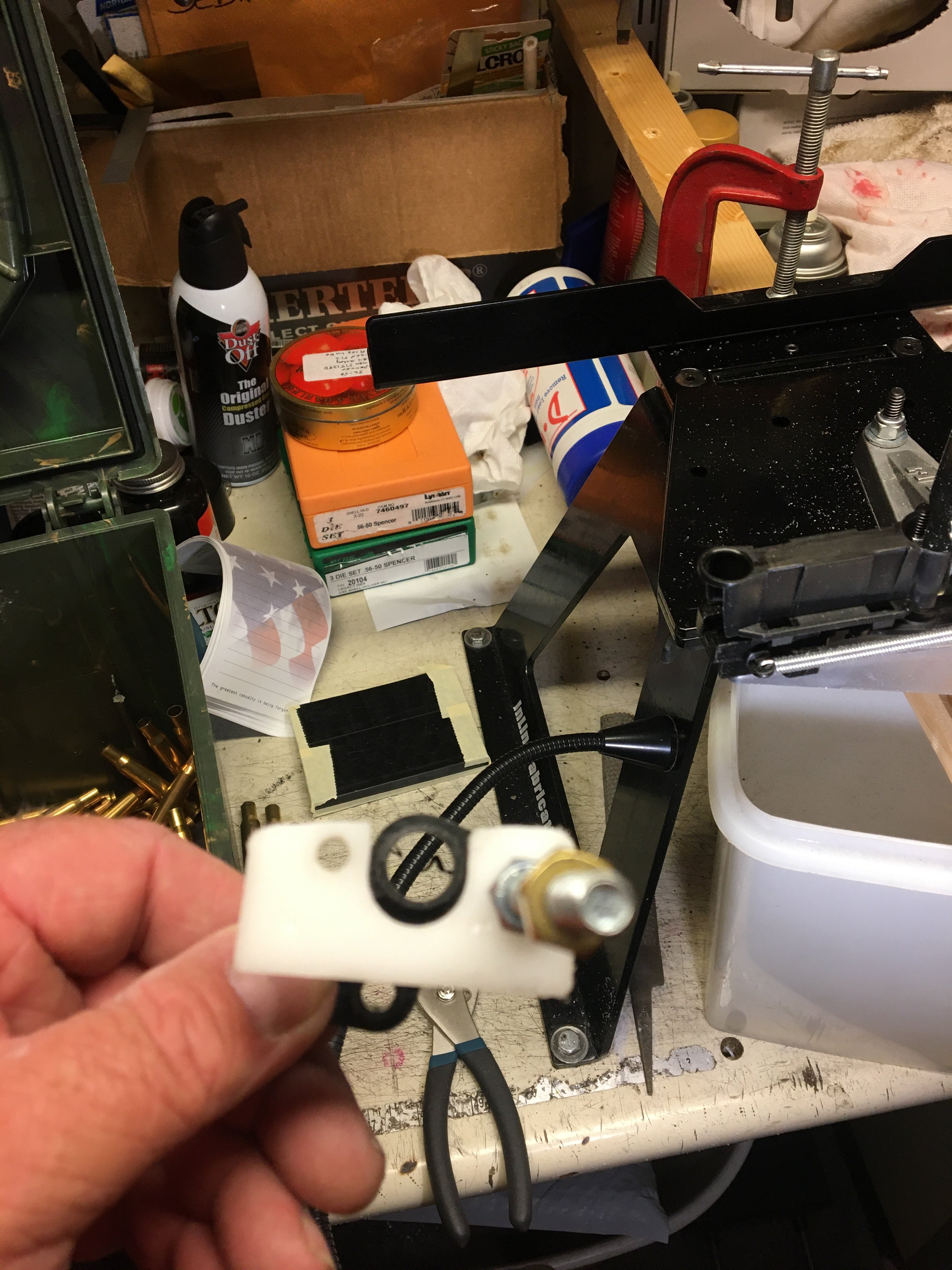

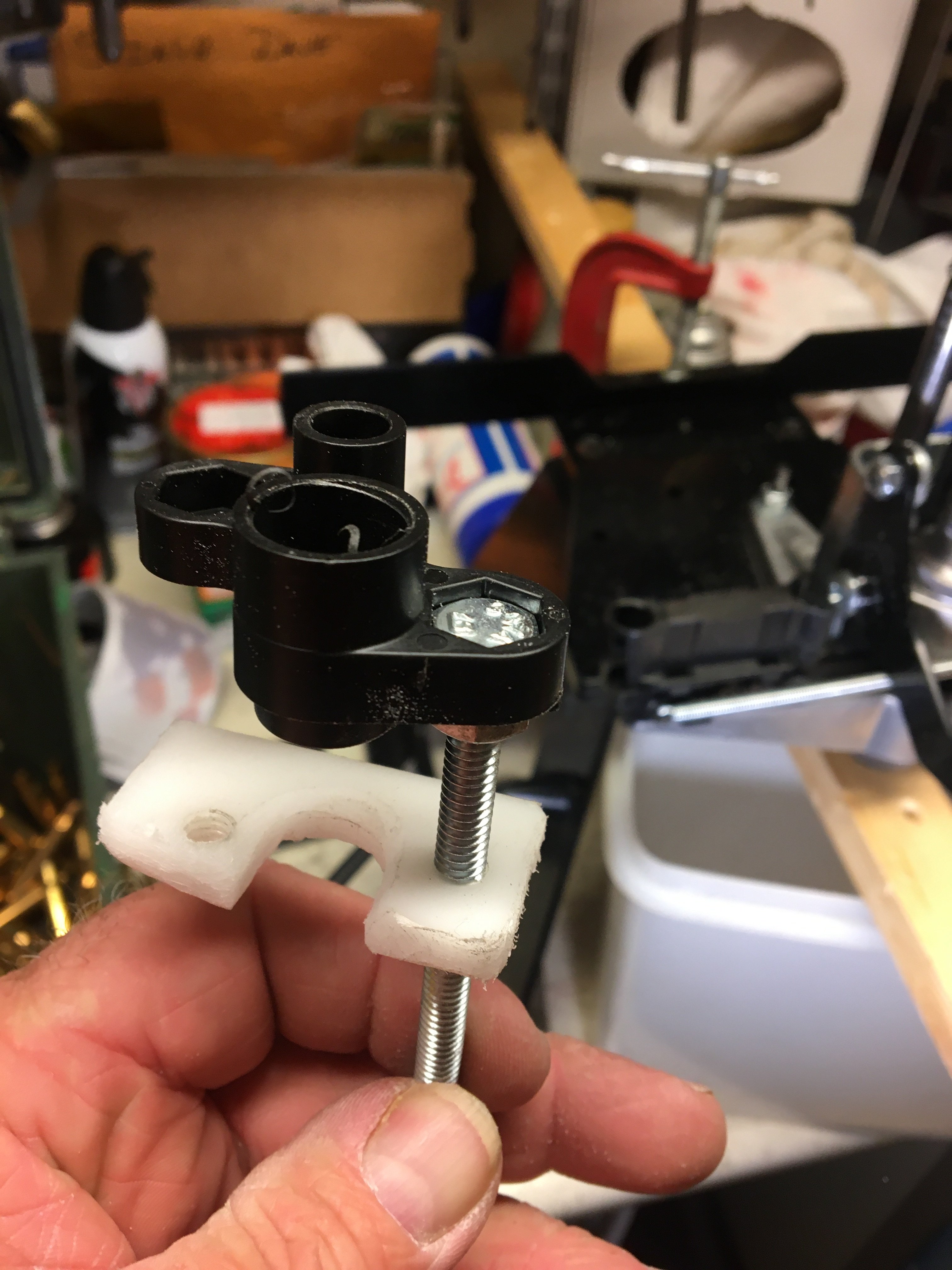

Sedalia Dave Posted May 17, 2020 Posted May 17, 2020 Earlier I posted about how cases that are significantly taller than the case feeder tend to become cocked as the press is operated. Well today I tried my had a a videoing the problem and how I went about fixing it. The guide is made from a piece if High Density PolyEthylene (HDPE) plastic. It was scrap lying around so it could have been nylon, delrin or another HDPE plastic. It is mounted on the same bolt as the feed tube holder. I opted to drill and tap the mounting hole (1/4-20) so that I would only need 1 nut to hold it in place. Once I had the mounting hole done, I covered it with a piece of masking tape so I could lay out the rest of the piece. For the U shaped slot that guides the case, I removed most of the material with a stepped drill bit and then cleaned it up with a coarse sanding drum in my dremil. Cut the basic shape with a hacksaw and then smoothed up the cuts with the sanding drum. I made the funnel to make feeding cases easier from a short section of the tube that came with the press and part of the neck from a long funnel I picked up at Oreillys for less than $2. Here is my first attempts are posting an instructional video. I'll probably make one continuous video to replace them later. Repositioned the camera for the third video. With it out of the way I could operate the press like it should.
