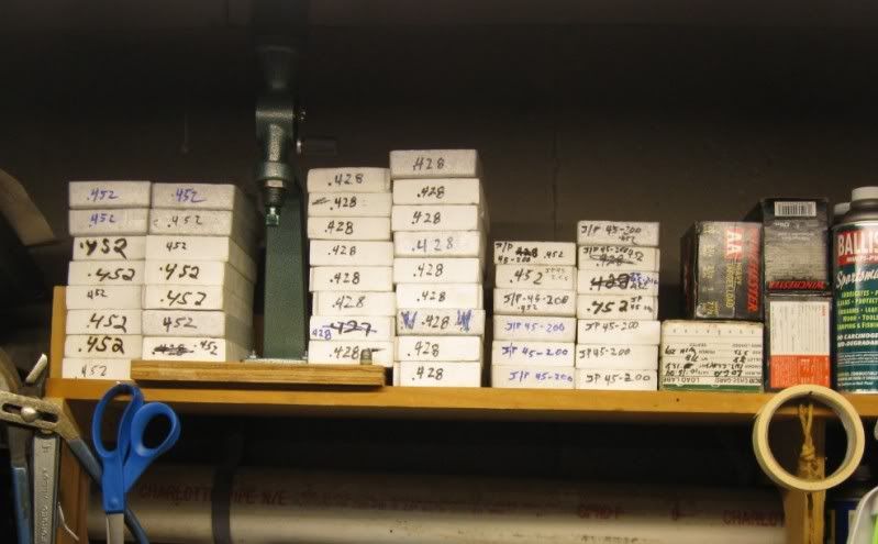

Driftwood Johnson, SASS #38283 Posted March 17, 2011 Posted March 17, 2011 Howdy I size Big Lube bullets with mine. The Big Lube lube grooves eat up a whole lot of lube. I never stopped to count, but I probably get somewhere around 20 or so bullets for every couple of turns on the handle with mine. Never even considered the auto-feed stuff, the Star is so much better than my old RCBS Lubesizer. I can run tons of bullets through my Star in much less time than with the RCBS, even without the fancy compressed air dohickey. Star Now all I have to do is stuff these all into cartridges. bullets waiting to be loaded
