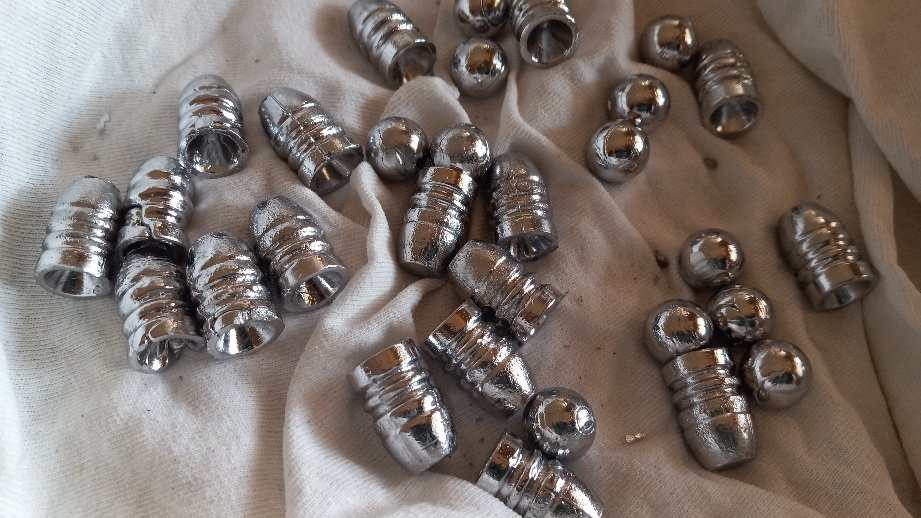

Warden Callaway Posted January 1, 2025 Posted January 1, 2025 I got the use of a Rapine hollow base 45 255g mold. Once I got the pot up to temperature and flowing pretty good and the mold heated up, they started to come out better. I quit about the time it was working good. I'm more into Lee 6 cavity molds. I cast two shots of Lee 457 round ball 6 hole mold. The single cavity mold that had to be turned upside down was painfully slow. I may try a few in my Ruger Old Army.
Three Foot Johnson Posted January 1, 2025 Posted January 1, 2025 I've found hollow base molds to be notoriously difficult to cast good bullets. When casting 500 grain Minie's from a single cavity Lyman for my 1861 Springfield repro, it's normal to reject one out of three, and often two out of three. Shooting one at a time, a handful will last you all day though, so...

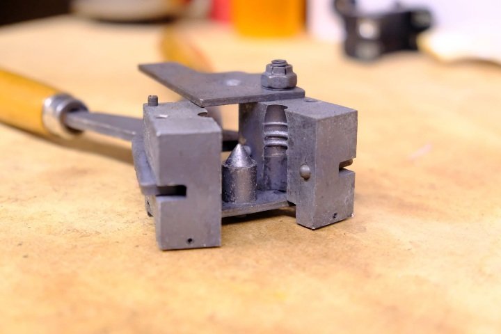

Warden Callaway Posted January 2, 2025 Author Posted January 2, 2025 It was too cold. That's why I stopped early. Here's what the Rapine mold looks like. It has a built-in bottom pug. Worked as well as I expected.
