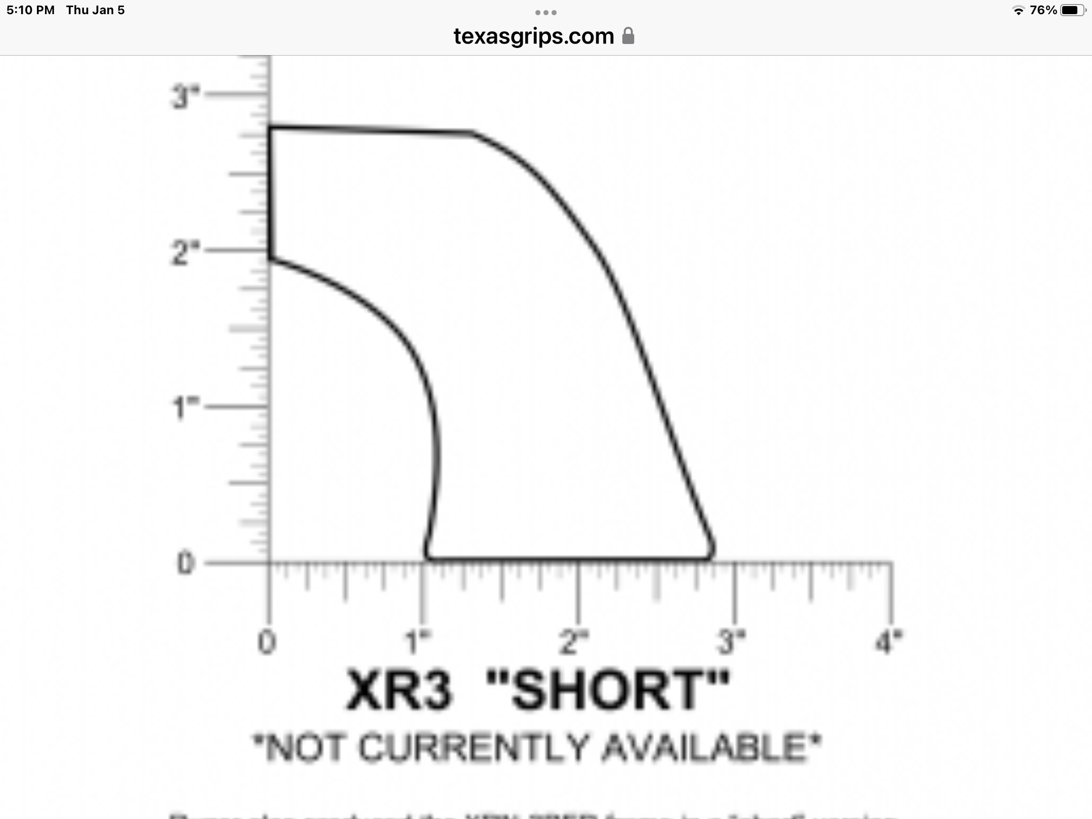

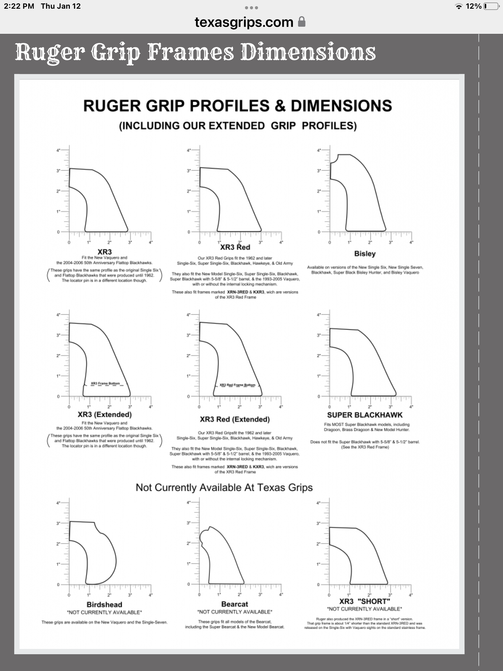

Scarlett Posted July 27, 2023 Posted July 27, 2023 When we bought a Single Six off of GB (part of a pair that is at Jimmy Spurs now) we used this diagram so the seller could verify the frame size. I wanted small frame. Hugs! Scarlett
Captain Bill Burt Posted July 27, 2023 Author Posted July 27, 2023 8 minutes ago, Scarlett said: When we bought a Single Six off of GB (part of a pair that is at Jimmy Spurs now) we used this diagram so the seller could verify the frame size. I wanted small frame. Hugs! Scarlett That’s helpful. Thank you Scarlett.
