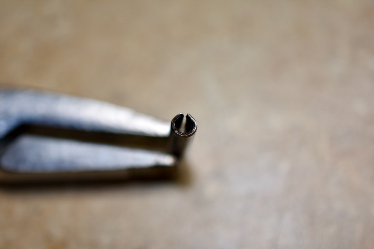

Garrison Joe, SASS #60708 Posted April 30, 2022 Posted April 30, 2022 A roll pin is never solid. It's always a rolled piece of springy sheet stock. You can see the hole in each end of the pin (unless it has been severely mangled). It's the springy nature of the pin trying to expand in diameter which helps retain it in it's hole without some other locking mechanism - like peening base metal over the end of the pin, staking, interference fit, riveting the end, adding a second cross pin to hold the pin, etc). Best to use roll pin punch that best fits the roll pin you are working on. Using a solid punch can (under severe circumstances) smash the wall of the roll pin and perhaps lock it in place. If you have a solid pin and can't see which end was driven in with a punch, then usually it's been placed in a regular drilled (straight wall) hole, and thus can be tapped out in either direction. If you do see some punch marks, first attempt ought to be to drive it out from the unmarked end. In one way, out by backing the pin out (the other way) A "directional" solid pin is very unusual, in my experience. Just because it's expensive to make either a tapered hole or a tapered pin. good luck, GJ

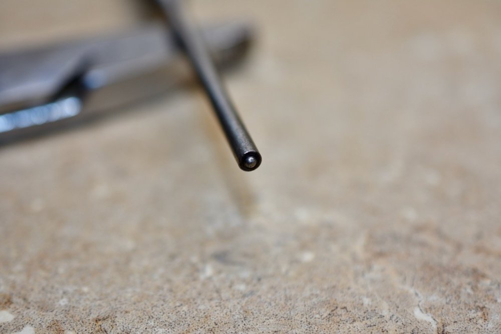

Larsen E. Pettifogger, SASS #32933 Posted April 30, 2022 Posted April 30, 2022 As noted by definition a "roll" is not solid. In the U.S. they are rolled out of a single layer of steel and have a gap running down the length of the pin. In Europe they are often rolled and have multiple layers with no gap. A roll pin punch has a dimple on the tip to center the punch on the pin.
Griff Posted April 30, 2022 Posted April 30, 2022 I would call that convex area on the drive end on a roll pin punch a button. Dimple would imply it's concave... But that is really pickin' nits!

J.D. Daily Posted May 9, 2022 Posted May 9, 2022 On 4/30/2022 at 3:24 PM, Larsen E. Pettifogger, SASS #32933 said: As noted by definition a "roll" is not solid. In the U.S. they are rolled out of a single layer of steel and have a gap running down the length of the pin. In Europe they are often rolled and have multiple layers with no gap. A roll pin punch has a dimple on the tip to center the punch on the pin. There are roll pin starter punches that take a lot of frustration out of installing roll pins. They are almost a necessity when building AR's.
