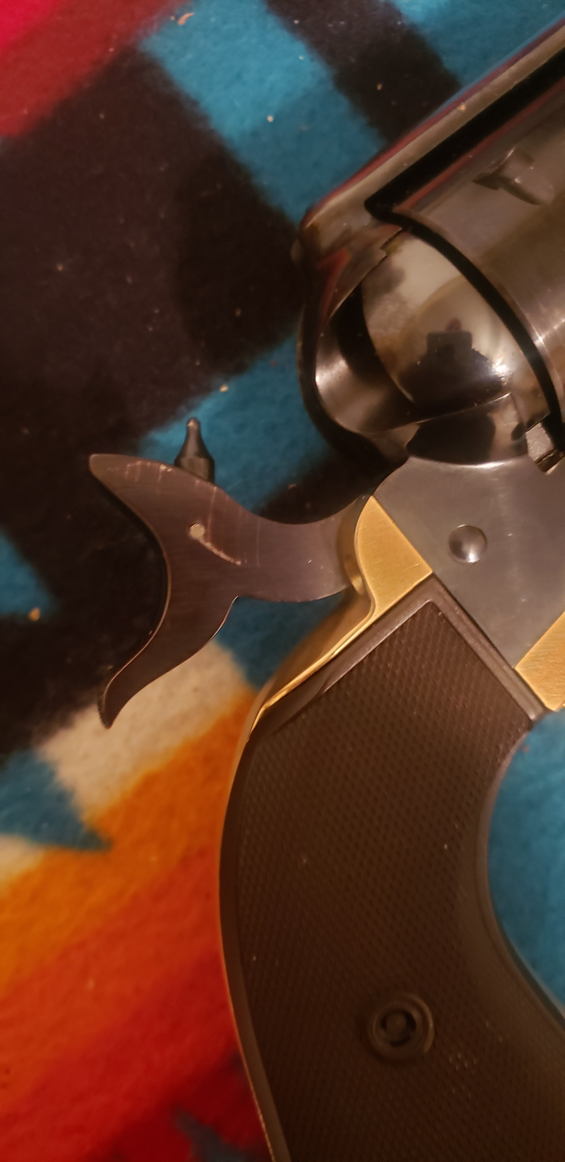

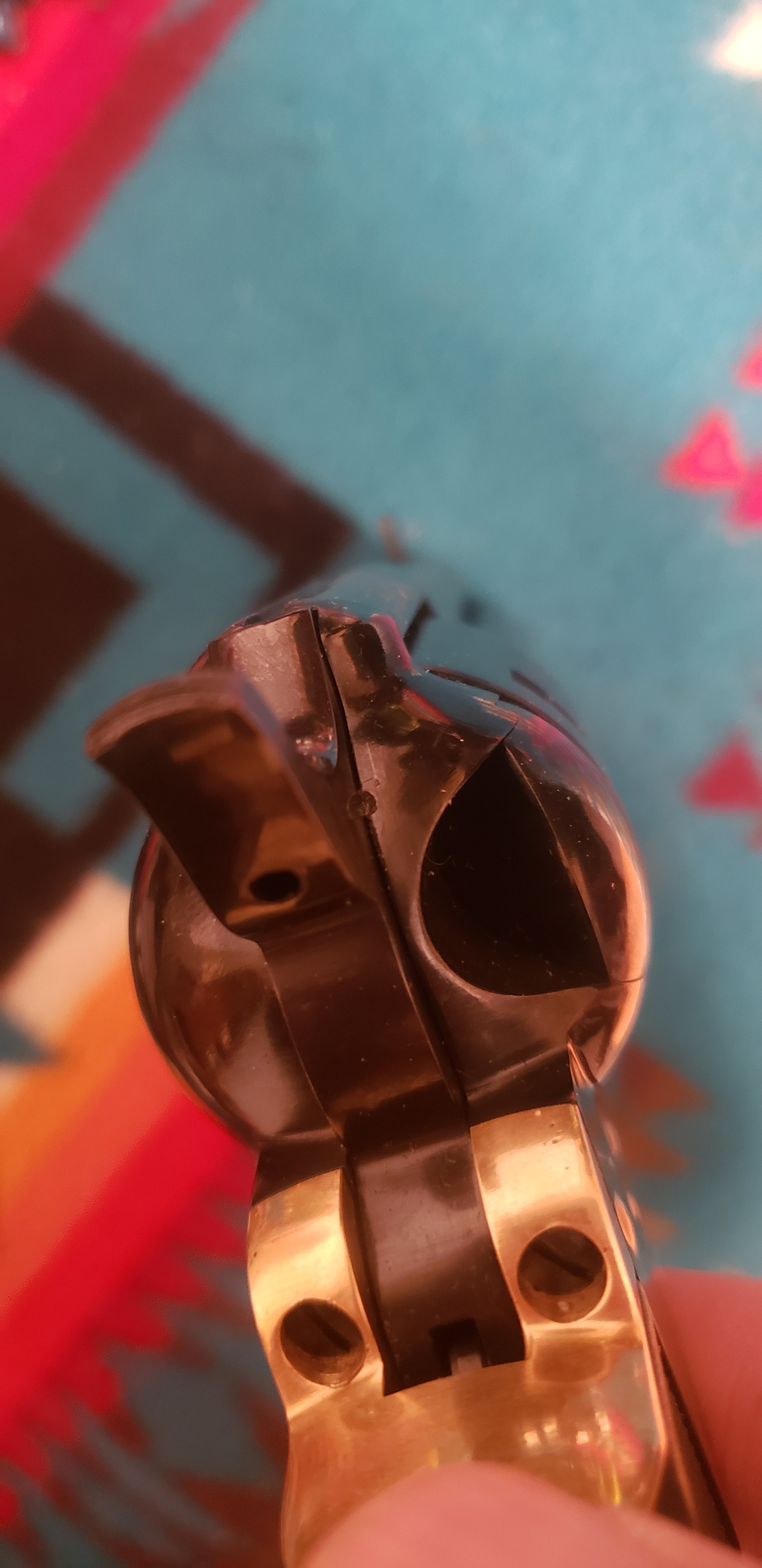

I have a fairly new Davidson's Pietta 45. Range once, lots of dry fire then...the hammer will not fall all the way!  I notice the pin that holds the firing pin in has worked its way loose and is hitting the side of the frame. Actually left a devit in the frame. I push it back in with some blues locktite. Came loose again.  I am considering placing a small bend in it but it is really short so that might be difficult.
How is this supposed to be fixed? It has been dry fired a lot but only about 12 45acp rounds fired!  (I have the 45 colt cylinder but no bullets)  This is my 1st non-Ruger and I am quite unimpressed. I would trade it in a heart beat!  Look at the pics and I appreciate any advice. 20220226_182338.thumb.jpg.209fe43891c7c99eb2f0e2802ea13040.jpg
Had the same problem with mine. The pins also wear thinner and get too long. Kept having to grind the ends down. I eventually made new stronger pins. I usually smash one end of the pin so it stays. Also, we had to start putting a piece of leather in for dry firing because we would get a bulge around where the firing pin comes out on the inside.
Never dry fire a colt style SAA action without quality snap caps. The firing pins are designed to float to help align them with the hole in the frame. If the FP doesn't have a primer to hit it slams forward and eventually bends/loosens the retaining pin. Plus, the Pietta has a recoil shield mounted firing pin bushing that can be loosened and lost.

Your problem is not one of Pietta's making.  It's your own fault.  You can fix this gun by replacing the pin, then laying the assembled hammer on a flat STEEL surface then use as taper punch to expand the ends of the pin.
PS:  The new replacement pin may be long enough to allow you to simply to peen the ends.

I have a Smoke Wagon, and I noticed that the pin on mine was proud on the right side as well. The pin has a slight taper and took a fair bit of force to get it in a bit more. Just another item to check occasionally or when inspecting a new purchase.

Thanks for the input. I will try those fixes. I will also stop dry fire unless I have an empty in the cylinders.
