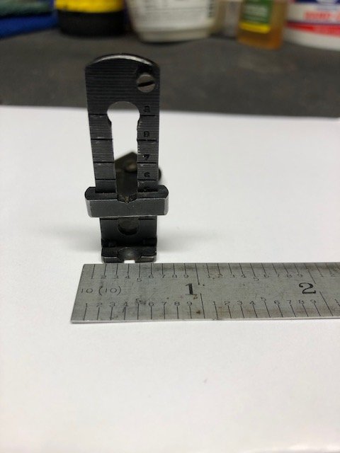

WOODFOX , sass#34179 Posted July 8, 2021 Posted July 8, 2021 A picture of your old sight might help . I might have one . This is what I have . Woodfox
