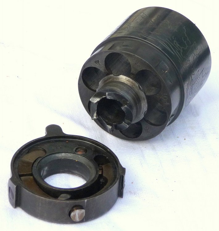

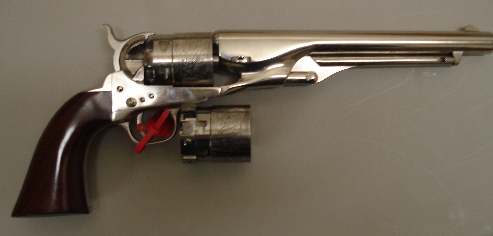

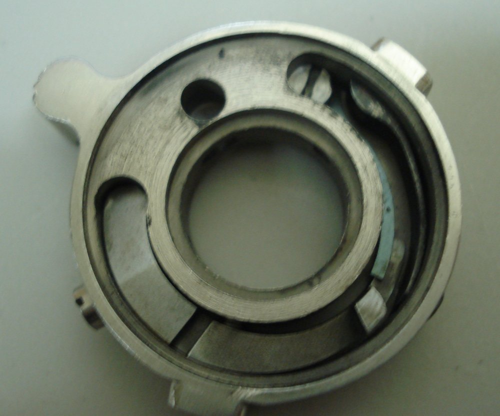

Abilene, SASS # 27489 Posted February 26, 2021 Posted February 26, 2021 Rye Miles posted a topic about the new Guns of the Old West magazine and how they featured the Thuer conversion. Then Sedalia Dave posted a Lost Guns episode on an 1849 Colt with the Thuer conversion. If you are not familiar with the Thuer then you should watch that video. I'll post that again at the end of this post. About 20 years ago Uberti made a handful of Thuers, very few actually. Well, Cimarron has one of them. For a time there was a consideration for Uberti to put it into production, but it never happened. Too niche, I guess. But Cimarron took the Thuer to a couple of Shot Shows. They didn't have it on display, but I showed it to a couple people. I also was able to take some pics of the parts for those who might be interested. The ring is rotated to the Fire position to shoot the rimless tapered cartridges. Then it is rotated to the Eject position to eject them one at a time out the right side. The right side of the barrel underlug area has been relieved to provide clearance for the loading and ejection of the cartridges. You can see that in the pics. The Uberti gun had 6 pieces of brass and a loading tool. I was able to insert the brass into the cylinder and then eject it by dropping the hammer and shooting the brass out the side. Kind of neat, actually. The '49 Thuer in the video has a ring that is different and has a spring loaded feature on the rotating ring that is not on the '60. I am assuming that the Uberti version is true to the Colt design. I can't imagine going to that much trouble to machine all those parts and then change it. In the video Ian says the second position on the conversion ring is like a snap cap and is for resting the hammer on a fully loaded cylinder. That may be, but it still must have a way to eject the brass, but he didn't mention that. The Uberti Thuer looks like it could be put halfway between F and E and it would then the hammer would be down on an empty hole to make it safe for carrying six. I didn't really check that out back then. BTW, there's a 'smith that markets a Kirst cylinder with a rotating ring that he calls a Thuer. It looks like a Thuer but bears little other resemblance since it is a regular breech loading cylinder. I think when rotated it makes it safe to carry six. So for those interested, here's the Uberti:

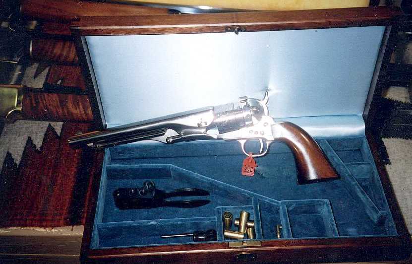

Sedalia Dave Posted February 26, 2021 Posted February 26, 2021 At the 3:45 mark Ian states that the Thure conversion needed a set of tool to seat loaded rounds and remove spent cartridges. Here is a picture of an actual Thuer cartridge Couldn't find a pic of the cylinder loading and unloading tools.
Ramblin Gambler Posted February 26, 2021 Posted February 26, 2021 Were the tools to reload the brass, or to jam the cartridge into the cylinder? Seems like it would only take 1 tool to jam a cartridge into the cylinder. I need a video of someone shooting one of those things.

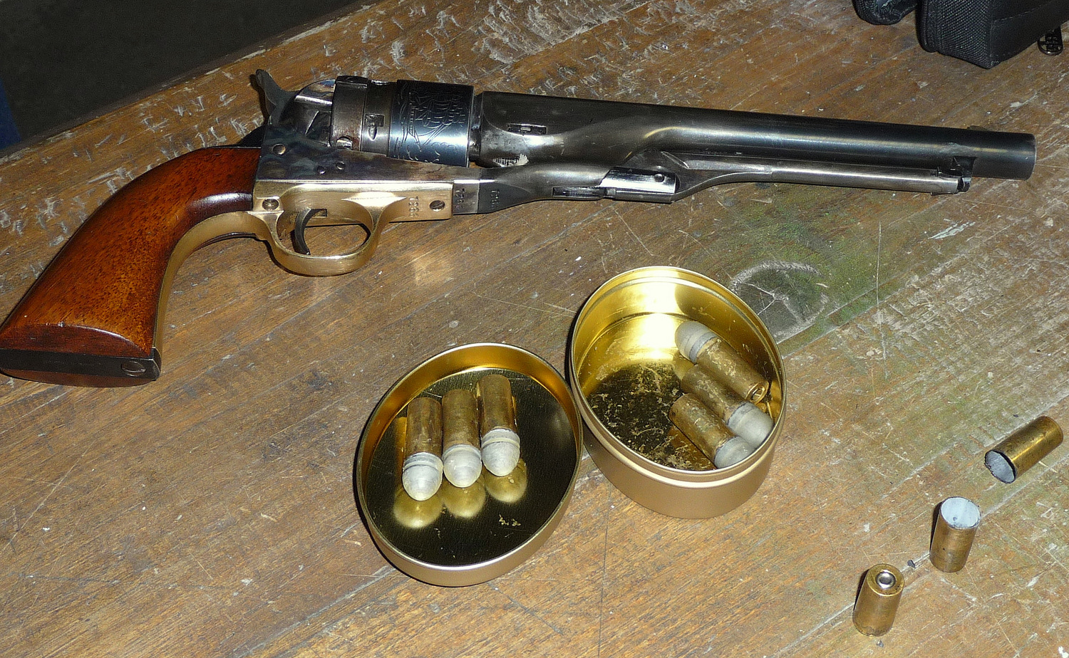

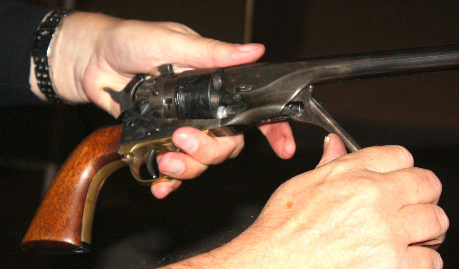

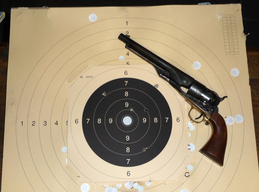

Long Johns Wolf Posted February 26, 2021 Posted February 26, 2021 A few pics loading a Centaure 1960 New Model Army Thuer and shooting a Uberti Colt 1860 Army Thuer (sorry, no video). Long Johns Wolf

Ramblin Gambler Posted February 27, 2021 Posted February 27, 2021 On 2/26/2021 at 9:48 AM, Long Johns Wolf said: A few pics loading a Centaure 1960 New Model Army Thuer and shooting a Uberti Colt 1860 Army Thuer (sorry, no video). Long Johns Wolf That's cool, thanks. So you can confirm that the cartridge is held in with friction? I'm guessing you used the loading lever for that and not the tools mentioned. Did you have any problems with them coming forward under recoil?
Long Johns Wolf Posted February 28, 2021 Posted February 28, 2021 Yes, the case of the cartridge is held by friction. You load the conical contoured cartridge like you load a paper cartridge using the loading lever. A few more pics incl. targets engaged with the Centaure (3-screw frame) and the Uberti (4-screw frame). Long Johns Wolf

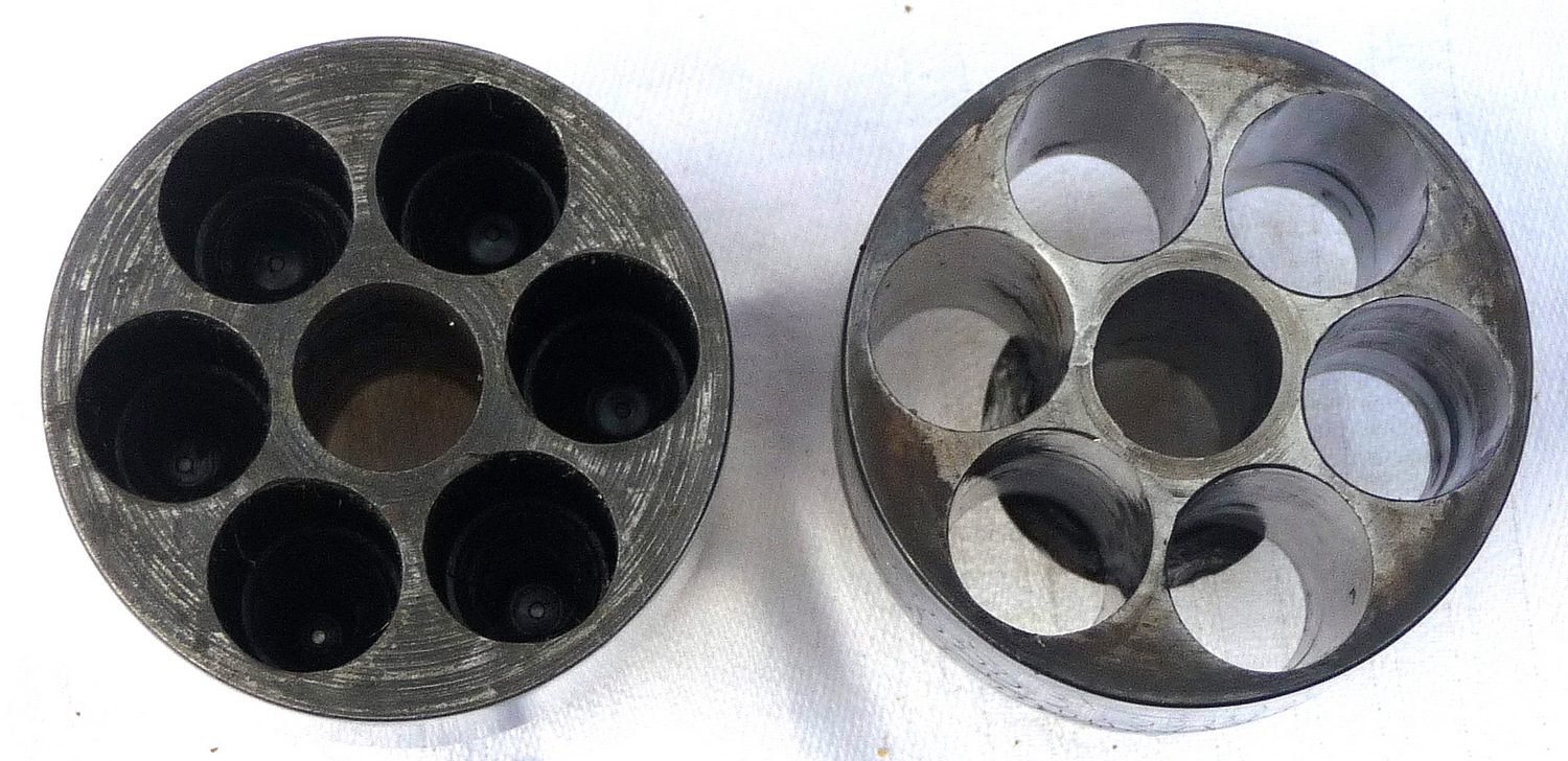

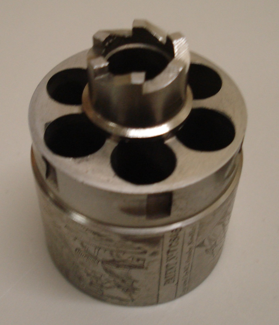

Long Johns Wolf Posted February 28, 2021 Posted February 28, 2021 Incidentally, the conical Thuer cases were made from .44 Mag empties. Some (comparative) views of the C&B and the Thuer cylinder of the Centaure Long Johns Wolf
