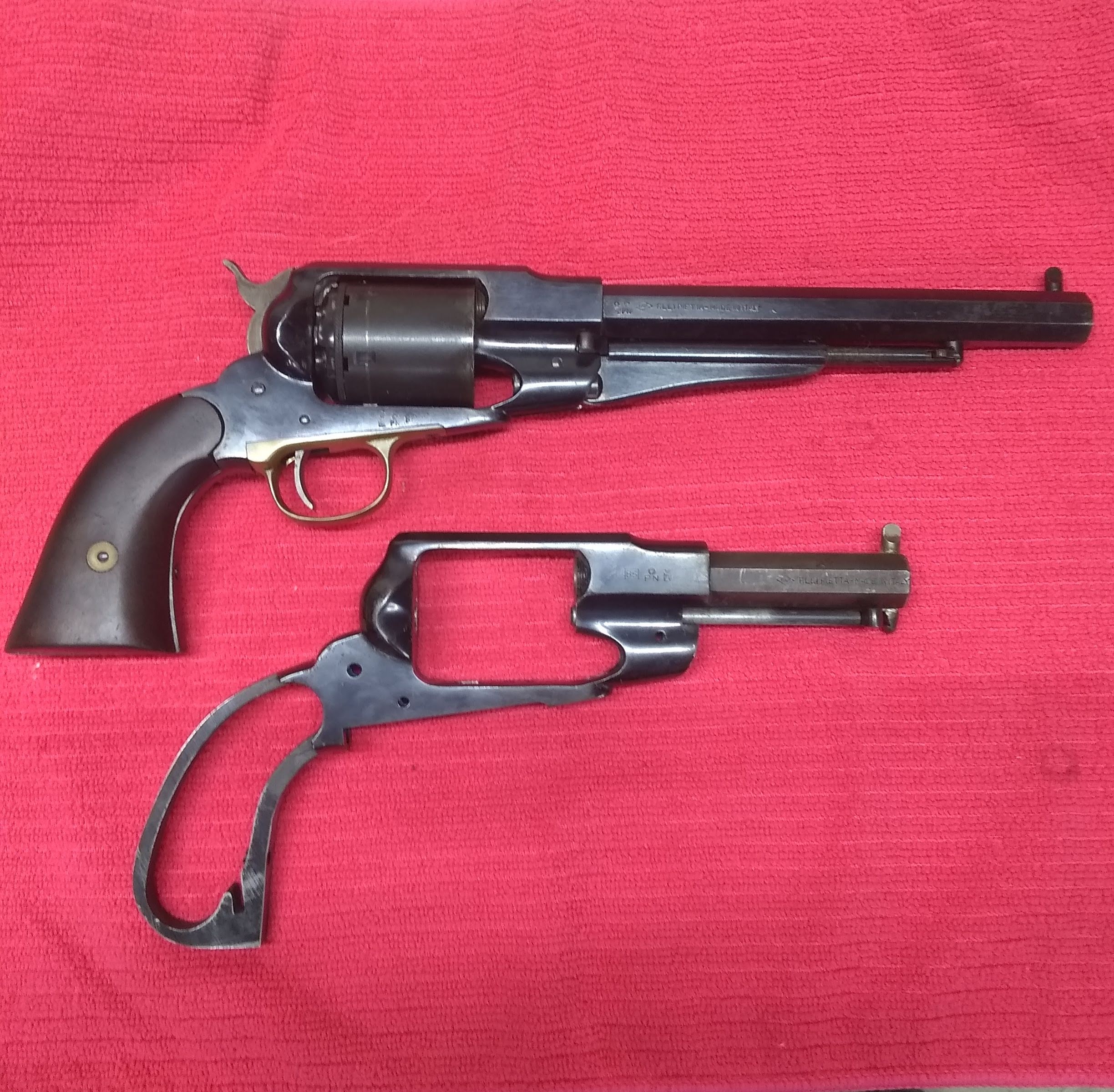

Turkey Flats Jack 613 Posted January 20 Share Posted January 20 I still havent gotten around to finishing it yet. Heres a couple of in progress shots. 4" barrel and sort of a birdshead grip frame. I still want to lower the hammer and then make the grips. 2 Quote Link to post Share on other sites
El CupAJoe 192 Posted January 20 Author Share Posted January 20 Very Nice! 1 Quote Link to post Share on other sites

Silver Sam, SASS #34718L 547 Posted January 20 Share Posted January 20 Personally I dont like the feel of Birdshead Grips..... They are good for concealment but not for shooting fast, they tend to roll up in my hands. On mine I shortened the Barrels to 4 3/4", lowered the Hammers and thinned the profile of the Grips a Bunch! They work real well for Me...... It's all personal preference. 1 1 Quote Link to post Share on other sites
El CupAJoe 192 Posted January 20 Author Share Posted January 20 6 minutes ago, Silver Sam, SASS #34718L said: Personally I dont like the feel of Birdshead Grips..... They are good for concealment but not for shooting fast, they tend to roll up in my hands. On mine I shortened the Barrels to 4 3/4", lowered the Hammers and thinned the profile of the Grips a Bunch! They work real well for Me...... It's all personal preference. do these point better for you? Also, do you have an unmodified grip you could take an overlapping pic so I can see how much material was removed? Lastly, did you use a set screw to hold the cylinder pin in place? Quote Link to post Share on other sites
doc roy l. pain 489 Posted January 20 Share Posted January 20 1 hour ago, Silver Sam, SASS #34718L said: Personally I dont like the feel of Birdshead Grips..... They are good for concealment but not for shooting fast, they tend to roll up in my hands. On mine I shortened the Barrels to 4 3/4", lowered the Hammers and thinned the profile of the Grips a Bunch! They work real well for Me...... It's all personal preference. Those are beauties!! Quote Link to post Share on other sites
