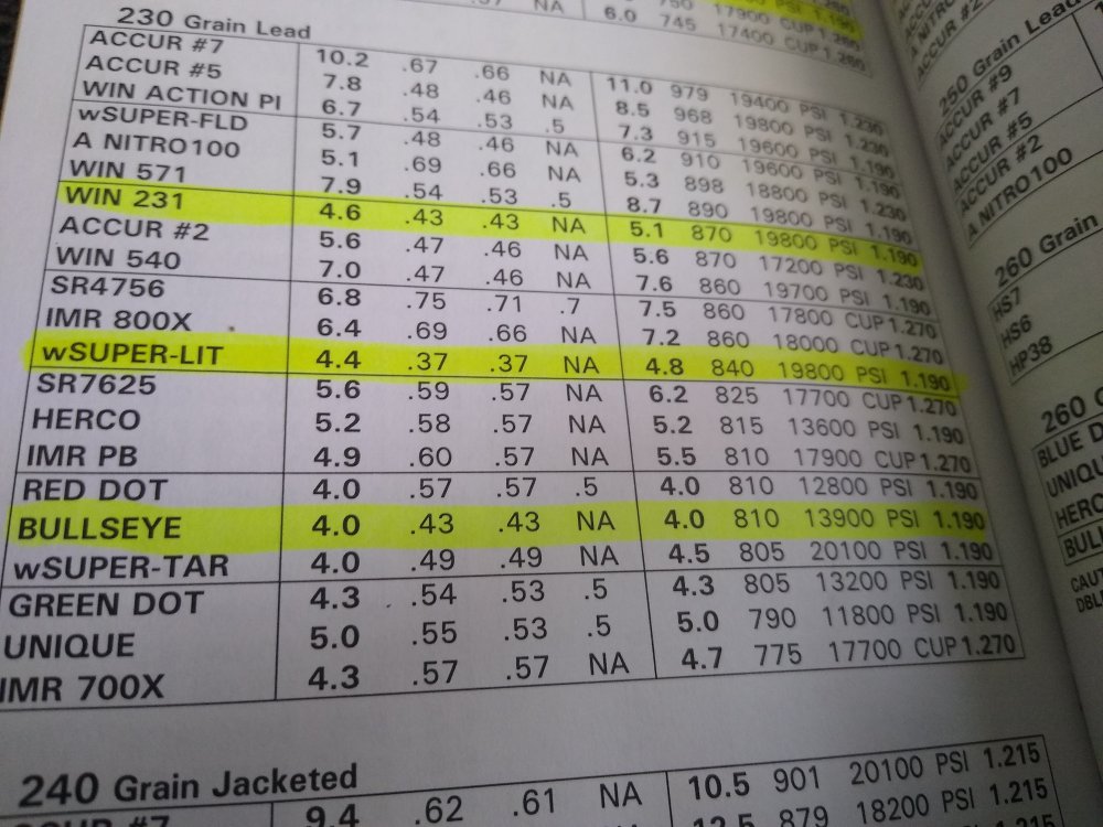

Go West Posted September 10, 2020 Posted September 10, 2020 I have used Bullseye, American Select, 231 and WSL. I also have Clays, but need to burn through others before I try that. Attached is a page from the older Lee manual.
