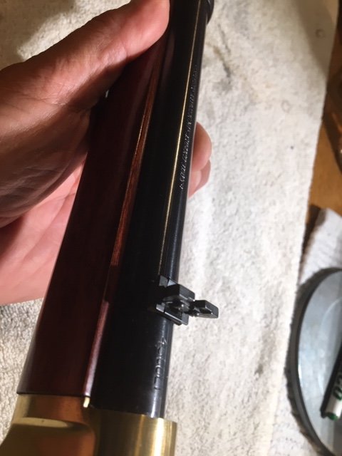

Gringo Starr Posted August 17, 2019 Posted August 17, 2019 I recently bought a Uberti 1866 Carbine in .45LC and when I went to replace the the rear sight I found that the dovetail isn’t a standard 3/8in (.375) slot. It appears to be .340. I’ve looked at Marbles and others and so far haven’t found anything that will fit the .340 dovetail. Any suggestions?
Rafe Conager SASS #56958 Posted August 17, 2019 Posted August 17, 2019 Try this one it fit my 66 https://www.trackofthewolf.com/Categories/PartDetail.aspx/882/1/RS-PM-1 Rafe
Gringo Starr Posted August 17, 2019 Author Posted August 17, 2019 Thanks Rafe I got a suggestion from Joe at PGW to file a standard site down with a triangle file to fit the smaller dovetail. I have fold down site from a 10/22 so I’m going to give it a shot. I’ll let you know how it turns out.
Captain Clark Posted August 17, 2019 Posted August 17, 2019 10/22 flip up sight has worked well on mine for near 10 years!
Gringo Starr Posted August 17, 2019 Author Posted August 17, 2019 Well I tried the triangle file on the 10/22 sight and it worked. Took a while to get that much material off. I was checking it with a caliper every 10-12 strokes to make sure I didn’t go too far. Kind of one of those deals where one stroke of the file could take it over the edge. Painted the raw metal with some matte black paint. Thanks for the input fellas.
