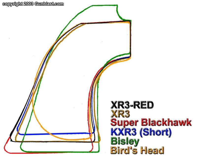

GUNBARREL, #20505 Posted April 18, 2019 Posted April 18, 2019 Howdy. I had a pair of the old style Ruger Vaqueros with Sanbar stag grips that I shot comfortably for years. I got rid of them about 5 years ago, but recently I picked up a new style Vaquero. Both models in .45 Colt. As expected, the grip feels different, with my little finger protruding past the bottom of the grip, which allows the revolver to roll back when I shoot it. This is not a problem, but the rear of the trigger guard hits my middle finger when I shoot it. Would thicker, or thinner grips help this situation? Thanks in advance for your comments and opinions.
Garrison Joe, SASS #60708 Posted April 18, 2019 Posted April 18, 2019 Thinner grips often give a shooter better control. Lighter loads would be what I'd try, though, as they will much more likely give you a solution to knuckle rapping. The Cowboy 45 Special case is ideal for making a light load that runs fine in .45 Colt chambered revolvers. Good luck, GJ

Driftwood Johnson, SASS #38283 Posted April 19, 2019 Posted April 19, 2019 Howdy I discovered a long time ago that if I leave about 1/4" of space between the rear of the trigger guard and the knuckle of my middle finger, I will not get my knuckle whacked in recoil. You are already part way there if you are curling your pinky under the grip. Doing so shifts your grip down enough that the gap opens up between the trigger guard and your knuckle. This is the way I shoot my Colts, and they are basically the same size and weight as a New Vaquero. Examine your grip technique and see if you can open up the gap. Do not leave your knuckle in contact with the trigger guard, that will hurt. Grasp the gun firmly, but not with a death grip. Allow the recoil to raise your forearm up to absorb the recoil. I can shoot my Colts this way all day long with a case full of Black Powder under a 250 grain bullet. Recoil is stout, but I have not gotten my knuckle whacked in years.
