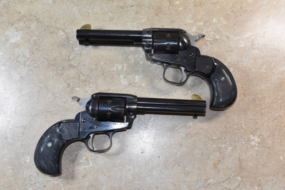

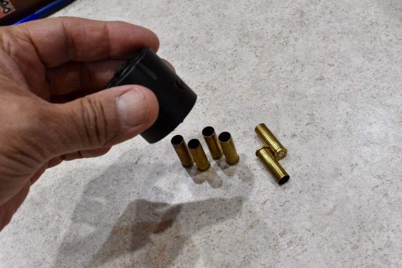

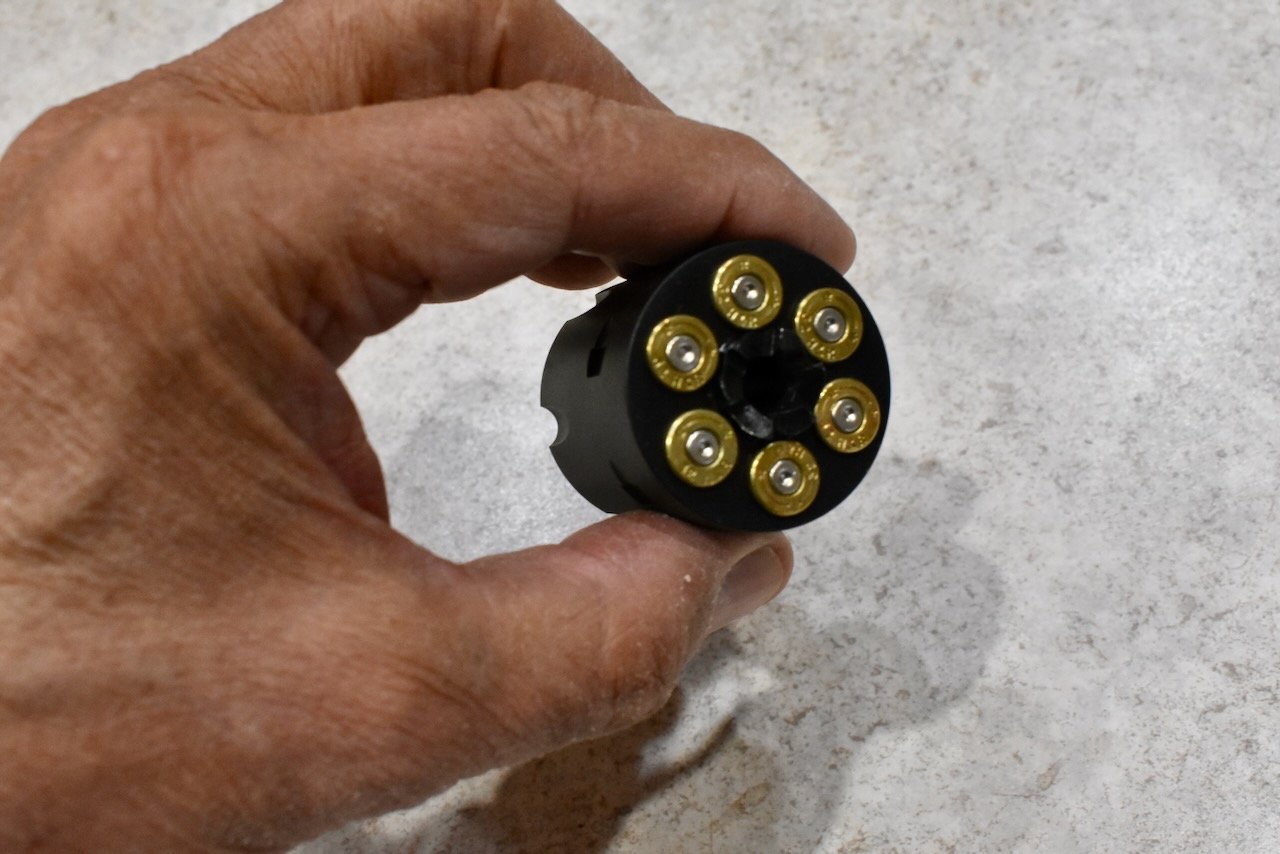

Rough Rider .32 Review
Larsen E. Pettifogger, SASS #32933 replied to Larsen E. Pettifogger, SASS #32933's topic in SASS Wire

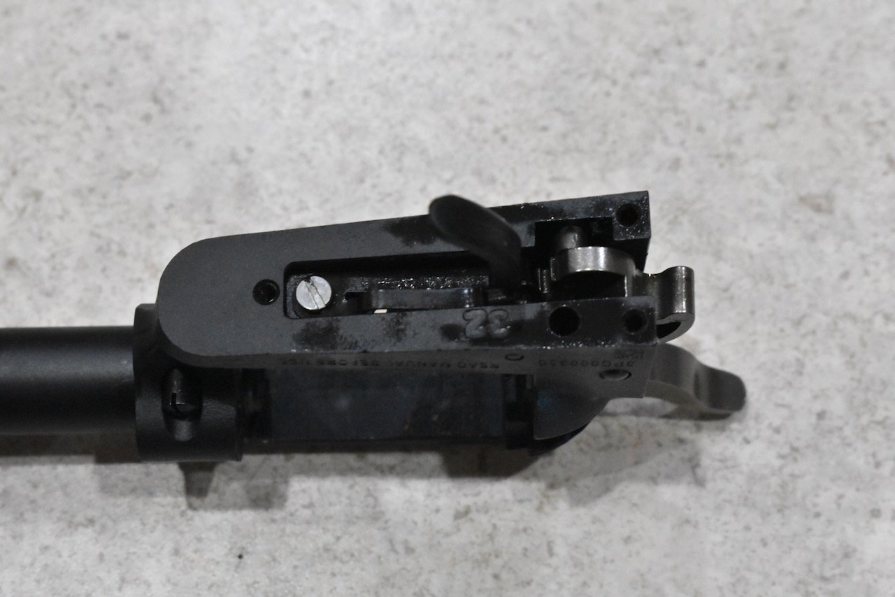

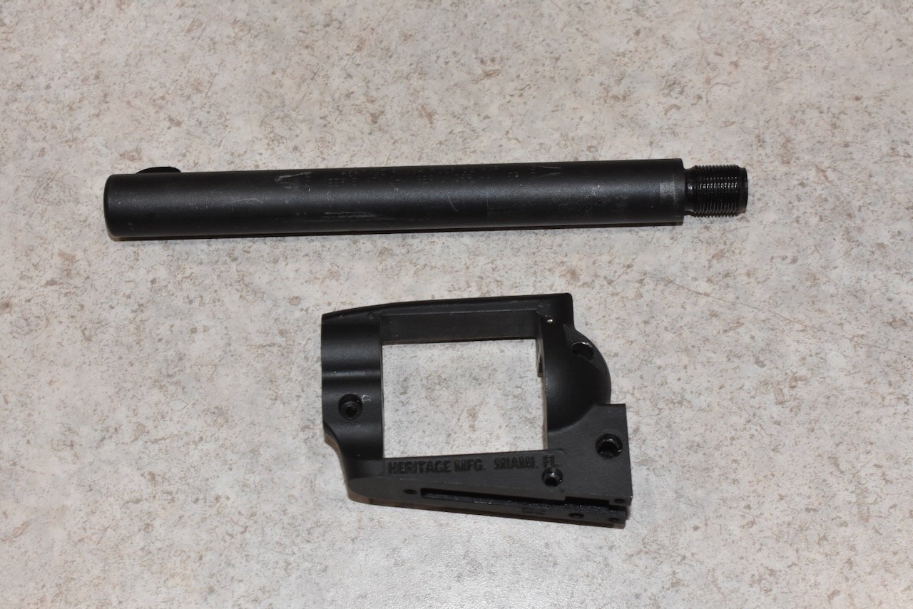

I think my original assessment about the firing pin was wrong. It appears to be a standard firing pin set-up. As much as I hate to admit it but so far I have been unable to remove the pin in the frame that retains the firing pin bushing. Some Ruger pins are difficult to remove but this one is a bear. Was thinking about shortening the barrel and want to see if I can get the frame level in a hydralic press so I removed the barrel. Looks like it had red loctite on it. -
Also, when the firing pin moves in and out it is quite crunchy. I will be trying to remove the firing pin bushing and firing pin and see what is in there. -

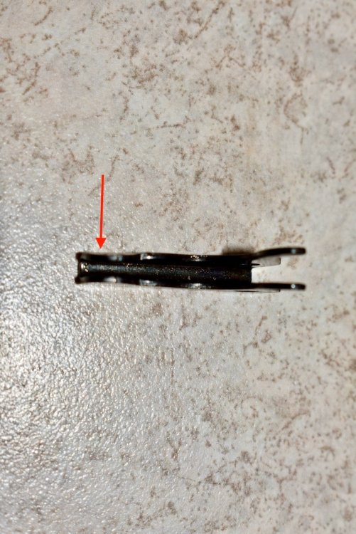

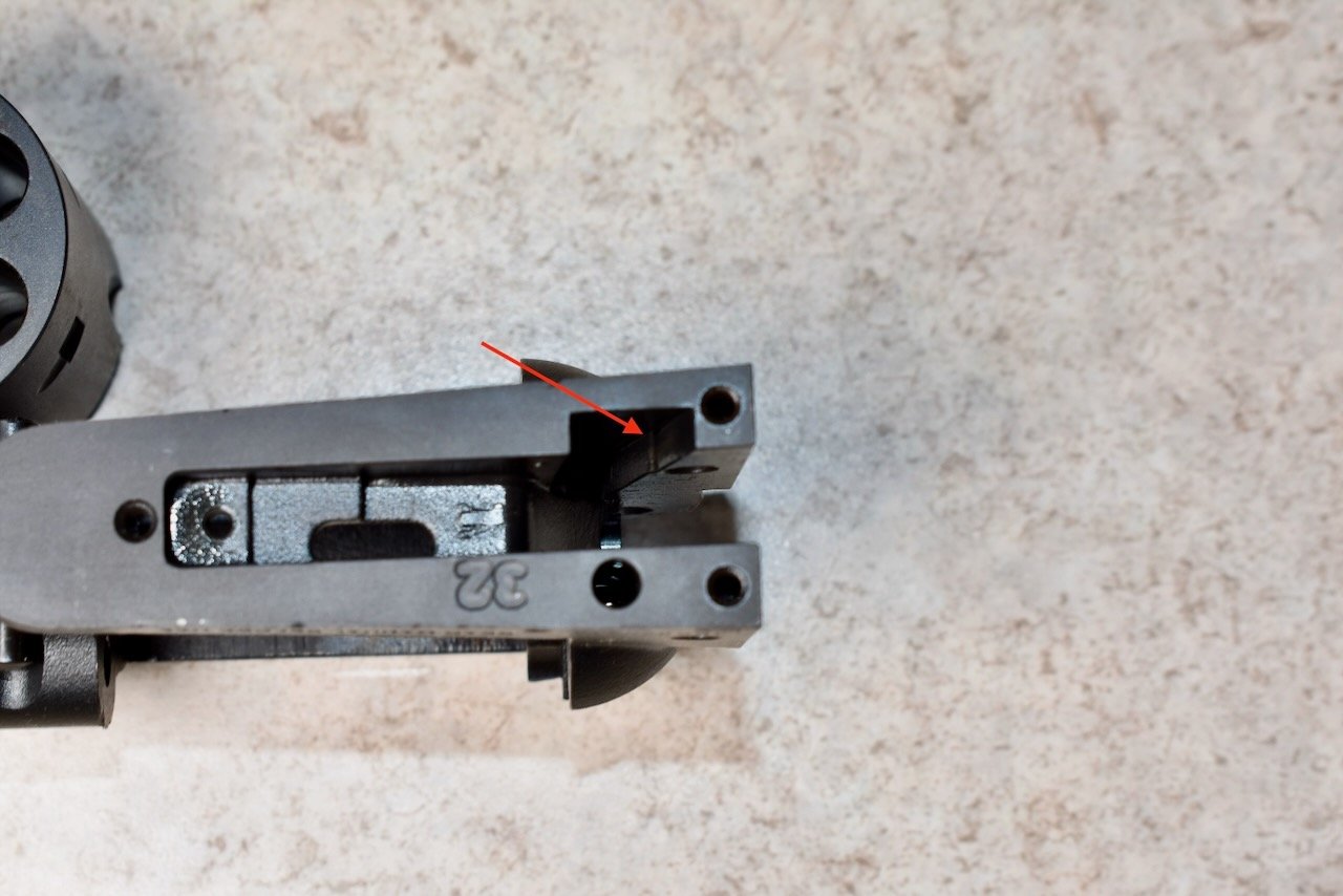

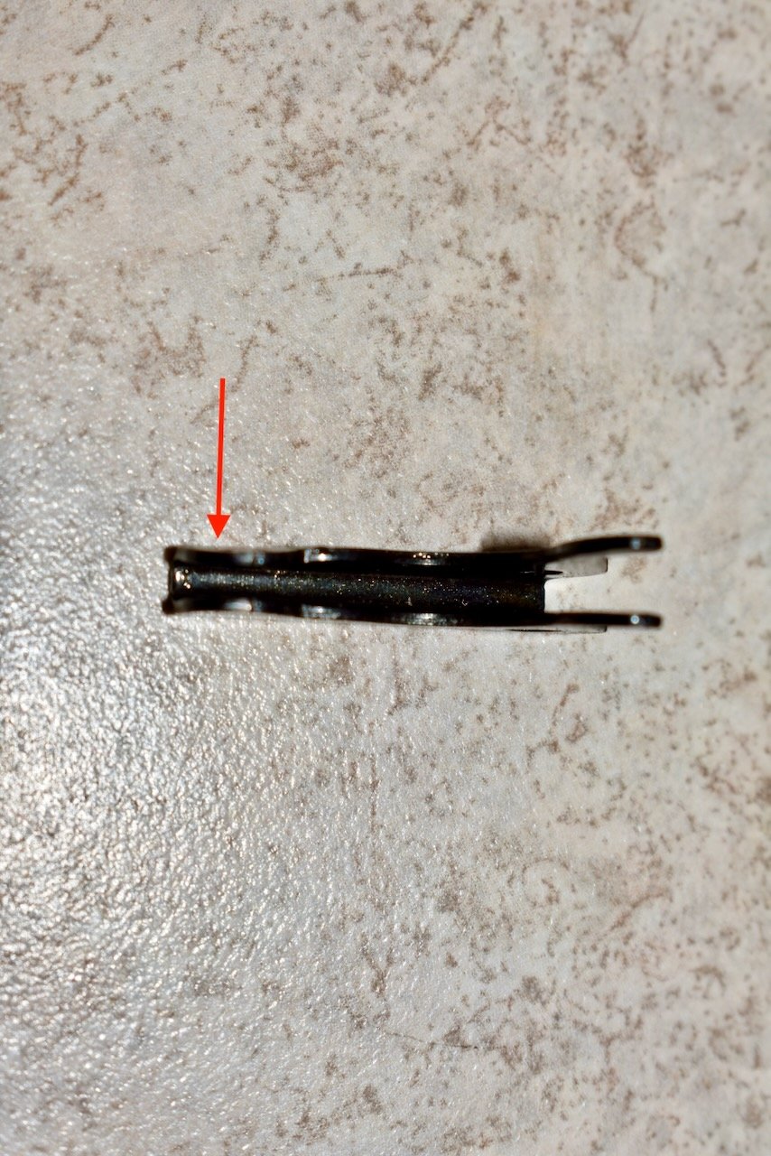

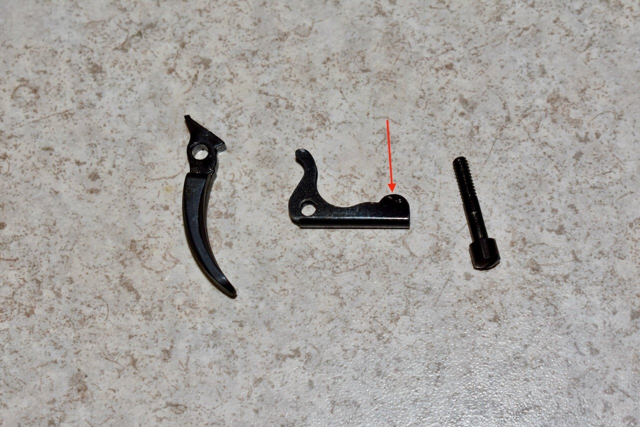

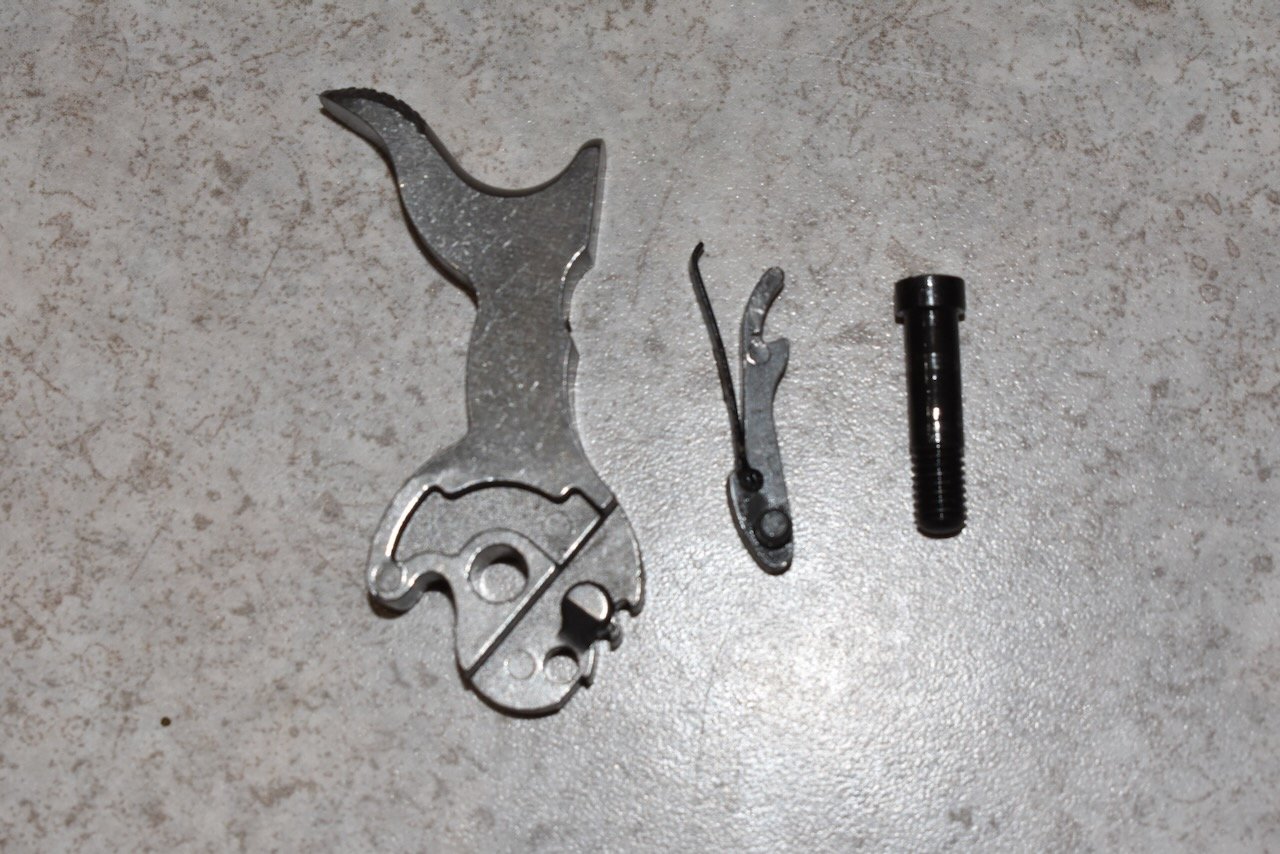

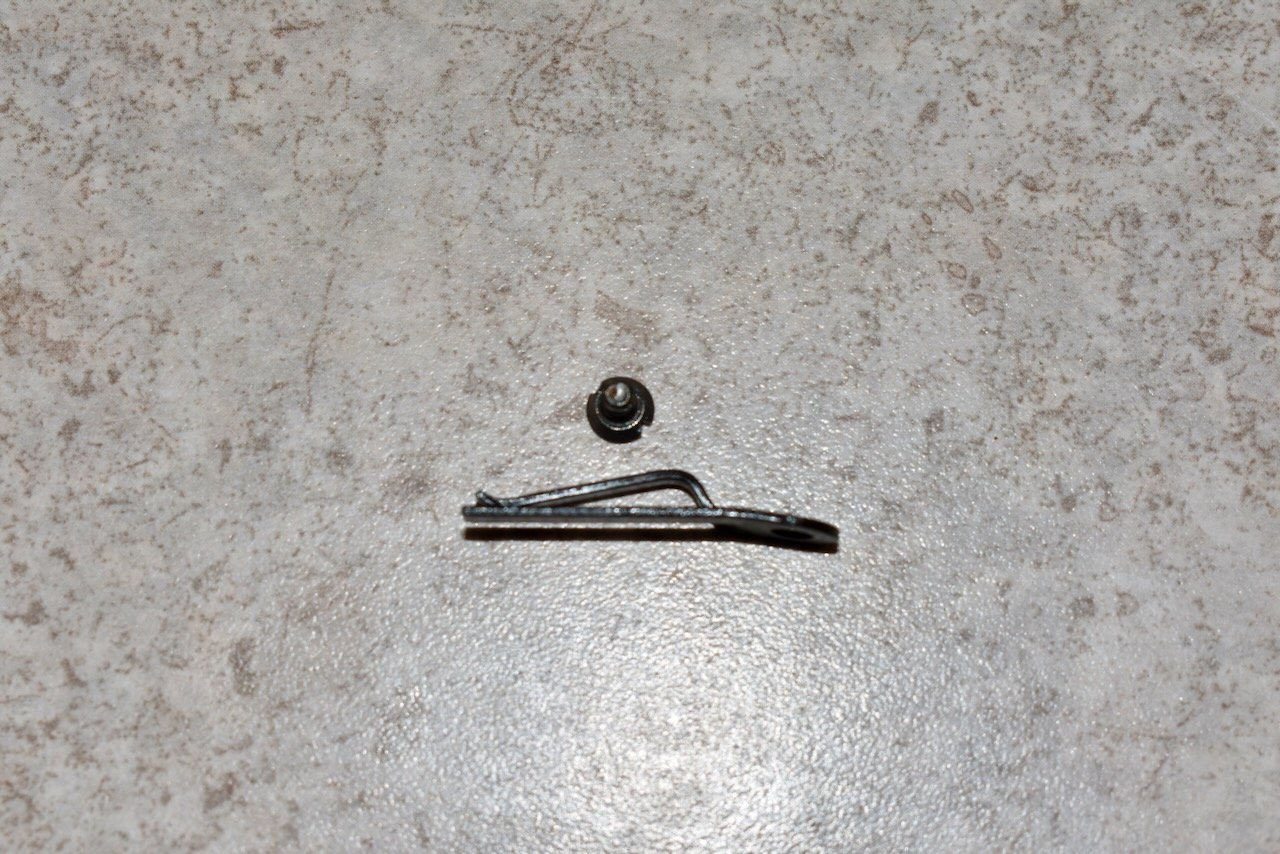

Disassembly continued. Here is a shot of the guts. The large filister head screw on the left looked like it was going to be something substantial. Nope still 4-40 but the big head does its job. The trigger/bolt spring has a substantial kink in it. The hammer and hand with the hammer screw. This is the only screw that is not 4-40. It is 10-32. The hand spring is very stiff. The trigger, bolt and trigger screw. The trigger screw remains 4-40. Then a bit of a surprise. The bolt is a stamping. The head that engages the cylinder notches (red arrows) is not solid. It is hollow. The dimensions explain a lot of the slop in the action. The hole in the trigger is at least .010" larger than the trigger screw. The hole in the bolt is much closer to the screw size. But, the bolt head is .120 wide. The bolt slot in the frame is .150+. The bolt notches in the cylinder average .150. The hand measures .135 wide. The hand slot in the frame is .152. The hand slot is quite smooth but there is a bump right in the middle. Red arrow. The bump may be below where the handspring actuall rides so I will have to check that later. Now comes the slow part. Figuring out what tolerances need to be reduced and how to do it. It may be a while before I make another posting. My initial impression is that for a $200.00 gun it is remarkable and would work OK as a casual plinker. Now I will have to see if some tuning can make it suitable for competition.
