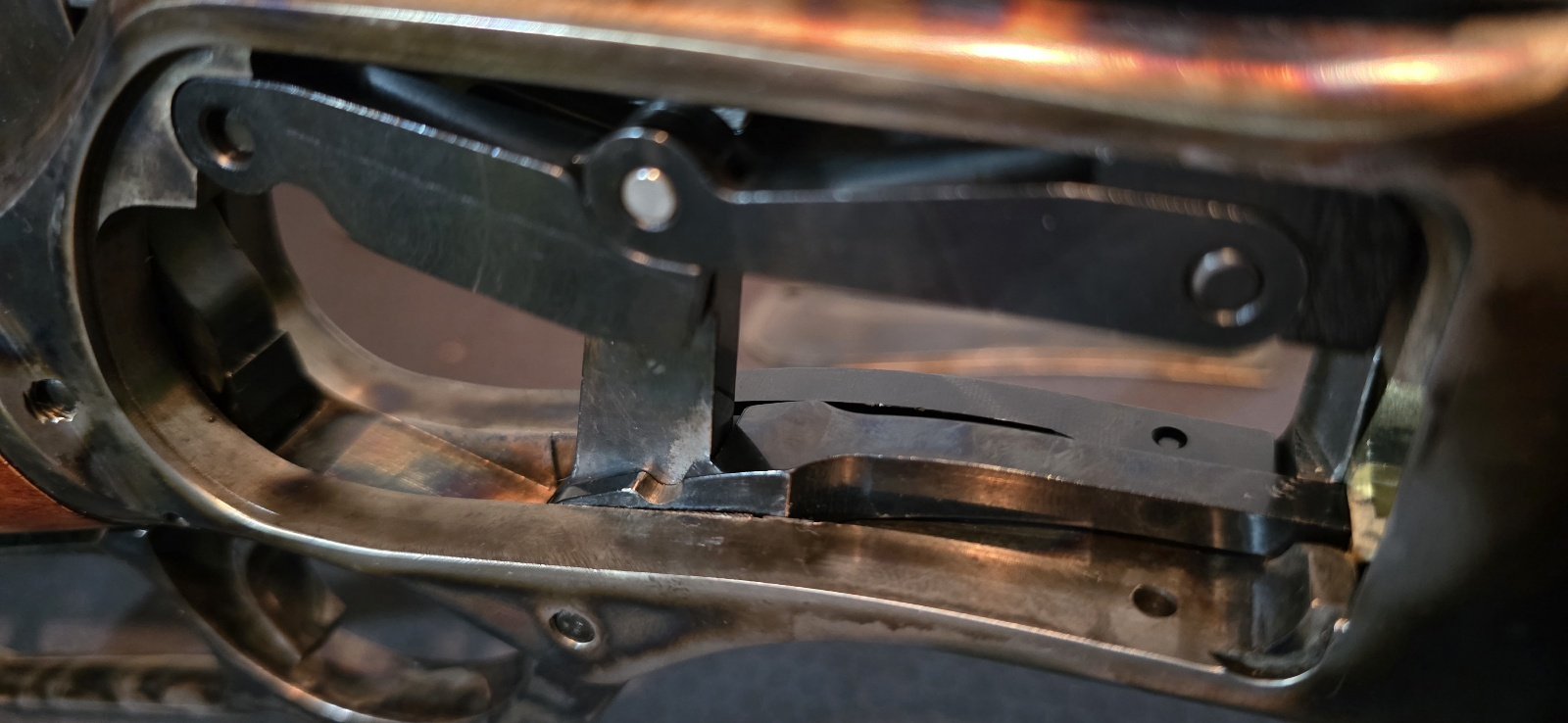

Figured out the cycling issue, and Abilene had it with tightening the screw on the right-side lever spring. In my defense, it was already very snug, but my frustration allowed me to discover it was able to turn 2 more times if I just cranked on it. Suddenly, the spring was doing what it was supposed to do, and the gun could cycle. Moving on to the next issue, light primer strikes. A buddy suggested a spring was maybe loose, and I saw a screw that I guessed (correctly) was probably the main spring screw, based on what I knew of Marlins. Once again, it looked good, but I cranked on it. Suddenly, the hammer didn't seem so light, and I had no more light primer failures-to-fire. Put about 70 rounds through it today, and had a great time. Accuracy testing will follow eventually, now that I know the gun can cycle/shoot. Thanks Abilene!

Funny enough, removing the right lever spring is the only thing I've found that restores functionality. Definitely wasn't loose, and hadn't fallen off the lifter arm.

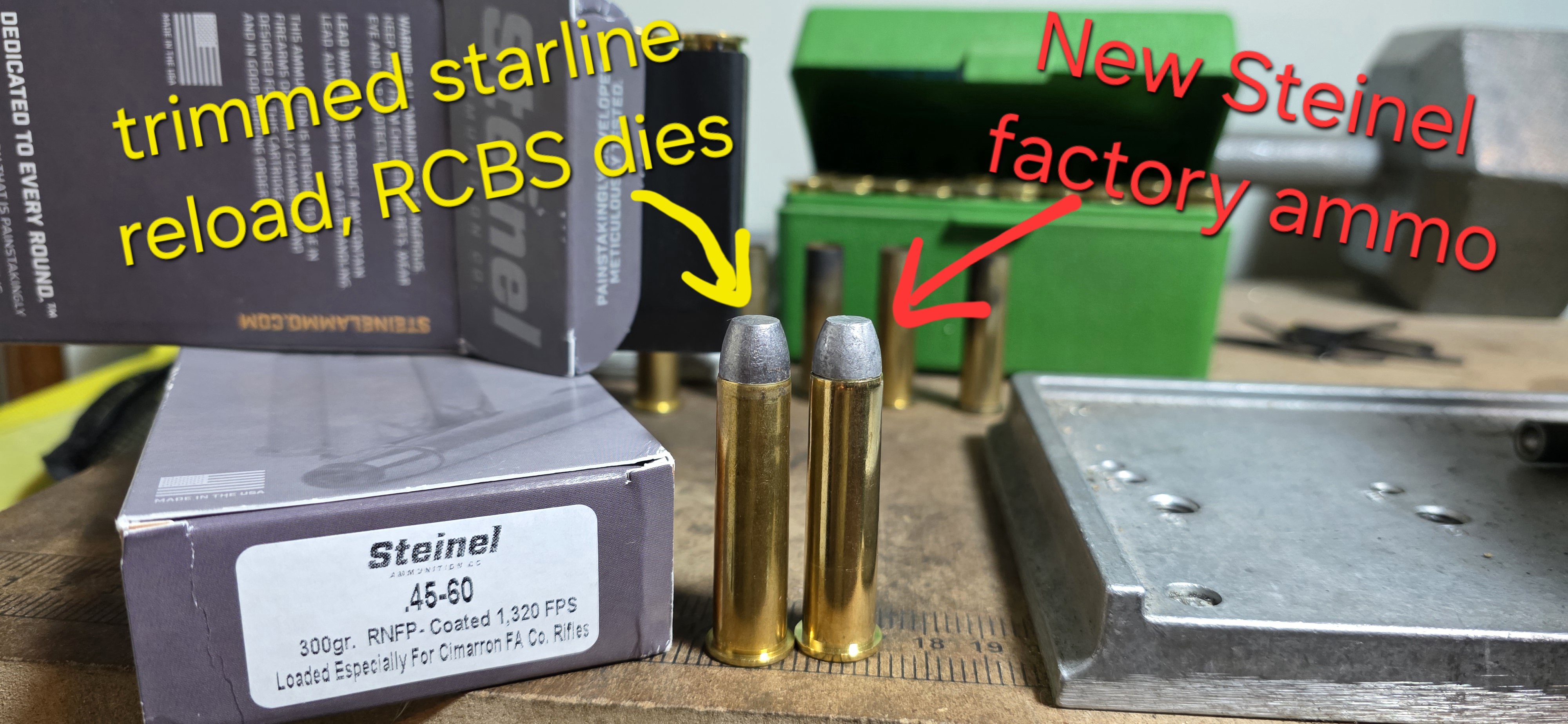

Sad to report that my first range trip with my new 1876 was not great! I owned a Cimarron 1876 a few years back, and I still had a decent bit of ammo from that. Sadly, my ammo was full of duds. Some primers fired on their 10th re-cocking of the hammer! Finally squibbed one and had to call it. Before I squibbed, my very expensive Steinel ammo was.....bad. $85 per box of 20. Had at least one round get the slug pushed back into the case. Other ones were very tough to chamber (they don't size the 45-60, appears straightwall'd). Velocity was wildly inconsistent, like 1200fps to 1450fps. At least it didn't squib! Now I've got the gun disassembled, but I can't figure out what I'm doing wrong on reassembly. The lever keeps getting jammed open when I work the action. I can see why, the brass lifter is sagging. Gets in the way of the bolt closing, basically locking it open until I push upwards on bottom of the lifter. And the internals are the roughest Uberti internals I've ever experienced. I'd say I've had a lot. Very very disappointed thus far.

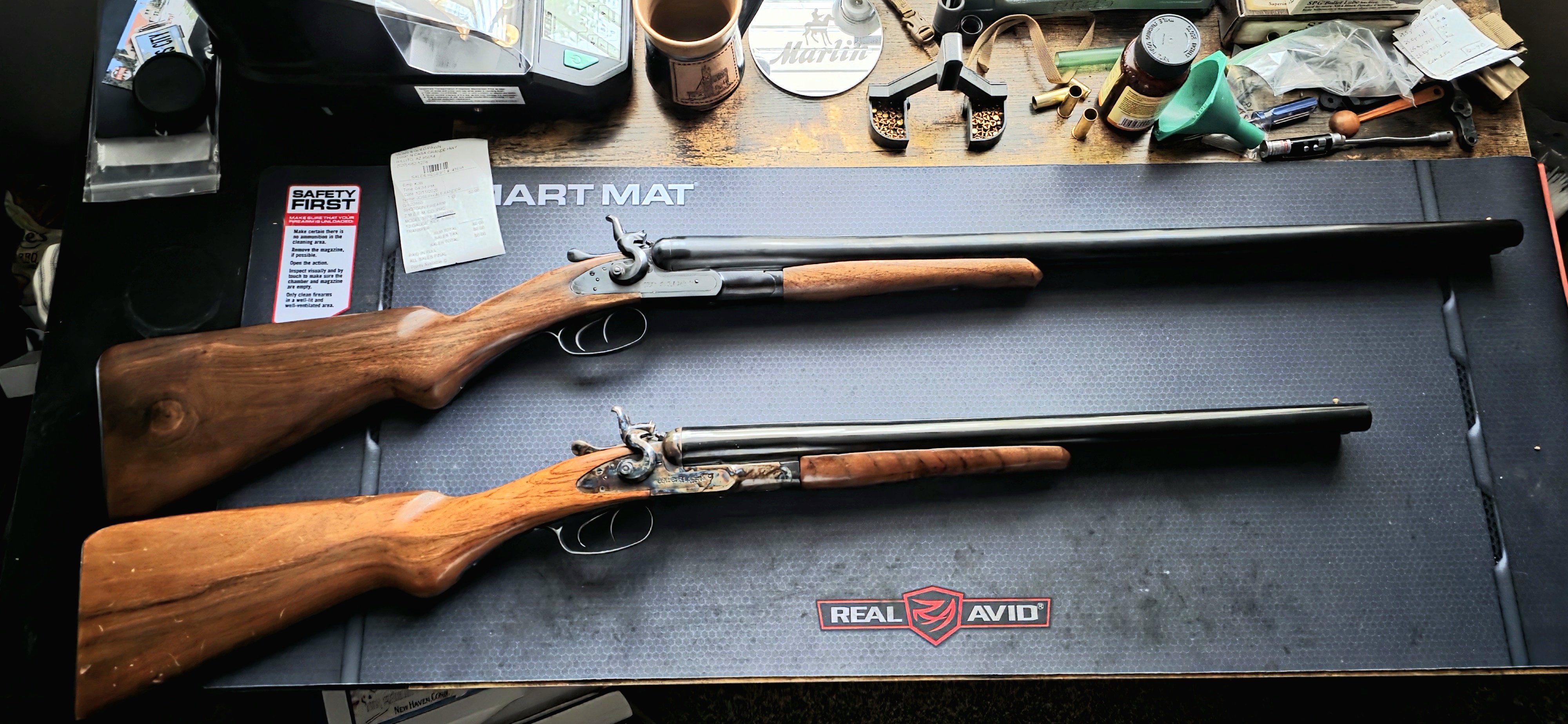

The new Cimarron 26" shotgun came in today. Probably be a week or so before I get to shooting it, and it might even be at a match haha (never been called overly smart). Not my best photo, but you can see the difference in barrel length from the 20" to the 26." It's a pretty heavy gun! Strongly smells of that oil that Cimarron slaps on all their guns lol

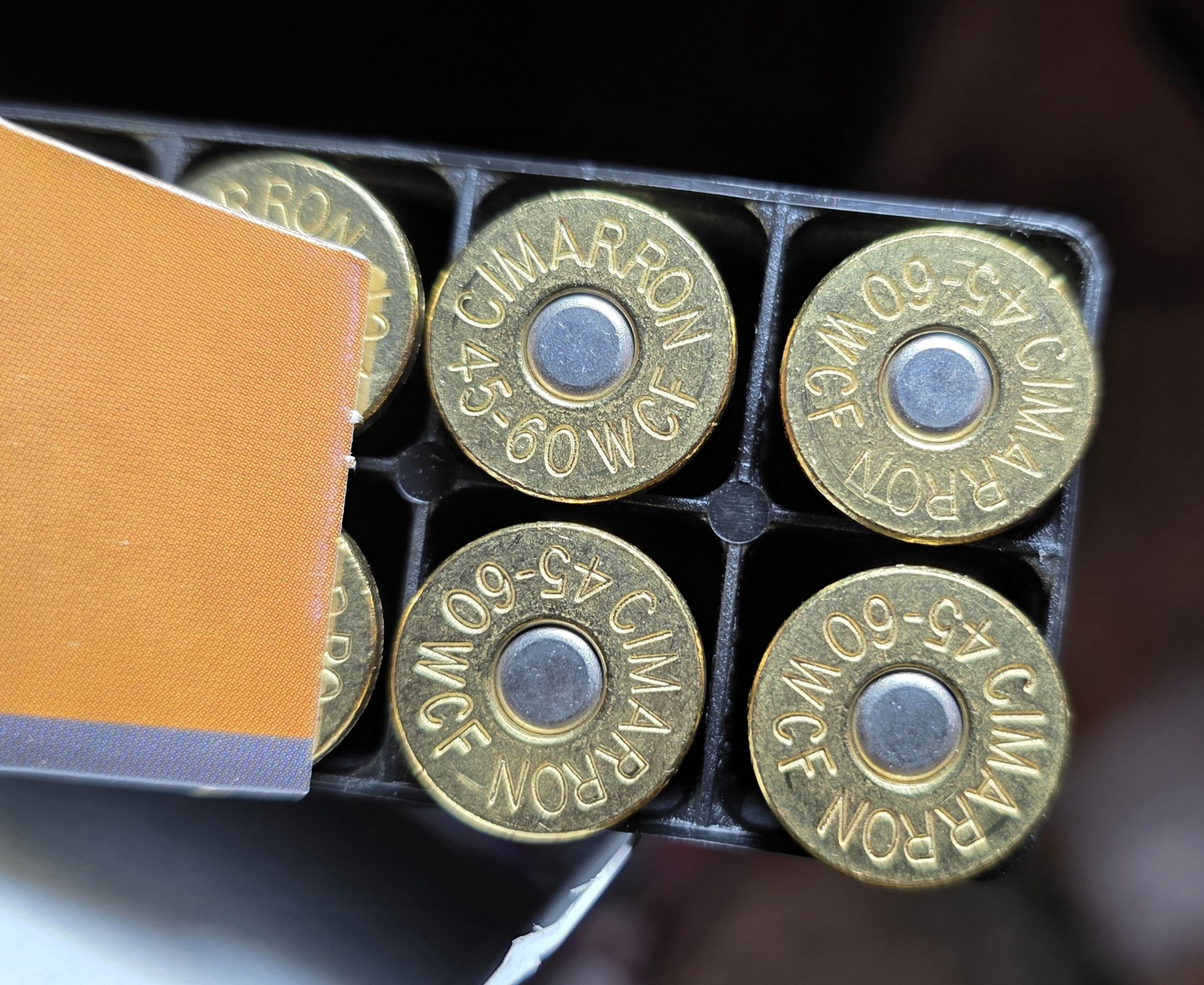

I got some Steinel 45-60 ammo delivered today. I was told by a buddy that Quality Cartridge makes the correctly stamped brass (the real reason I bought it). Big fan of Quality Cartridge! I've also bought their 25-36 Marlin, 32-40 Ballard, and 38-56Win brass. Still waiting for my e-check to clear at Buds....sigh. no rifle to shoot this ammo in just yet.
