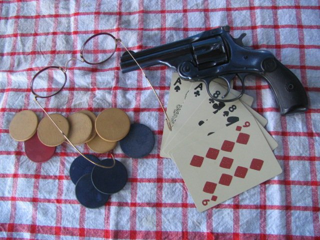

Hoss Posted July 18, 2023 Posted July 18, 2023 That one looks to be in decent shape. Assuming it functions perfectly, maybe $250. The S&Ws are generally worth quite a bit more.
Texas Maverick Posted July 18, 2023 Posted July 18, 2023 Hoss is an expert on pocket pistols, he has about a hundred of them. LOL TM
La Sombra Posted July 18, 2023 Posted July 18, 2023 17 minutes ago, Texas Maverick said: Hoss is an expert on pocket pistols, he has about a hundred of them. LOL TM And shoots them quite well too based on his wins. La Sombra
Three Foot Johnson Posted July 18, 2023 Posted July 18, 2023 Gunbroker completed auctions indicates $175 is about the top end. I think this is the same gun in blue - I paid $150 at a pawn shop, and it looked like it was unfired. That had to be at least five years ago though.
Larsen E. Pettifogger, SASS #32933 Posted July 18, 2023 Posted July 18, 2023 Question. Are you selling or thinking about buying? If buying with the intent of using for SASS side matches pass on it.
Preacherman Posted July 19, 2023 Author Posted July 19, 2023 I might buy, but don't know much about them. The help is appreciated. Thanks! Preacherman

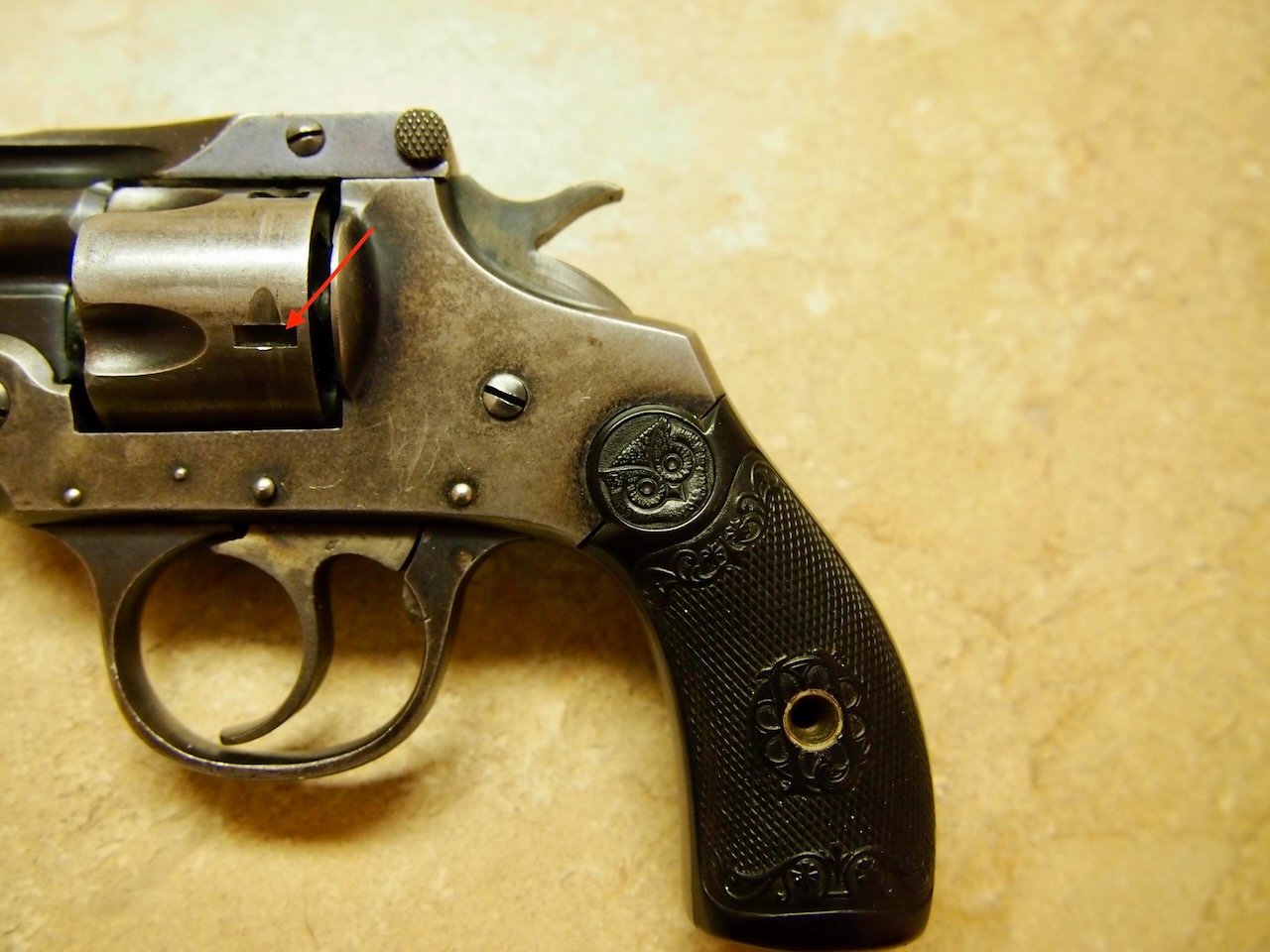

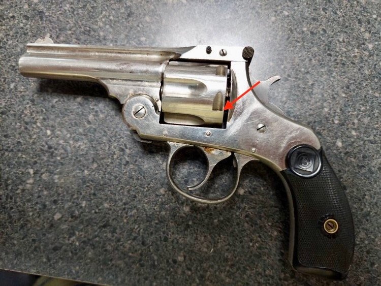

Larsen E. Pettifogger, SASS #32933 Posted July 19, 2023 Posted July 19, 2023 Here is why I would not buy it if you are going to shoot it in SASS side matches. These top breaks were very cheaply made and not really intended to shoot much. They only cost about a dollar and were often given away as punchboard prizes. Guns like those in the photo do not have locking bolt notches. The cylinder is locked into place by the bolt being pushed against the end of the cylinder lead slot by the hand. As the hand wears the lock-up goes away. On the better built top breaks they have cylinder locking notches and tend to be stronger and more reliable. The hand only rotates the cylinder. It does not lock the cylinder.
Nostrum Damus SASS #110702 Posted July 19, 2023 Posted July 19, 2023 The H&R Premier, Second Model has the horizontal cylinder stop notches. A nice one will cost in the $200 ballpark. It is a reliable little gun. Beware that the original double action trigger pull weight on most of these pocket pistols is VERY heavy. It was very difficult to fire one accidentally. I doubt you will find it too useful in side matches unless you dive into the world of internal parts polishing and hammer spring modification. They're still a ton of fun to shoot, even in original shape. And .32 S&W ammo is commercially available if you don't want to bother reloading it.
Preacherman Posted July 19, 2023 Author Posted July 19, 2023 Well, thanks a million for the info and advice! That's why I asked. I see that this one will not lock up solidly. Best if I pass on it. Thought it interesting though.

Three Foot Johnson Posted July 21, 2023 Posted July 21, 2023 Two of my favorites, out of... eleven, I think. An Iver Johnson New Model/3rd Model six shot .32 and a S&W 38 Double Action Perfected five shot .38 S&W. Both have well-defined leads and cylinder stop cuts, as per Larson Pettifogger's post, and are great shooters for pocket pistol side matches.
