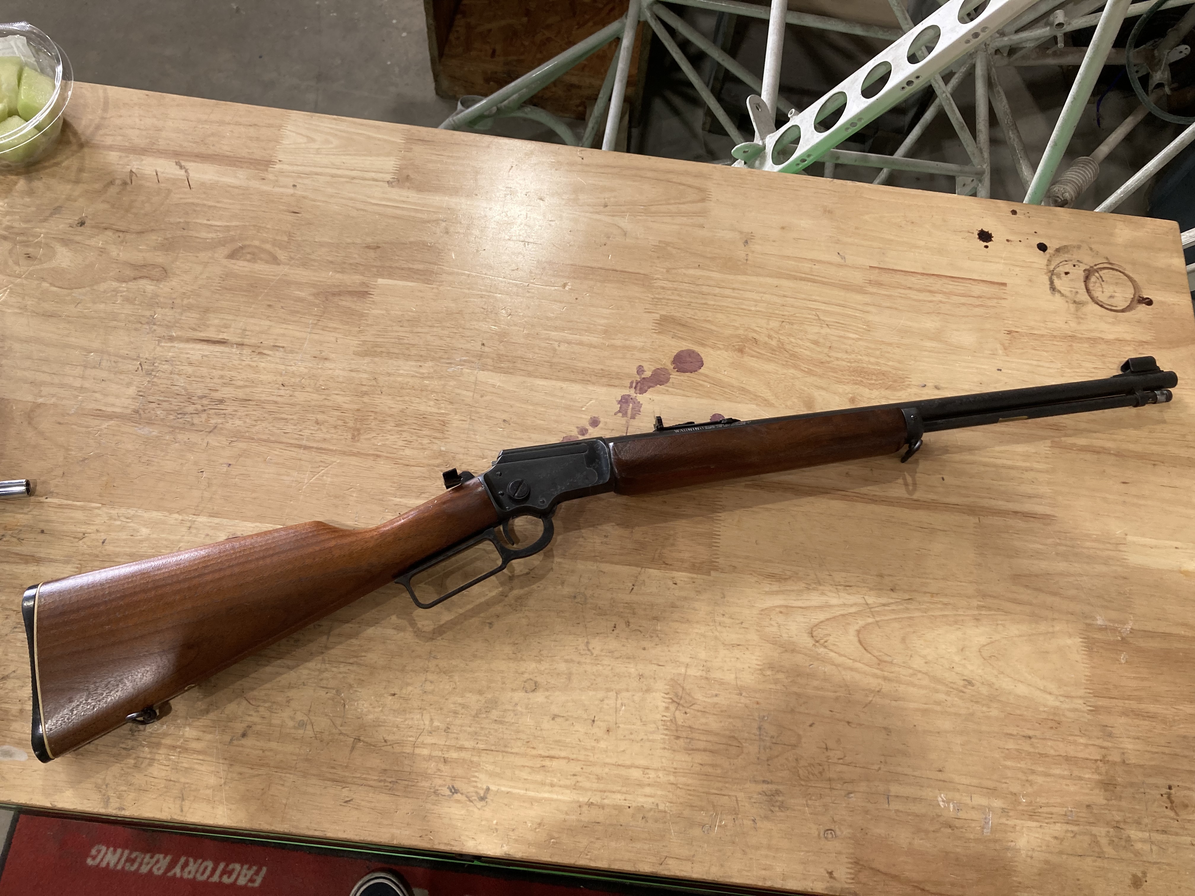

AV8R317 Posted March 4, 2023 Posted March 4, 2023 Just got my first 39. It’s a 1982 JM original golden 39M micro groove. Got it for $600. It’s in rough shape cosmetically, lots of pitting on the barrel and receiver, few small dents to the wood furniture here and there, and could use a refinish. However the bore is nice and shiny, rifling looks good, and the action feels smooth, although I think with some fine grit sandpaper I can make it better. I bought it because I like projects, and I’ve been looking for a good 39 for a while now. Want to restore it for a weekend shooter. I’m thinking that most of the pits can be dealt with by careful use of a drawfile and sandpaper. Don’t mind leaving a few pits here and there, as I think it adds character. Then again, my OCD may dictate otherwise. I plan to finish with mark lees rust blue. I’m a little less comfortable with the wood aspect, but I figure between the existing posts on the subject, y’all’s advice, and a willingness to put in the work I’ll do just fine. I’d appreciate any suggestions for things to look at, parts to inspect and/or replace, methods for refinishing both the metal and wood, and any other comments y’all have.
Chickasaw Bill SASS #70001 Posted March 4, 2023 Posted March 4, 2023 Sir given what I see in the pics I would suggest Dura Fill , followed up with Blue DuraCoat the pitting looks to be pretty deep , and in places where I do not think it can be removed , with out a lot of waves in the metal Good luck , with the project Chickasaw Bill
August West, SASS #45079 Posted March 4, 2023 Posted March 4, 2023 If the outside of the barrel is severely corroded, so will the inside be. M39 barrels were not chrome lined. Several take-off barrels are shown at Ebay, and that's the only path to victory. This is particularly concerning as the most severe corrosion is at the muzzle of the barrel -- the part that most affects accuracy. With regard to the receiver, be sure to do all the work with the receiver assembled. The edges of the joint between the two receiver halves will be easily rounded off it you work on it disassembled. Here's one example of barrel offerings at Ebay: https://www.ebay.com/itm/195636335017?hash=item2d8cd591a9:g:4cMAAOSwiJdkAsGi Good luck with your project.

Kulshan 20262 Posted March 5, 2023 Posted March 5, 2023 "Rode hard and put away wet" is what I thought when I saw your pictures. Glad it shoots good.
Garrison Joe, SASS #60708 Posted March 5, 2023 Posted March 5, 2023 A good Mountie should (from a benchrest) shoot a 1" group at 25 yards, or smaller, in the hands of a qualified marksman. But 22 rifle accuracy depends a lot on the ammo matching what the rifle wants to shoot. So, try several different brands. Especially including Federal 711B standard velocity target ammunition, which for lots of my 22s gives premium accuracy. "Restoring" that gun will mean a trip to a professional restoration shop. Set aside $500 or so for that route. If the function of the gun is fine, I'd swallow some pride and just shoot it as is. As mentioned above, your filing and sanding on it will make things worse, because of the depth of the pits. To make those pits disappear will need them to be filled with weld steel and then carefully brought back to original shape - not a job for a first timer or without a ton of tools. I've cleaned up maybe 20 old guns, and never tried working on one that deeply pitted. And doing a whole gun with any cold blue is about 100% guaranteed to give a disappointing, thin, shallow, mottled result that rubs off easily. Stock refinishing is easy compared to the metal. Not that pics of the stock indicate major problems there. Again, I'd leave the wood alone, too, and just shoot it. But if you do want to freshen the wood, DO NOT SAND off the old finish. Instead, chemically strip old finish and use only VERY fine sandpaper to dewhisker before re-oiling. Tru-Oil linseed oil based gun finish will get you a finish that is very durable and easily touched up. good luck, GJ

Garrison Joe, SASS #60708 Posted March 5, 2023 Posted March 5, 2023 That deeply pitted magazine tube will give you the most immediate problems as you try to fix and shoot it. Depth of that pitting looks like it will compromise the strength of the tube, and I'd estimate you will not be able to bring down the surface to good level metal. And unfortunately, parts for a Marlin 39M are in VERY short supply, Ruger has not decided to make new Marlin 39s, and they have recently announced they are not supplying any parts or work on any pre-Ruger made Marlins of any model. If you had volunteered your previous experience with some reworking of pistols, then suggestions could have been more focused on what would suit your skill level. Good luck with your work. Make it meet the needs for what you want to do with it. GJ
H. K. Uriah, SASS #74619 Posted March 5, 2023 Posted March 5, 2023 Since the gun actually works, I'd be hesitant to do anything to it. It may look beat up and ugly but that gives it some character. That being said, I had an 1898 Krag that had some pretty nasty pitting where the stock meets the metal, and while everything functioned as it was, it was starting to get some rust in areas where you don't want to have rust. So I had the thing reblued by a local gunsmith. He took care not to obliterate any markings, and the pits are still there. But now it is still shootable and will not degrade any further. If you do anything, that's the route I would take. I think that all that pitting with a good bluing would look pretty interesting.

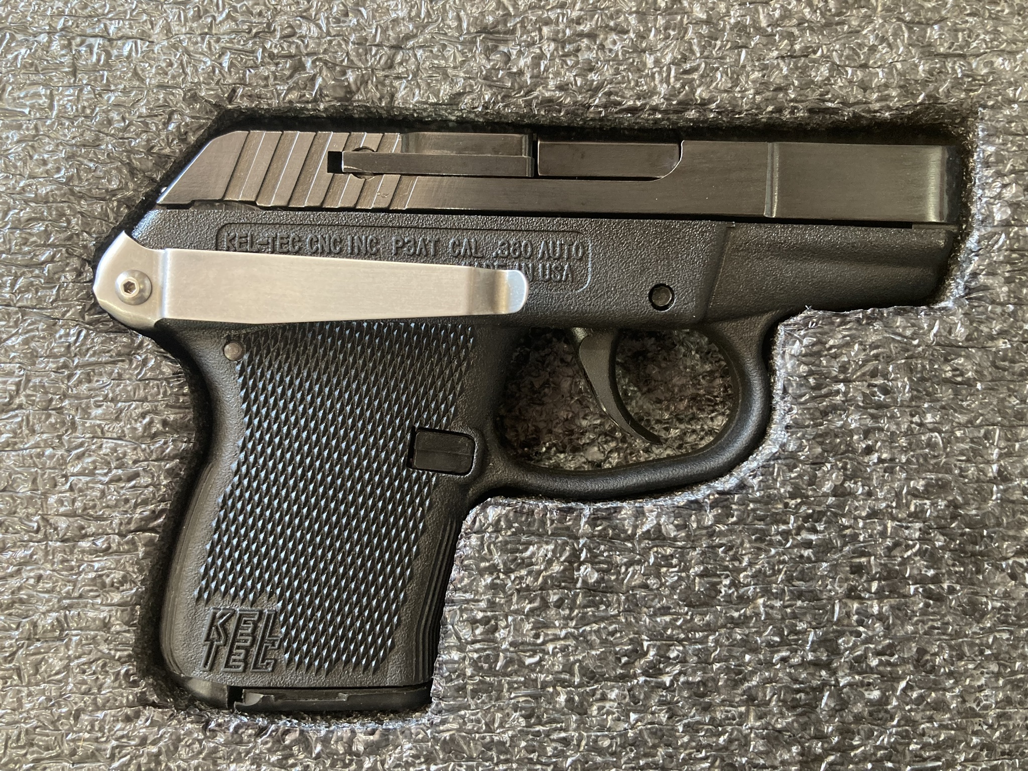

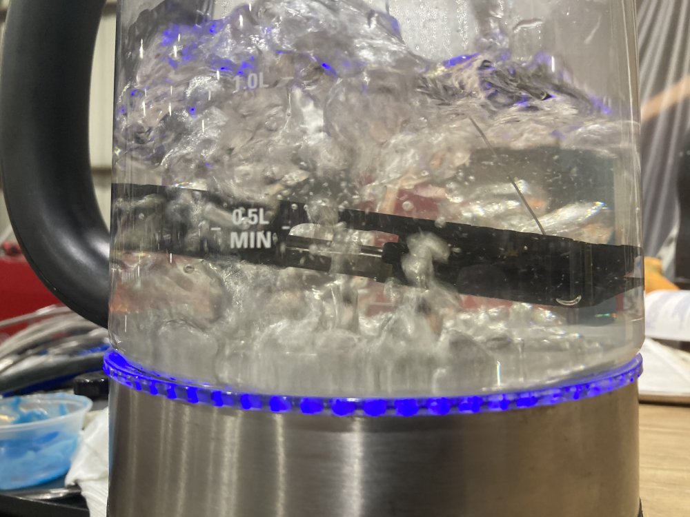

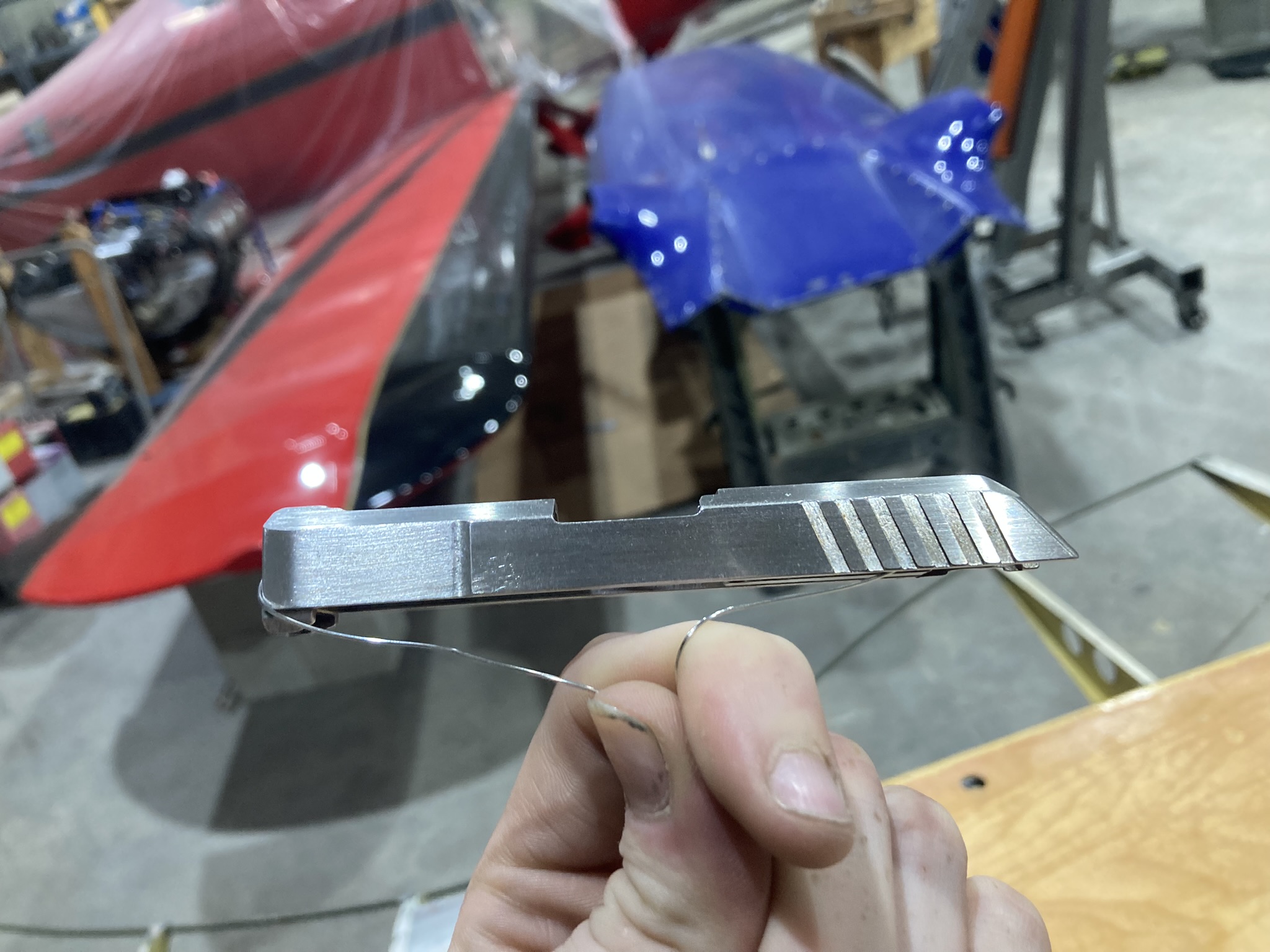

AV8R317 Posted March 5, 2023 Author Posted March 5, 2023 15 hours ago, Garrison Joe, SASS #60708 said: That deeply pitted magazine tube will give you the most immediate problems as you try to fix and shoot it. Depth of that pitting looks like it will compromise the strength of the tube, and I'd estimate you will not be able to bring down the surface to good level metal. And unfortunately, parts for a Marlin 39M are in VERY short supply, Ruger has not decided to make new Marlin 39s, and they have recently announced they are not supplying any parts or work on any pre-Ruger made Marlins of any model. If you had volunteered your previous experience with some reworking of pistols, then suggestions could have been more focused on what would suit your skill level. Good luck with your work. Make it meet the needs for what you want to do with it. GJ My apologies, I should have mentioned my previous experience beforehand. And I agree in regards to the mag tube, which is why I will most likely be leaving it alone and/or possibly keeping an eye out for a new one if I get so lucky. If you have any suggestions on places I could watch out for one I’d appreciate the info. As far as the rest, I’m more concerned with doing the barrel and the receiver, because even if I can’t get it all, I figure it will at least look a lot better. And I think that refinishing the stock will at most help to accentuate the wood a little better. Thanks for the input!

Abilene Slim SASS 81783 Posted March 6, 2023 Posted March 6, 2023 Looks like an airplane in the background. May I ask what it is?
AV8R317 Posted March 6, 2023 Author Posted March 6, 2023 Fuel tank located in the center section of the top wing had a leak so we had to replace it. The kicker is, the person that built it installed the dang thing wrong so we had to essentially rip the wing open to get the tank out as opposed to just lifting it out. Been a hell of a job. We’re reinstalling the top wing today, nine months later.
