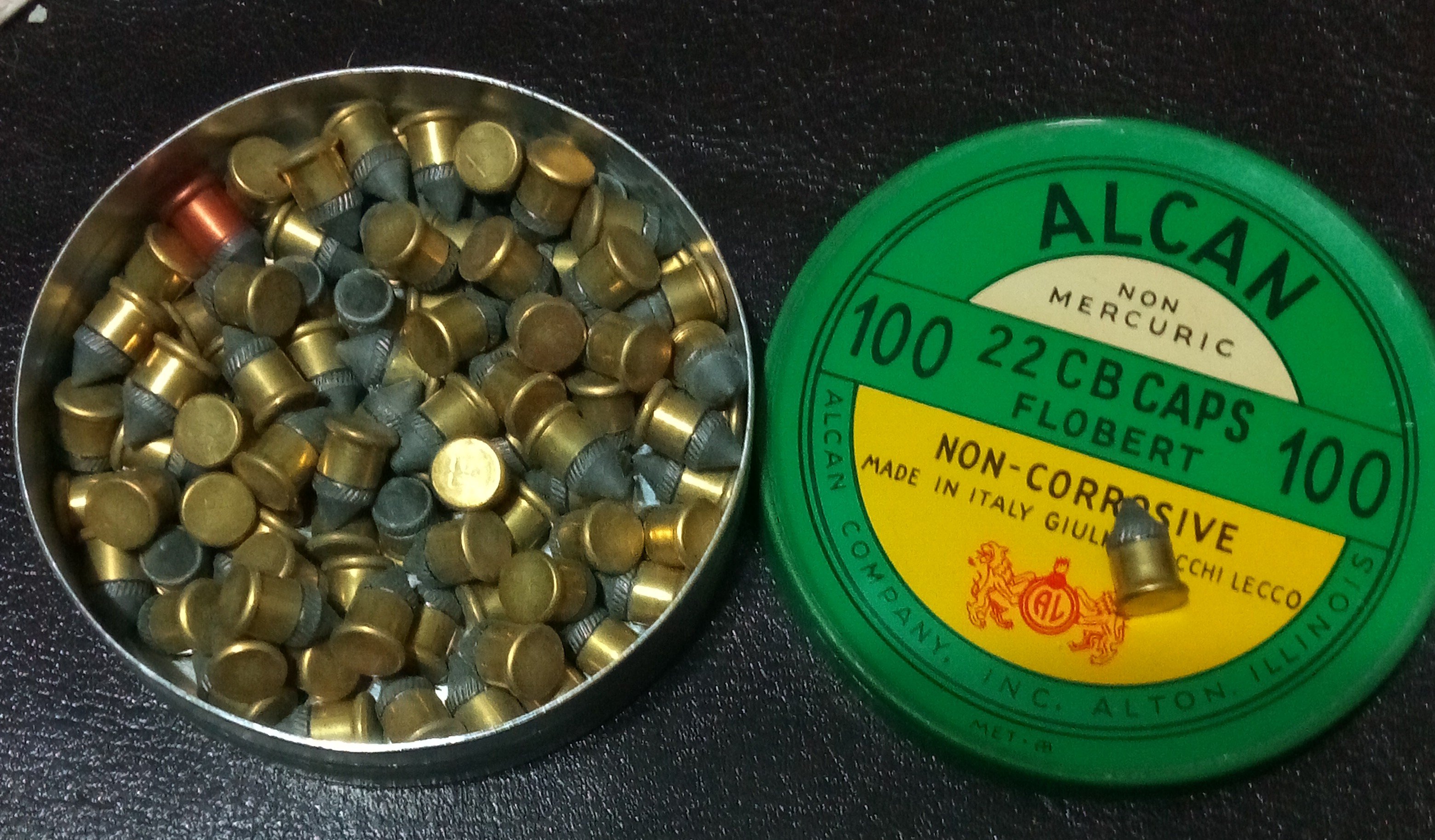

Alpo Posted October 5, 2021 Posted October 5, 2021 I have some. Actually these are CB caps. The original 22 was the BB cap. That stood for bulleted breach. Uses a round bullet. And then they put a pointed bullet in it, which improved the ballistics, and called it a conical bullet - thus CB cap. My neighbor gave them to me. He would use them to shoot rats in his garage, because if he missed the rat it would not go through the corrugated steel roofing. And I gave him a box of the super colibri, and later that day he called me over to the fence and gave me this box of CB caps. He said they worked for him, but I haven't tried them yet. For one, because they're hard to come by, and for two, because they're so damn little they're hard to handle. CCI sells CB in both short and long configuration. They are more powerful than the Colibri, with both using a 29 grain bullet at 710 feet per second.
