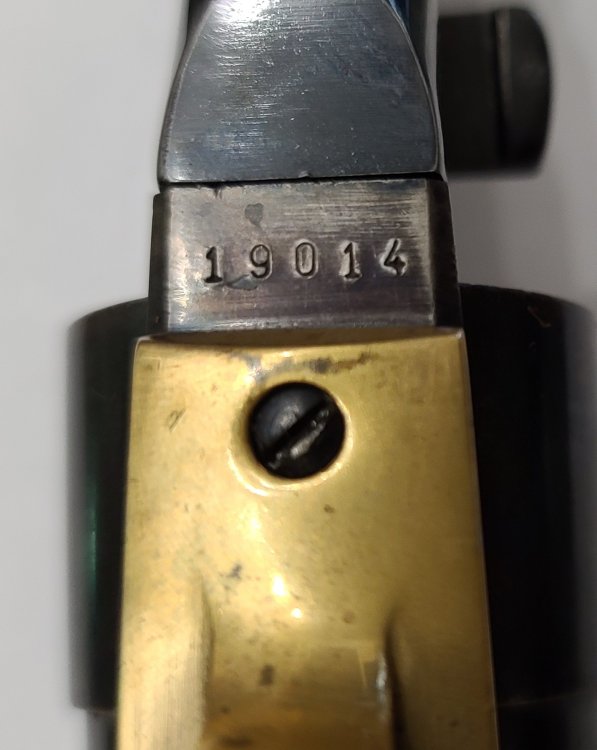

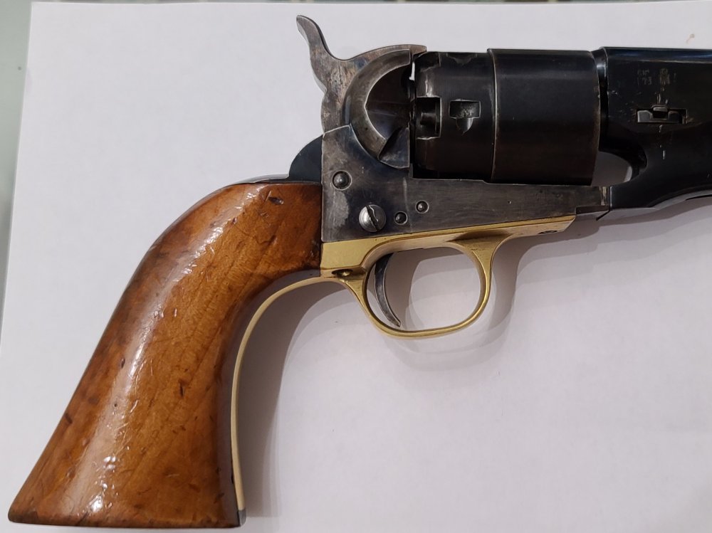

aussiejon Posted September 6, 2021 Posted September 6, 2021 Hey there! newbie first post. I recently bought a ?pietta? 1860 with no identification marks. it has a serial number on the frame and a fitted smooth cylinder with a serial number somewhat close to the number on the frame. it fits a pietta barrel perfectly. there are no markings inside the frame. Any identification info is appreciated!

Griff Posted September 6, 2021 Posted September 6, 2021 Look under the rammer for the proof mark, etc.
Prairie Dawg, SASS #50329 Posted September 6, 2021 Posted September 6, 2021 Pietta name is along the right side of the barrel. Most others name/logo is underneath the loading lever. Manufacture date code like ""BT" is in s box on the right side of the frame. The serial number is no help. See This: https://www.prairiedawg.net/nick/MBPProofmarks1.pdf --Dawg
aussiejon Posted September 7, 2021 Author Posted September 7, 2021 Thanks for the replys. the barrel I have on it did not come with the rest of the pistol. I have 5 other pietta, a western arms, and two Uberti's. this is the only one that has no markings on the frame other than the serial number.

Garrison Joe, SASS #60708 Posted September 7, 2021 Posted September 7, 2021 2 hours ago, aussiejon said: this is the only one that has no markings on the frame other than the serial number. According to Italian proof marking requirements, as well as the barrel, the cylinder is supposed to be proof marked on revolvers. I'd say someone seriously "defarbed" your receiver and cylinder. AKA, polished off the manufacturer and proof marks. good luck, GJ

aussiejon Posted September 11, 2021 Author Posted September 11, 2021 On 9/7/2021 at 12:47 AM, Garrison Joe, SASS #60708 said: According to Italian proof marking requirements, as well as the barrel, the cylinder is supposed to be proof marked on revolvers. I'd say someone seriously "defarbed" your receiver and cylinder. AKA, polished off the manufacturer and proof marks. good luck, GJ Ha! that sounds like the best explanation. thanks
