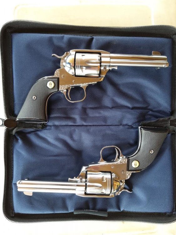

Rusty Cuffs 8 Posted December 30, 2020 Share Posted December 30, 2020 Crusty here is a pair that Jimmy Spur did. Quote Link to post Share on other sites
