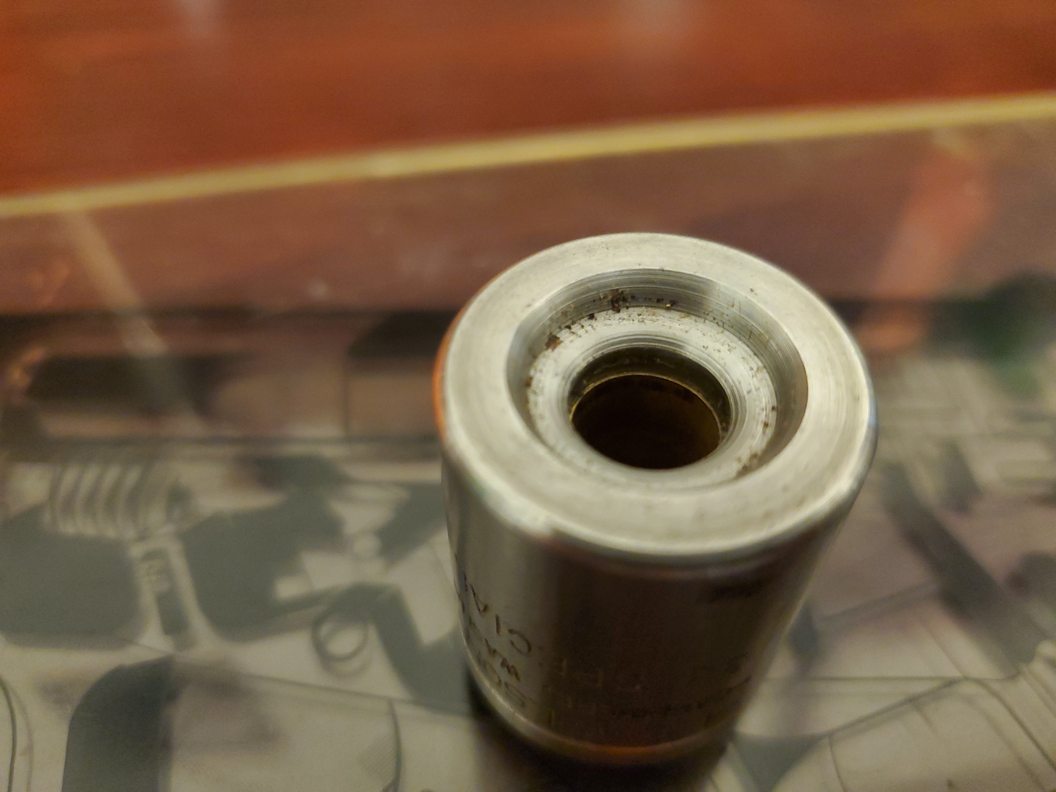

Waymore Loco Posted September 25, 2020 Posted September 25, 2020 I bought this L.E. Wilson case holder for 38 Special. The casing doesn't stick through. As you can see the holder is as long as the casing. 357 Magnum doesn't even stick through. I watched a video that L.E. Wilson put out on how to trim a casing. Theirs poked through and worked fine. I'm confused. Did I get a factory goof or am I doing something stupid?
Garrison Joe, SASS #60708 Posted September 25, 2020 Posted September 25, 2020 I'd advise you to go back and watch the video on the Wilson web site again about how to use the case holder in the Wilson case trimmer. "Explanation of Case Holders and Proper Use" at site: https://lewilson.com/videos Start at about 5:30 in the video and watch carefully. This holder is slow to use. The fired case is pressed into the holder with an arbor press or a blow from a plastic or wood faced mallet The rim sets right down into that well, it is not left proud as your second photo shows. The mouth then should extend just a few thousandths above the steel of the other end of the holder. A .357 Magnum case cannot be trimmed in this .38 special holder. A Wilson case trimmer kit is then used to trim the excess length. A short piece of wooden dowel can be used to pop the trimmed case back out of the holder. This is a very precise, high accuracy case preparation step. I will venture to say that very few cowboy shooters ever trim a .38 special case, using any kind of trimmer. And go further to say this degree of precision capable with the Wilson trimmer is not beneficial to much of any shooting but bullseye target competition. I would doubt you have a mis-manufactured part. You just are not using it correctly. Explain what you are doing if you think you have it correct. I don't own one of these, so I am going by what is explained in the video. Good luck, GJ
Waymore Loco Posted September 25, 2020 Author Posted September 25, 2020 I'm guessing you found a different video than I watched. That is info I hadn't heard.
