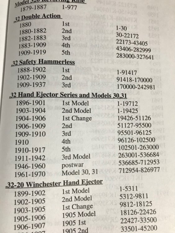

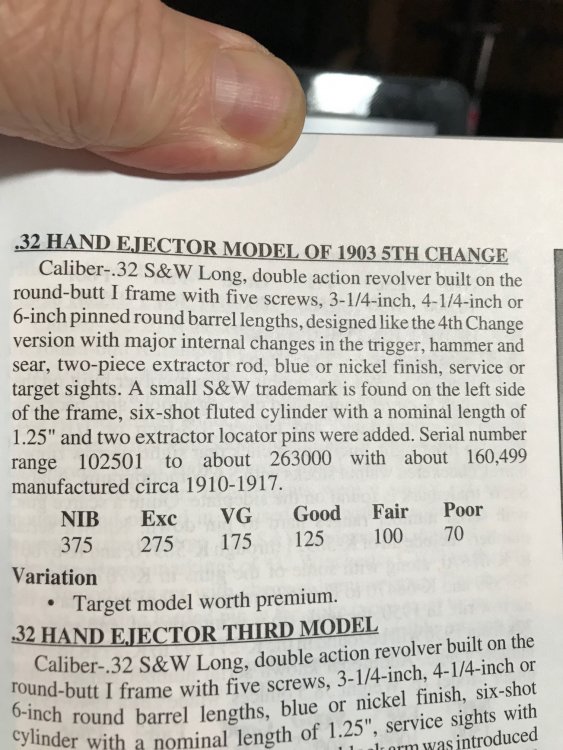

Pat Riot Posted February 8, 2018 Posted February 8, 2018 Okay, I went through my Standard Catalog of Smith & Wesson 2nd Edition and found a little more info...maybe. S&W 1903 5th Change 1910 - 1917 This makes it look like yours was made in 1910. This page puts your revolver, by serial number, as a 5th model between 1910 - 1917 as Clay said. I would say yours was early in the series and from the info above it was made in 1910 or 1911. I hope this helps. I got all excited and thought I found a discrepancy and then realized I ws chasing the .32 Double Action...not the Hand Ejector model. Boy that would have caused more confusion...
