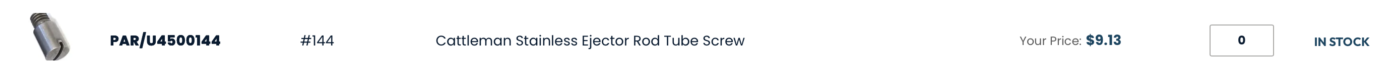

You could also try this and use some blue remover to remove the blue. https://www.ebay.com/itm/127657887261?_skw=USFA+screw&itmmeta=01KM8VXKDD8EW803556G12CP16&hash=item1db900c61d:g:DbwAAeSw1u1pftN0&itmprp=enc%3AAQALAAAA4GfYFPkwiKCW4ZNSs2u11xDGgFlRwWktt4n6jqHYnPIbJivHhb9gFaqCCjG0jgc66apd0xiytmRwOM%2B7WExeqcObn10pJ6bSFg0IyPOvIlbg%2FoEvE0M%2Ba8bc9453zmaHuBKE4TOxJCfBX2DU7gsxcuV%2BzV%2BrLWBx%2BG%2F4LKqN5Kzjn0EZ7ExQFe6Kq4%2FMFU4hMiK3vW9Uk3qZ0MuZAbmYiS8pAWYaropFhQ3QdJdLaSC7lnmJ6KzpWhtvM5pWiWjkAw7T1DwfKVIrYB8YTmXtafpWIhsHIhqYthNNLoFEqQWN|tkp%3ABk9SR-y29puiZw

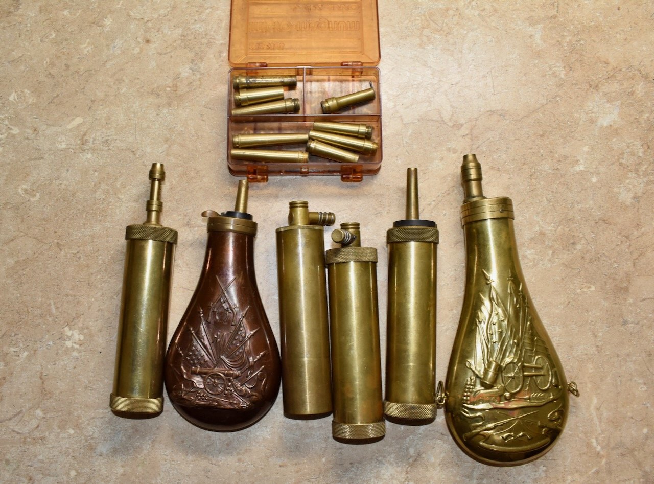

Powder Flask Spout Length
Larsen E. Pettifogger, SASS #32933 replied to Yul Lose's topic in SASS Wire
Yul what are you looking for? Measures come with a variety of spouts and pretty much all of them have the same threads except for the Walker. As noted a 30 grain spout from one vendor is not always the same length as a 30 grain from someone else. Track of the Wolf lists the spout as 30 grains. I no longer remember which spout came with it. Again what are you trying to accomplish? Some samples: -

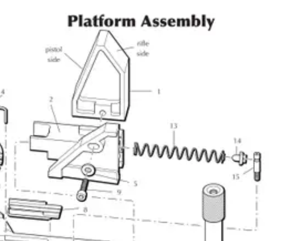

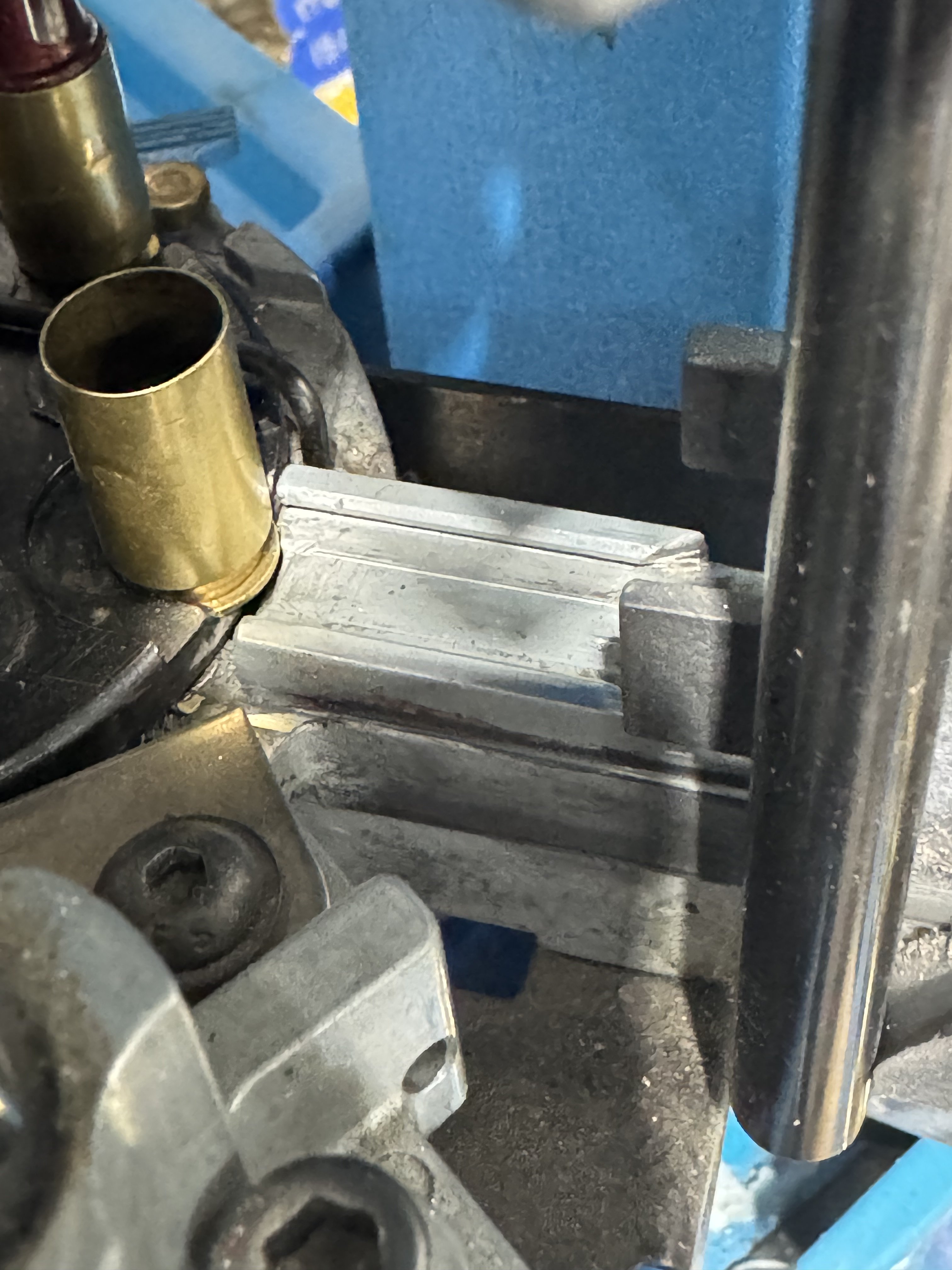

Dillon XL650 Help Please
Larsen E. Pettifogger, SASS #32933 replied to Buckshot Bear's topic in SASS Wire
If it is 20 years old the spring (13) will have lost a lot of its tension. #14 is nylon and is frequently cracked and #15 is just easy to loose. So buy all four. -

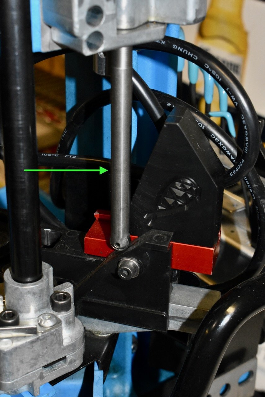

This rod is what adjusts how far the black thingy inserts the case. Screw the rod up and the case goes further into the shell plate. They are just plastic they do wear out and they are affected by dirt and lack of lube. -
