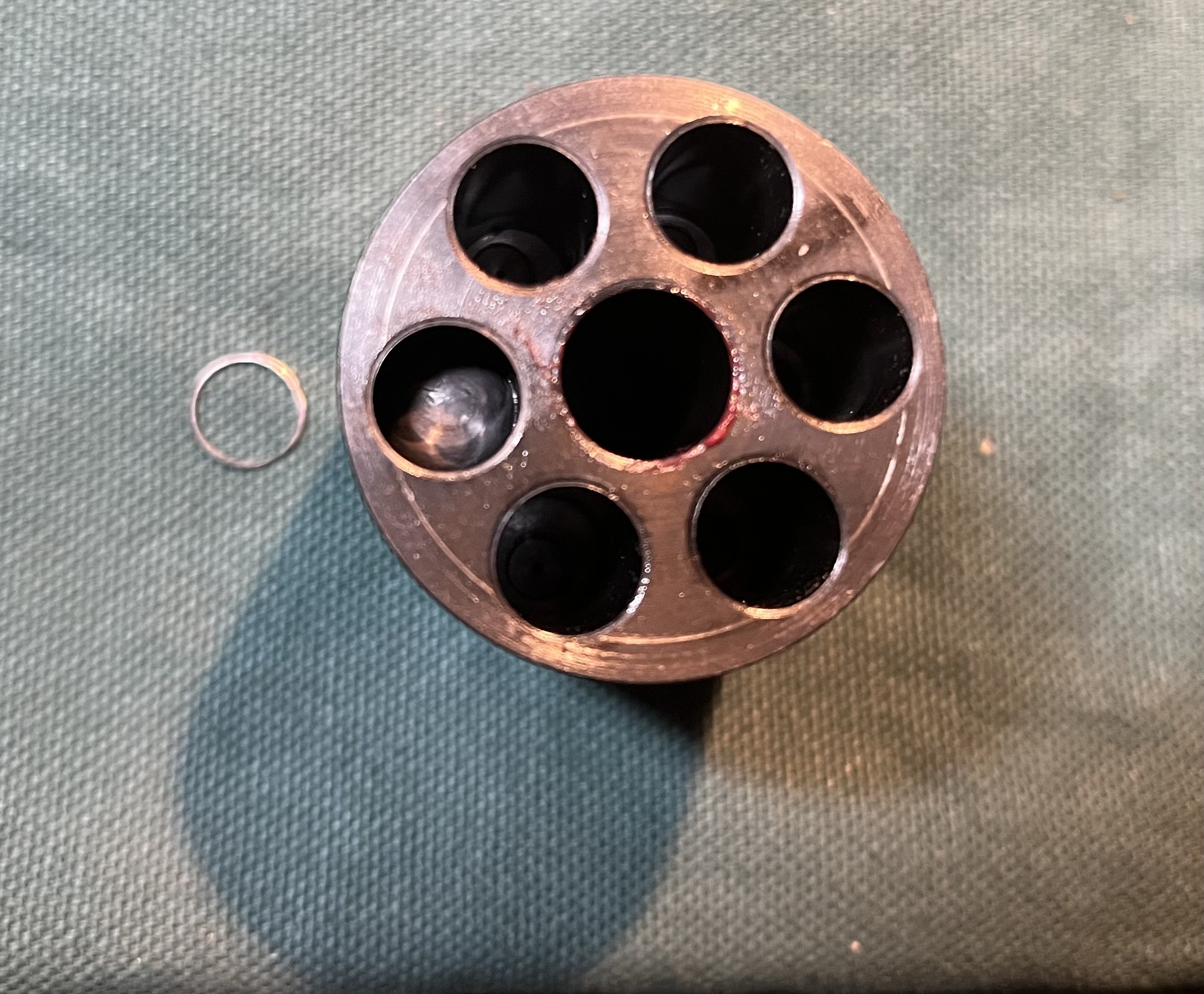

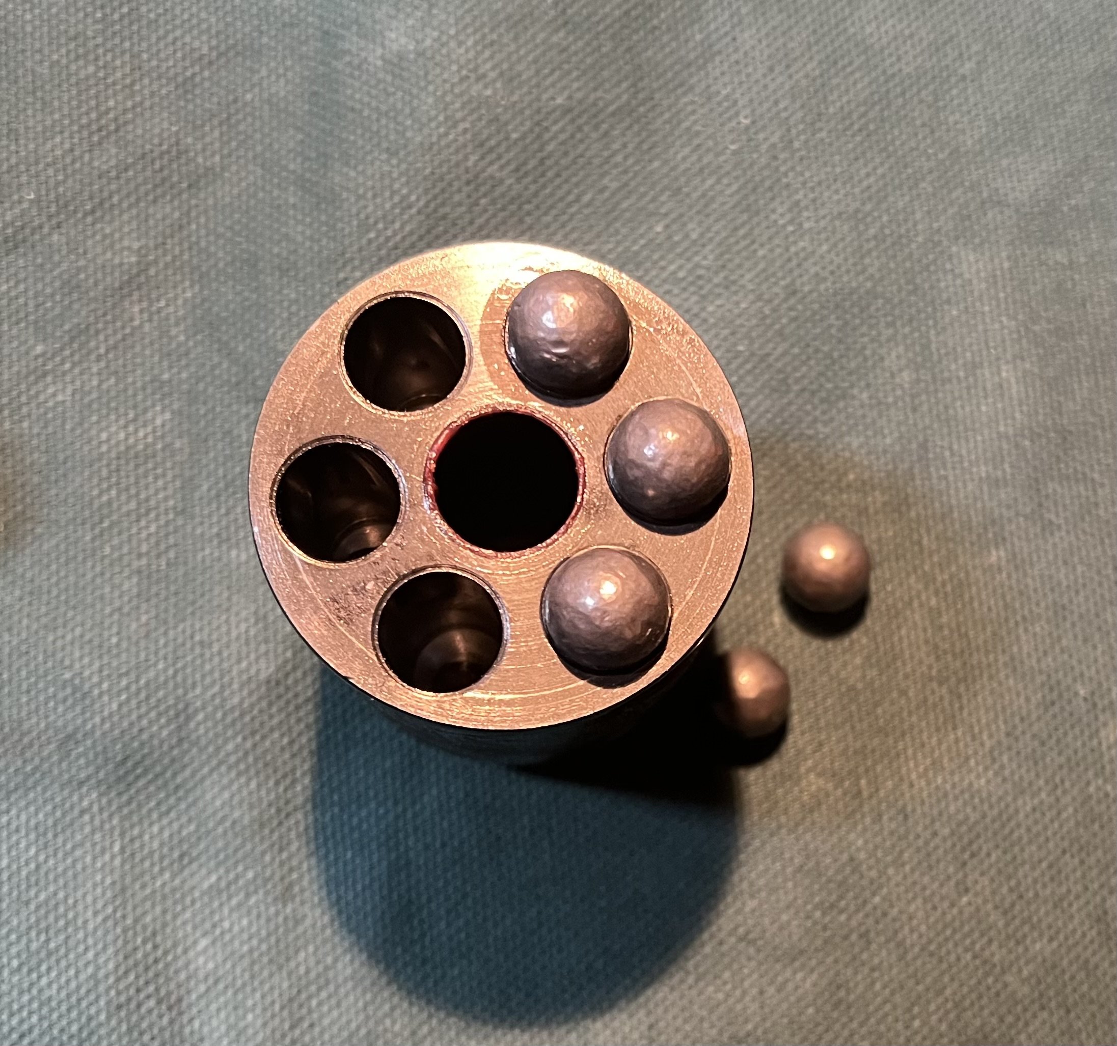

Just for you Alpo, you got me curious as well and it's cold today and it gave me something to do.

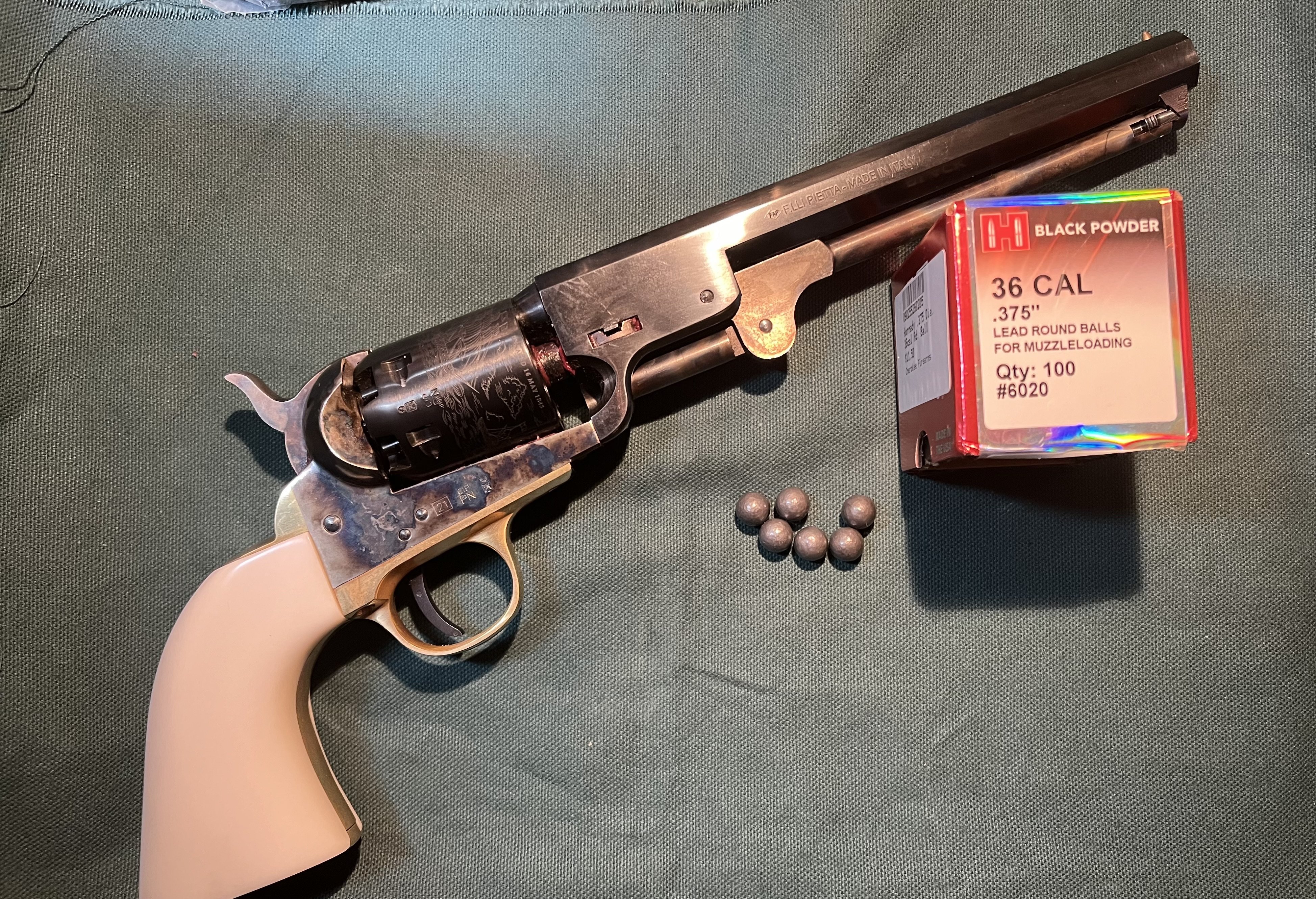

Pietta 1851, Hornady 0.375 balls

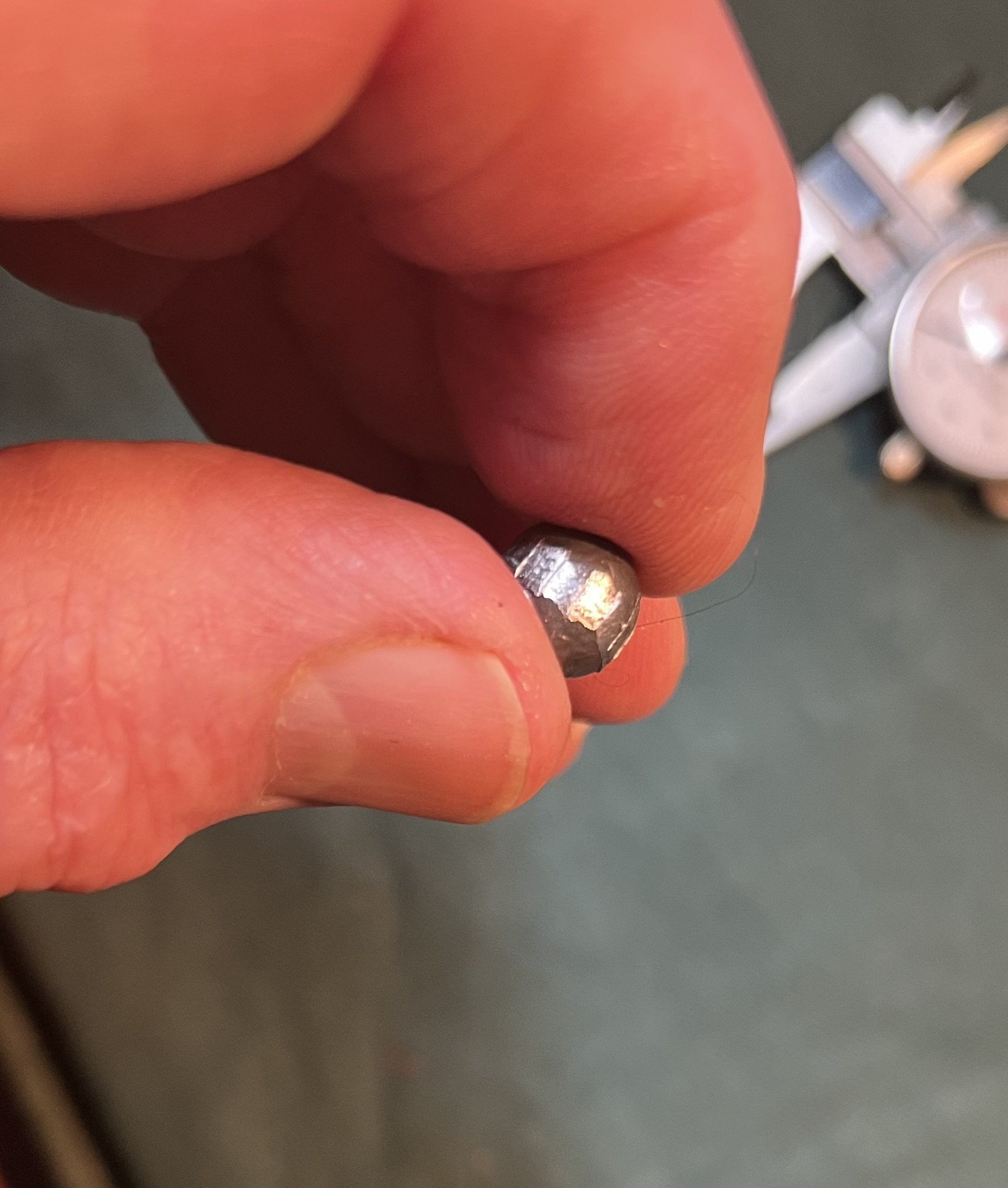

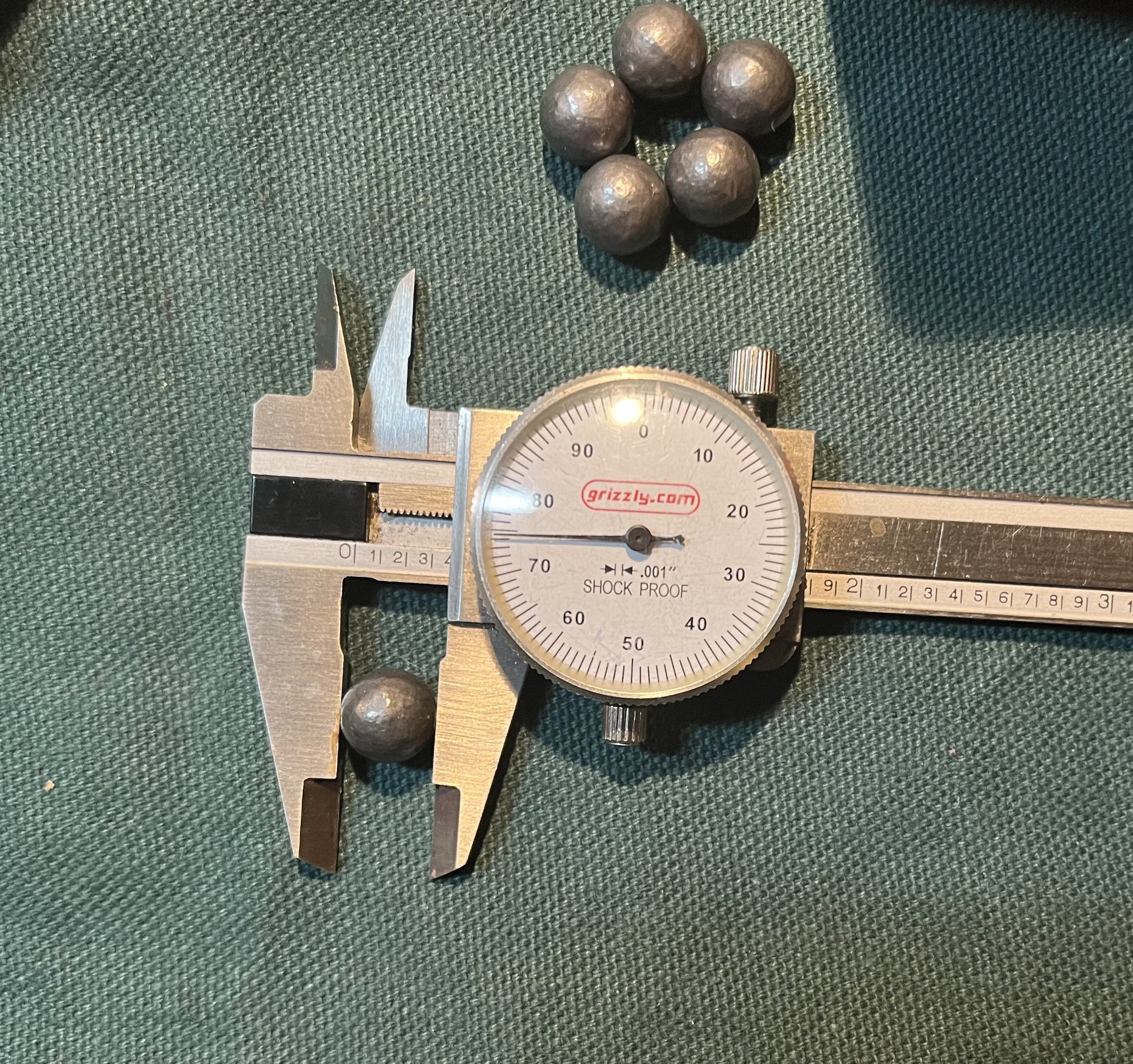

The balls appear to be 0.375 with my cheapie Grizzly.com calipers:

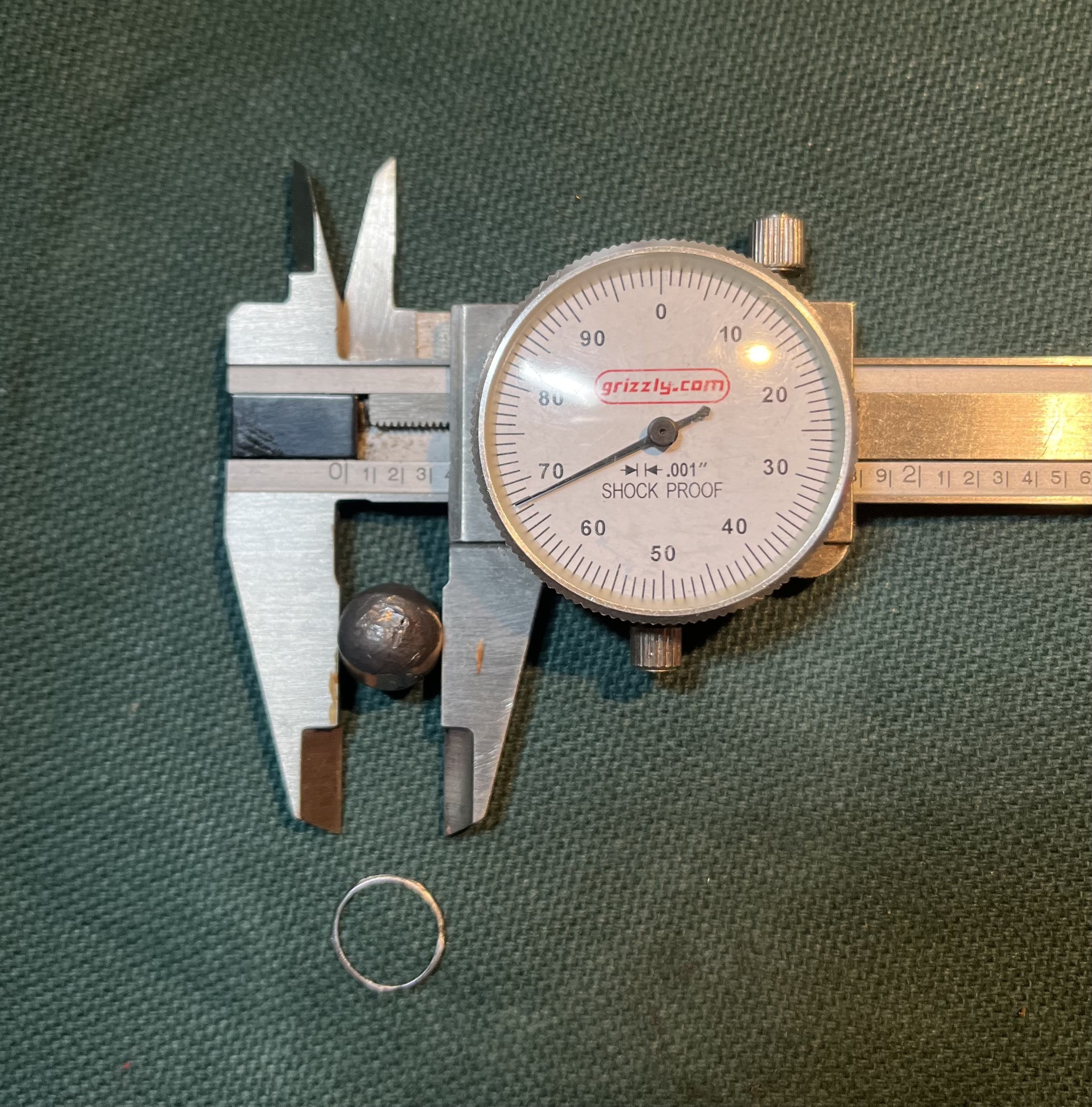

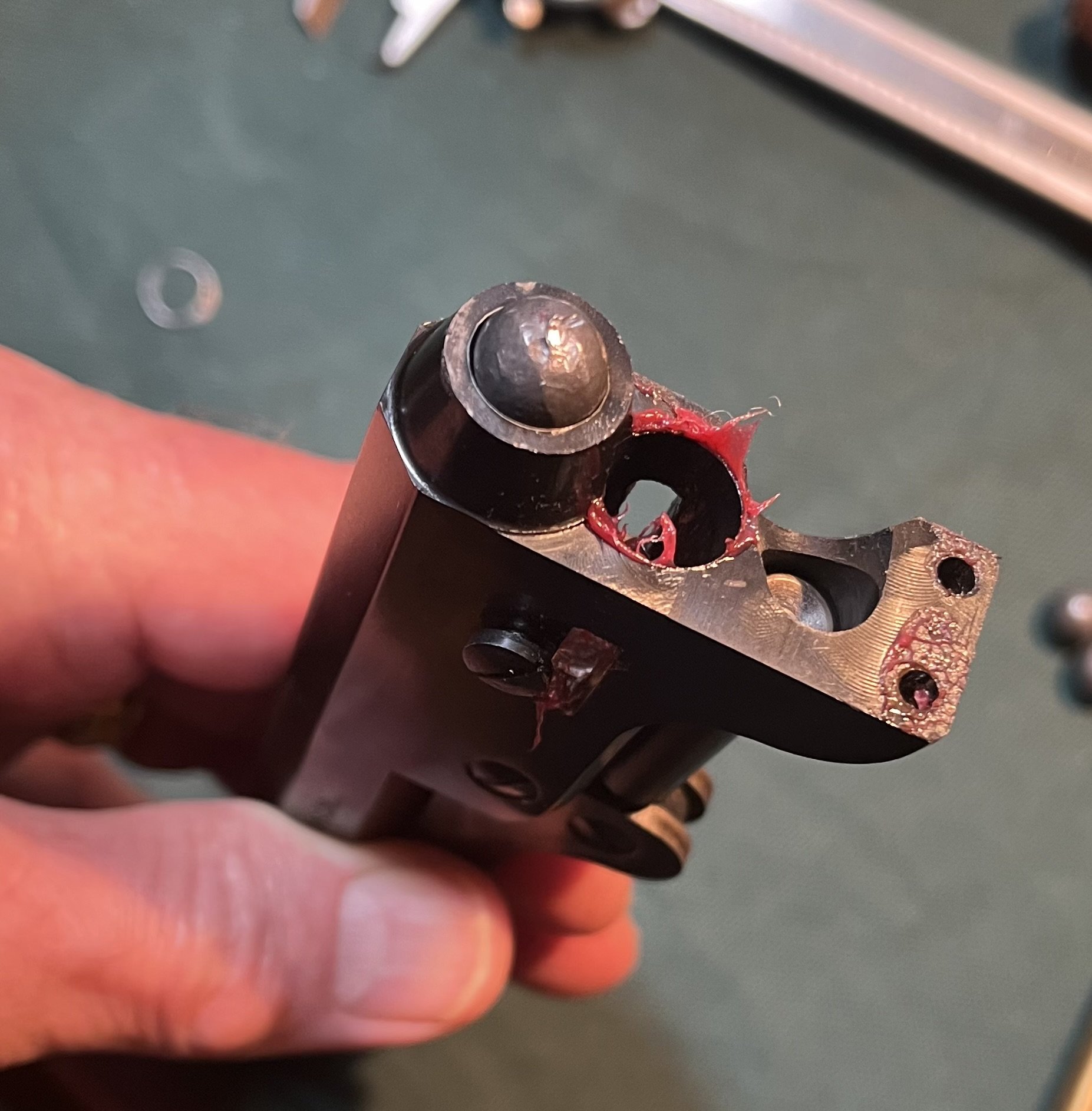

I pulled a nipple on the cylinder and seated a ball, then pushed it back out of the chamber to mike it.  It shaved a ring, and sits in the chamber at 0.368".

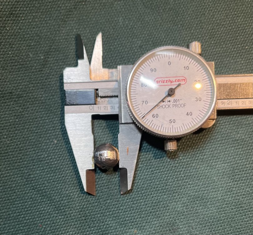

Then I put that ball into the forcing cone (it did not fall in easily), and pushed it through the 7.5" barrel, then measured the diameter across the rifling marks at 0.364".
No wonder my home cast wadcutters for .38 Special fall through the barrel easily!

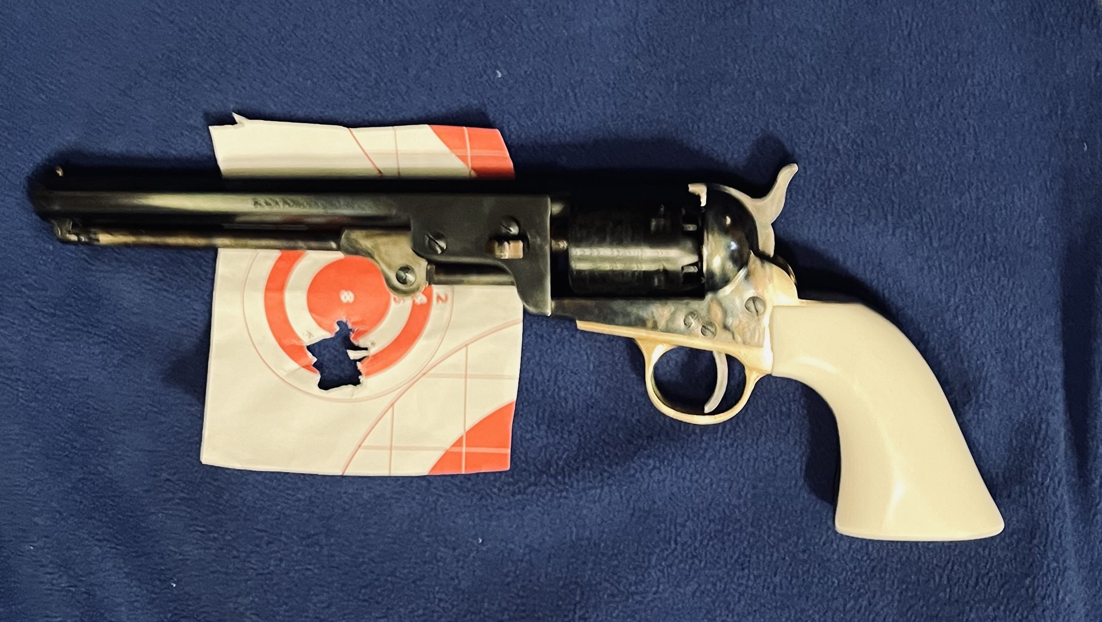

As far as Pietta accuracy; here is the first six shots I fired from this revolver when I bought it last January:  24 grains of FFG Schuetzen under these same Hornady balls at 7 yards, 6 o'clock hold on the bullseye.  I can live with this.
