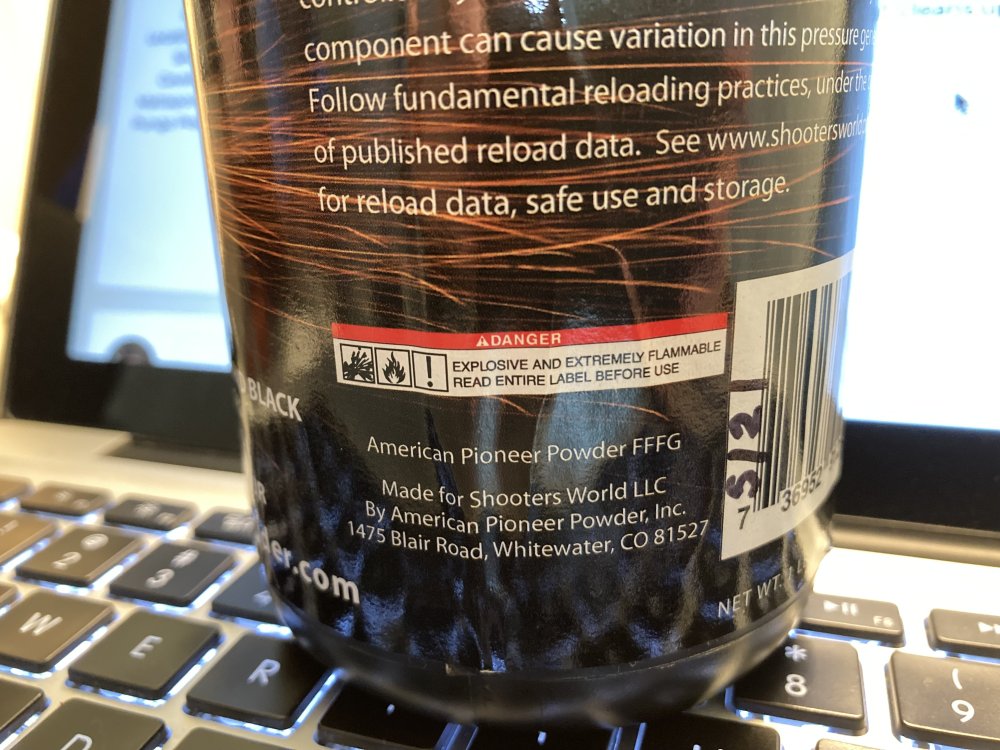

Bingo Montana Posted October 19, 2021 Posted October 19, 2021 I use it, not that I am a BP Substitute expert. The label says: American Pioneer Powder FFFG Made for Shooters World LLC By American Pioneer Powder, Inc. 1475 Blair Road, Whitewater, CO 81527 I use it for 12 GA shotgun, 45 Colt, 45 Cowboy Special, and 38 Special. Use the same loads as I did using APP 3FG with like results. Looks like APP, smokes like APP, cleans up like APP.

Scarlett Posted October 20, 2021 Posted October 20, 2021 22 hours ago, Smokin Gator SASS #29736 said: Is that closer to triple7 then the other subs? No. This is private labeled for ShootersWorld by APP. It’s the same formula as Black MZ and is actually more of a 2.5F than 3F as told to me by the owner of APP. I’m a ShootersWorld and APP distributor and introduced them to each other when SW was wanting to offer a BP sub. I will be at SE Regional this weekend and will have some with me. I don’t ship it so order from Graf’s. Hugs! Scarlett
