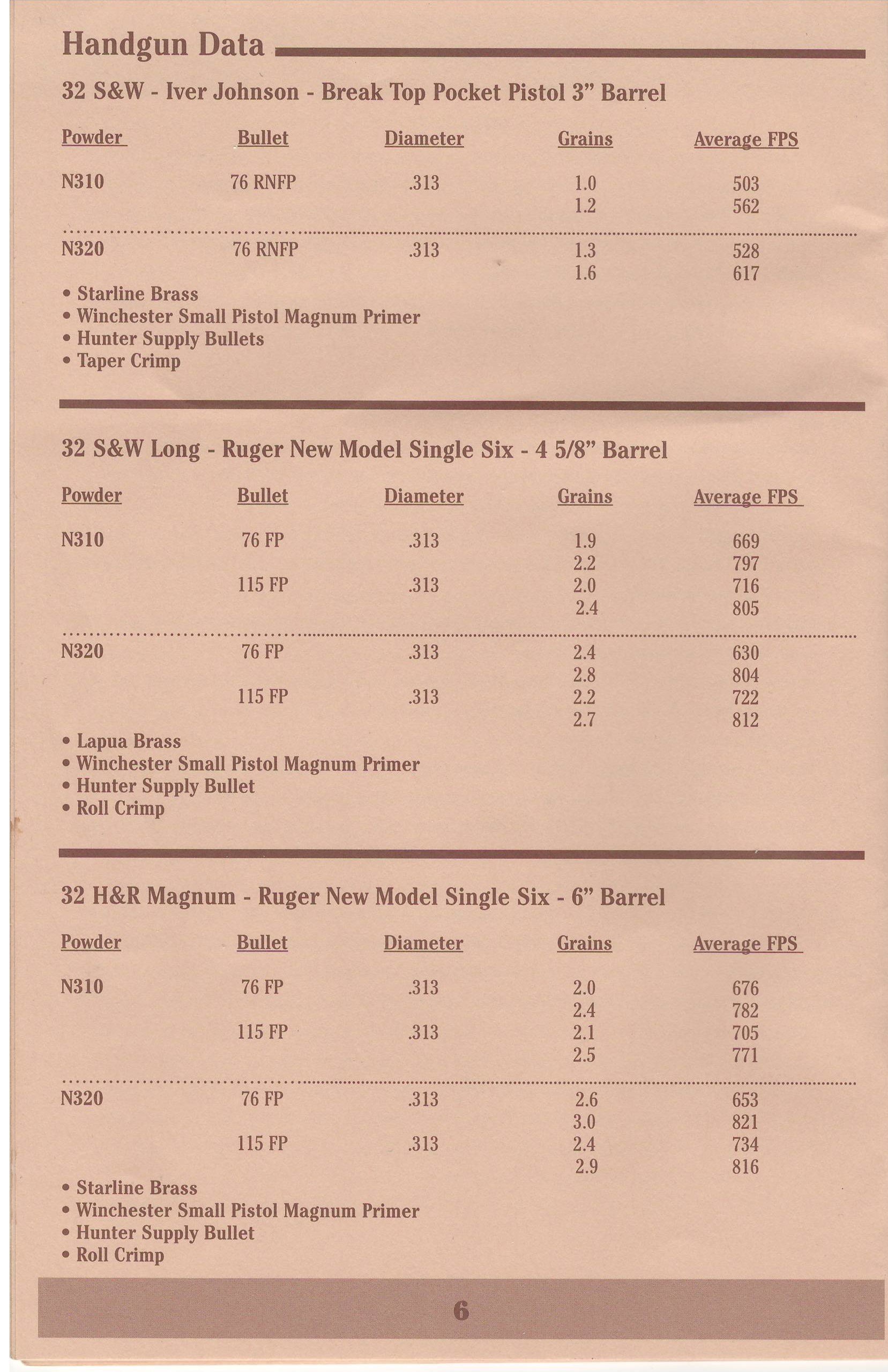

SouthwestShooter Posted October 12, 2021 Posted October 12, 2021 I decided to take the dust off the reloader and make 32s once again but can't find my formula. I was loading 78 grains with Vita Vorie 310 OR 320 ,,, I forgot which. Might anyone have a formula or suggestions! I checked the V V reloading book and no luck for cowboy loads. thanks.
Crazy Gun Barney, SASS #2428 Posted October 12, 2021 Posted October 12, 2021 32 what? S&W, long, mag?
LawMan Mark, SASS #57095L Posted October 12, 2021 Posted October 12, 2021 Doc Early lists 1.5 grains of N310 as a starting load for 32 S&W Long with an 83 grain bullet. 1.7 is max.

Arizona Deuce Posted October 13, 2021 Posted October 13, 2021 Howdy Red, This is from a 2003 VithtaVuori Cowboy manual. Hope this helps. You and Sassy take care. Deuce
Boulder Canyon Bob# 32052L Posted October 13, 2021 Posted October 13, 2021 21 hours ago, SouthwestShooter said: I decided to take the dust off the reloader and make 32s once again but can't find my formula. I was loading 78 grains with Vita Vorie 310 OR 320 ,,, I forgot which. Might anyone have a formula or suggestions! I checked the V V reloading book and no luck for cowboy loads. thanks. Check with Mike at Thunderstick, he gave me a copy of VihtaVuori Cowboy data a while back.
ORNERY OAF Posted October 13, 2021 Posted October 13, 2021 Might want to check that 78 grains.....sounds a little stout to me
SouthwestShooter Posted October 13, 2021 Author Posted October 13, 2021 thanks to you all. you're information was a great help.
