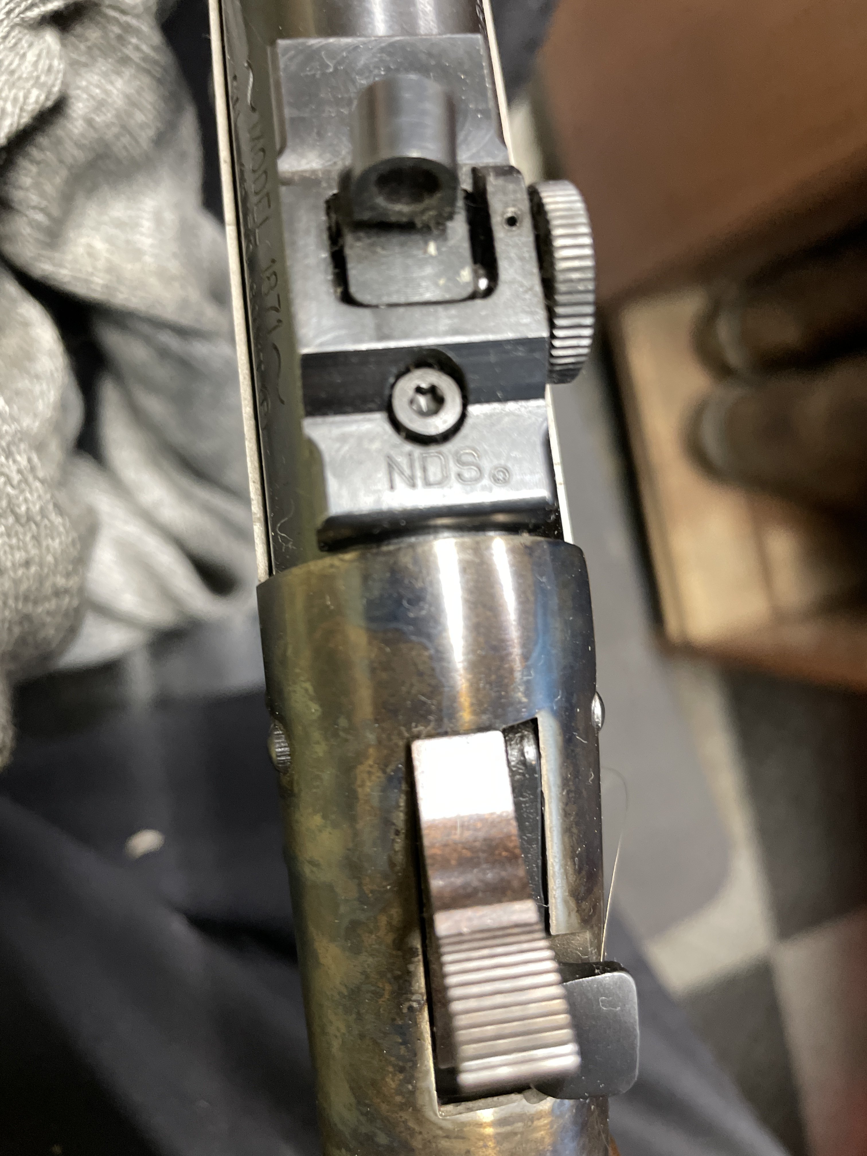

Maddog Mark Posted September 15, 2021 Posted September 15, 2021 Hey, I was told I had the wrong sight on the back of my H&R Rifle at a Plainsmen side match, But I don't know where you find any rules about it.
Edward R S Canby, SASS#59971 Posted September 15, 2021 Posted September 15, 2021 Was it a peep sight?

Colorado Coffinmaker Posted September 15, 2021 Posted September 15, 2021 If yours is a "Skinner" peep sight, then you have the wrong sight. Not SASS legal. See the reference from PaleWolf.

Maddog Mark Posted September 15, 2021 Author Posted September 15, 2021 it is a peep sight but I took the peep out of it. It's just the housing
Maddog Mark Posted September 15, 2021 Author Posted September 15, 2021 and on the barrel. I don't know what tp replace with
Prairie Dawg, SASS #50329 Posted September 15, 2021 Posted September 15, 2021 SHB Page 29: Must use a SASS legal single shot rifle firing a traditional blackpowder rifle or revolver caliber cartridge SASS legal single shot sights found under LR rifle requirements SHB Page 30: Rear sights must either be open iron sights mounted on the barrel or original style tang or stock wrist mounted peep sights. Long range rear barrel mounted sights of the flip-up ladder type may use a peephole drilled through the sliding sight leaf. An example of this is the various ladder type sights used on the Springfield trapdoors. - Bolt or receiver mounted sights are not allowed
Colorado Coffinmaker Posted September 15, 2021 Posted September 15, 2021 Regardless of what "peep" you have taken out of your sight, you still have a "Peep" Sight. It is still NOT legal in SASS. You really need to put a set of legal sights on the rifle.
Prairie Dawg, SASS #50329 Posted September 15, 2021 Posted September 15, 2021 Williams makes a blade replacement for the peep, which will make the sight legal

Sedalia Dave Posted September 16, 2021 Posted September 16, 2021 1 hour ago, Prairie Dawg, SASS #50329 said: Williams makes a blade replacement for the peep, which will make the sight legal 15 minutes ago, Maddog Mark said: Do you got a link to this sight I am hearing about? Midway USA. Williams Rear Sight Blade U Notch Aluminum Black Williams Rear Sight Blade Square Notch Aluminum Black You'll also need to buy the base that attaches to the barrel. Williams WGOS-Small Open Sight Less Blade Fits Barrel Diameter .660" to .730" Aluminum Black Williams WGOS-26mm Open Sight Less Blade Fits Barrel Diameter 1.000" to 1.100" Aluminum Black
Maddog Mark Posted September 16, 2021 Author Posted September 16, 2021 So I'm gonna use 1 of the 3 screw holes in the barrel to mount it, correct?
Sedalia Dave Posted September 16, 2021 Posted September 16, 2021 29 minutes ago, Maddog Mark said: So I'm gonna use 1 of the 3 screw holes in the barrel to mount it, correct? IIRC the Williams sight uses 2 of the three holes. What I cannot remember is the height needed for both the front and rear sights. Been too long since I owned a Handi Rifle.

Charlie MacNeil, SASS #48580 Posted September 19, 2021 Posted September 19, 2021 Question: what if one was to notch out the top of the peep thereby basically turning it into something similar to a full buckhorn sight? No dog in the fight, just idle curiosity...
