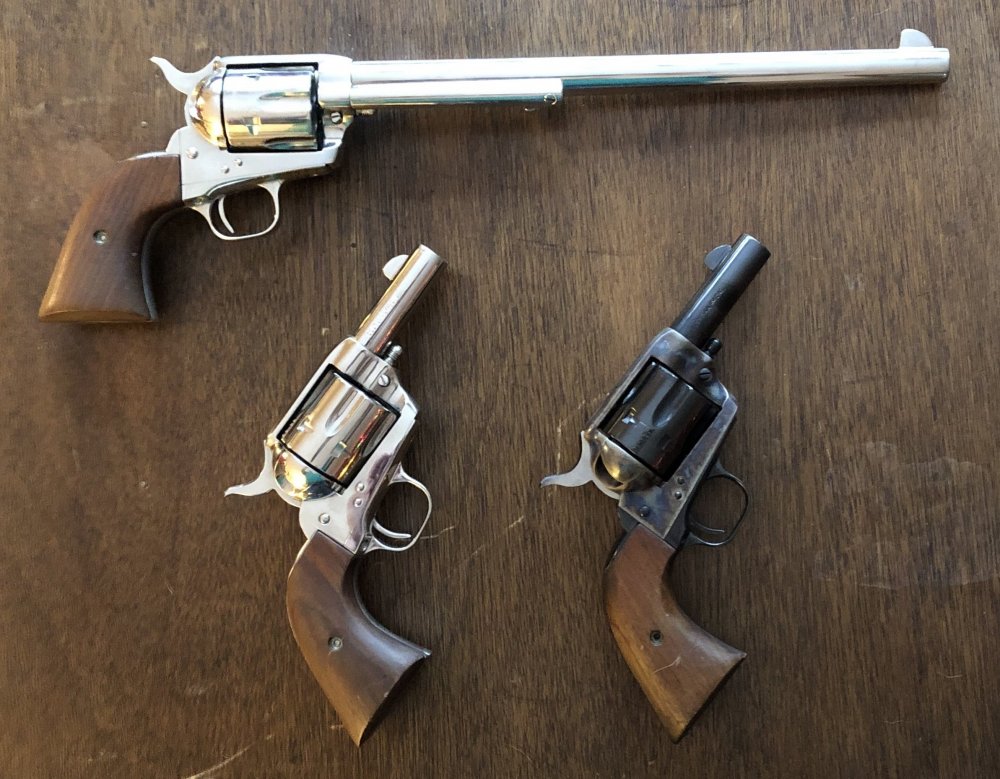

H. K. Uriah, SASS #74619 Posted June 21, 2020 Posted June 21, 2020 "No all my single actions have to be pairs now." Why? I mean, if you want them to be, sure, more power to you. But WHY to do assert that the HAVE to be pairs? I find shooting mismatched revolvers can be a lot of fun. "I need to hold a walker an a dragoon in my hands. Walkers might be too big." No argument there, Walkers ARE big. [See above video link.] But in all truth, so are Dragoons. They are only slightly smaller. Here's a Walker and a Dragoon for comparison... For scale, here's a Walker and twelve inch Colt Buntline... And for giggles, it's fun to pair the two nickeled revolvers in this picture... Pairing the two small ones is actually kinda boring...
