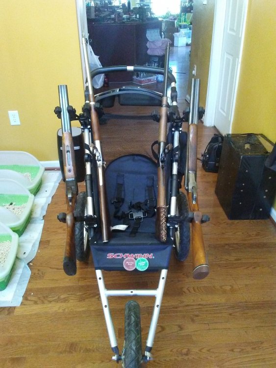

Marshal Hangtree Posted April 5, 2019 Posted April 5, 2019 I found a dirt cheap jogging stroller on Craigslist to convert into a gun cart. The Koplin clamps sold at Walmart and other places look good for gripping the barrel of your rifle, but seem too narrow to accommodate the barrels of a SxS. Any ideas for securing the barrels of a double barrel on this type of cart? Thanks y'all.

Patagonia Pete Posted April 5, 2019 Posted April 5, 2019 22 minutes ago, Marshal Hangtree said: Where did you find the plastic coated metal, Blackfoot? These will bend to any shape you want. The one on my 3-gun cart I just bent/widened to hold the sxs. http://www.classicusc.com/store/p/49-Rugged-Gear-2-Gun-Hook-Set.aspx
Boomstick Bruce Posted April 5, 2019 Posted April 5, 2019 I use the kolpin on my stroller cart, works fine. Do not buy the eBay/Amazon knock offs! They will break trying to flex them for the double, the kolpin is more flexible and works well.

Mo Likka Posted April 5, 2019 Posted April 5, 2019 I have a stroller cart with the Kolpin mounts and cut out the rubber teeth on the one for the shotgun. I used a Sawzall type saw to cut it.

Boomstick Bruce Posted April 6, 2019 Posted April 6, 2019 2 hours ago, Texas Lizard said: Rugged gear... Home Shooting Carts Shooting Cart Accessories Texas Lizard Not everyone can afford a $300 cart to haul their guns... others, like me, just can't justify the cost... I paid $25 for my Schwinn stroller and $55 for both sets of gun mounts and I still think it was too much... besides, ive seen two rugged gear carts go over when that front wheel caught a rut... the only thing about my set up is it holds the guns at about a 45 degree angle so I'm staring down the barrels when I'm pushing it to the next stage... its a little unnerving and I don't think I'll ever get used to it...
