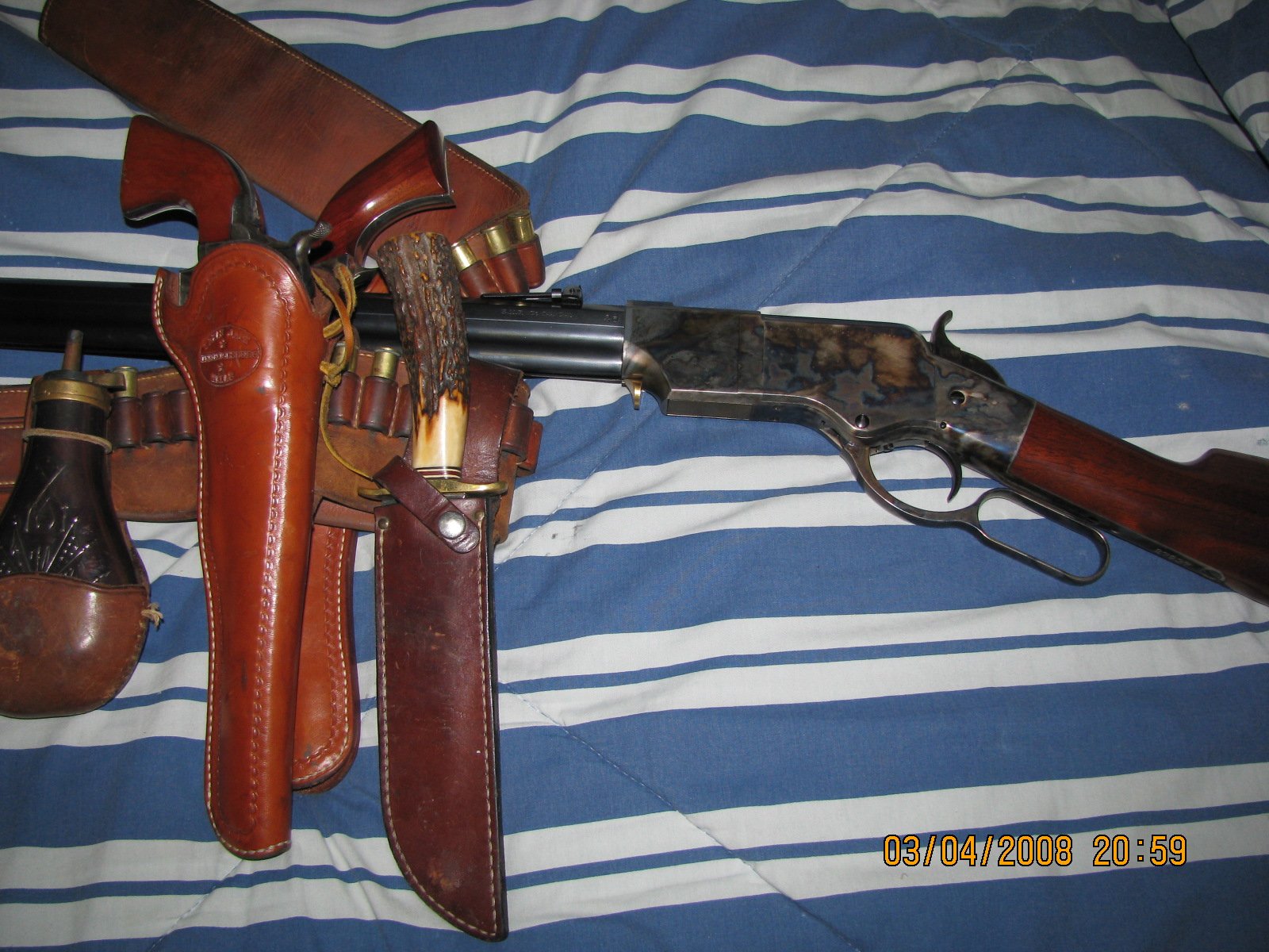

Around my hips. The wife drew the line at leaving the guns in the holsters at bed time... with or without the chaps... 0
