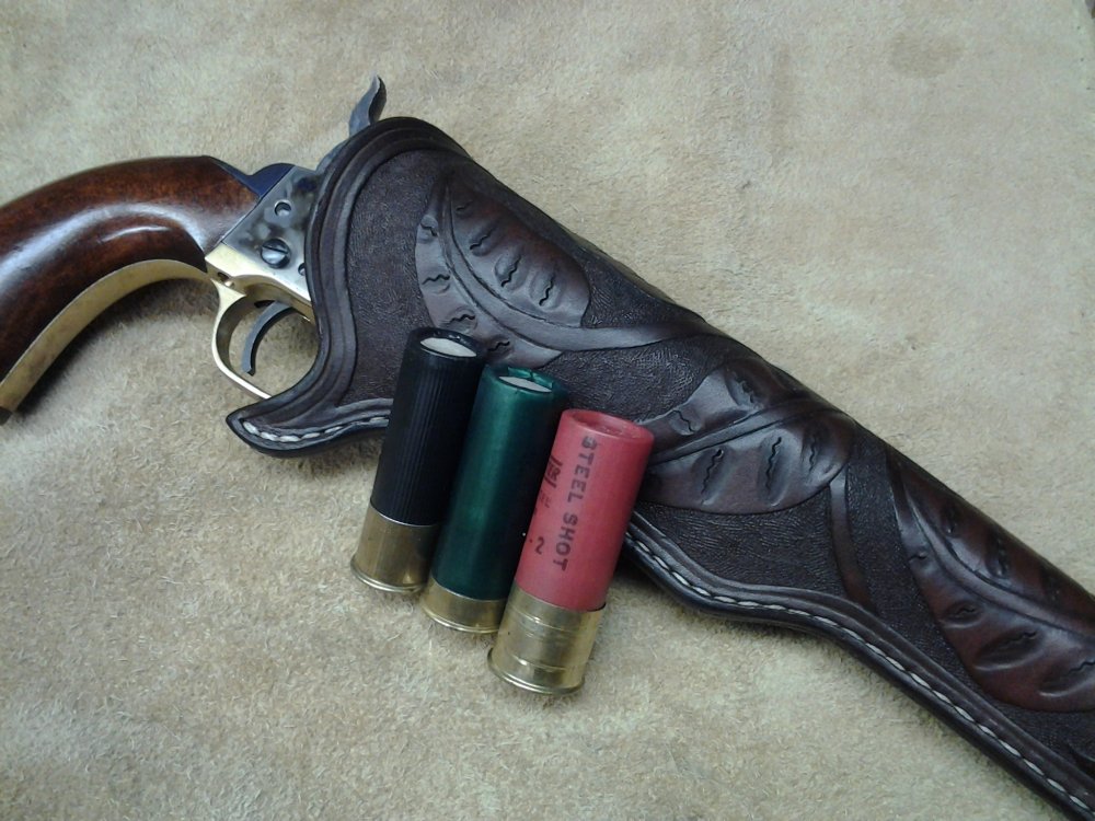

Lucky R. K. Posted January 11, 2021 Posted January 11, 2021 On 1/9/2021 at 10:15 PM, Randy Saint Eagle, SASS # 64903 said: I have never tried a roll crimp but just ordered everything from Ballistic Products to try it. Unfortunately they are running 10-14 days to process and ship an order right now. Randy Randy, I have used the Ballistic Products roll crimp tools for some time with good results. Here is a picture of examples in 16, 12, and 10 gauge. Lucky

Jabez Cowboy,SASS # 50129 Posted January 11, 2021 Posted January 11, 2021 Looks like that just may be a Navy Gripped Open-Top .... Ya must be a fine gentleman Ya got a Sweet 16 ... Jabez Cowboy
