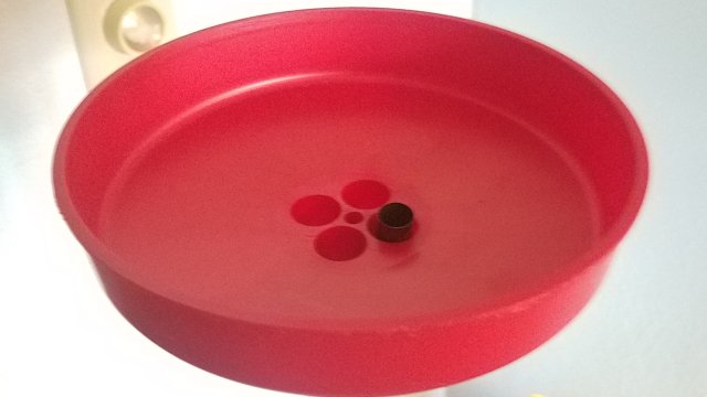

Warden Callaway Posted April 12, 2021 Author Posted April 12, 2021 Browsing around, I came up with another Lee APP press video. The thing that makes this one worth watching is he has a blue dish correlator. I don't see that he mentioned where he got it. Looks like it works well.
Yusta B. Posted May 3, 2021 Posted May 3, 2021 On 4/12/2021 at 4:56 PM, Warden Callaway said: I don't see that he mentioned where he got it. Looks like it works well. He said in the comments that he made it.
