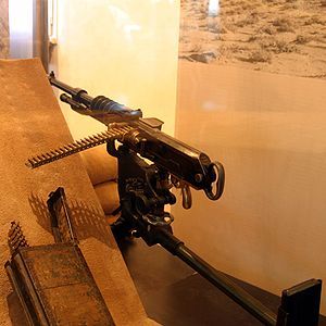

Lightfoot Posted July 16, 2012 Posted July 16, 2012 check this link; http://en.wikipedia.org/wiki/Hotchkiss_M1914_machine_gun http://i181.photobucket.com/albums/x57/k7grc/Inventory/300px-Musee-de-lArmee-IMG_1026.jpg
Dustin Checotah Posted July 17, 2012 Posted July 17, 2012 Yep, that's it. Mine seems to be broken in half. What firearm were these used for? Just curious. Doc Doc Mine are for a French Hochkiss machine gun although I bought them to use in a Lebel carbine. Dustin
Captain Long Story, US Cavalry Posted July 17, 2012 Posted July 17, 2012 The Model 1922 Hotchkiss was offered in 7.92x57mm and also has a variant that used stripper clips (15, 24 &30 rd), with some recently recovered in Afghanistan. http://world.guns.ru/machine/fr/hotchkiss-m1922-e.html http://www.thefirearmblog.com/blog/2009/12/05/hotchkiss-model-1922-lmg-found-in-afghanistan/ http://www.armasizarra.com/product.php?id_product=421&id_lang=1 Considering that the Czechs used it post-WWI, it's easy enough to see why it would be loaded with German WWI surplus cartridges. Probably captured from some second-line unit in France and shipped home by a G.I.
