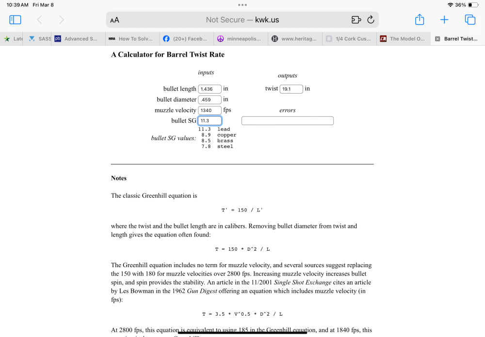

Uriah, SASS # 53822 Posted March 8, 2024 Posted March 8, 2024 Snuffy, The twist rate on your barrel is indeed marginal. Do you have any lighter bullets you can try? http://kwk.us/twist.html I am always amazed at the Quigley, the bucket, you can hear the unstable bullets going down range. Wow wow wow wow etc. And they hit! Uriah
