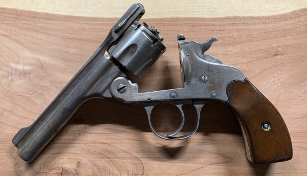

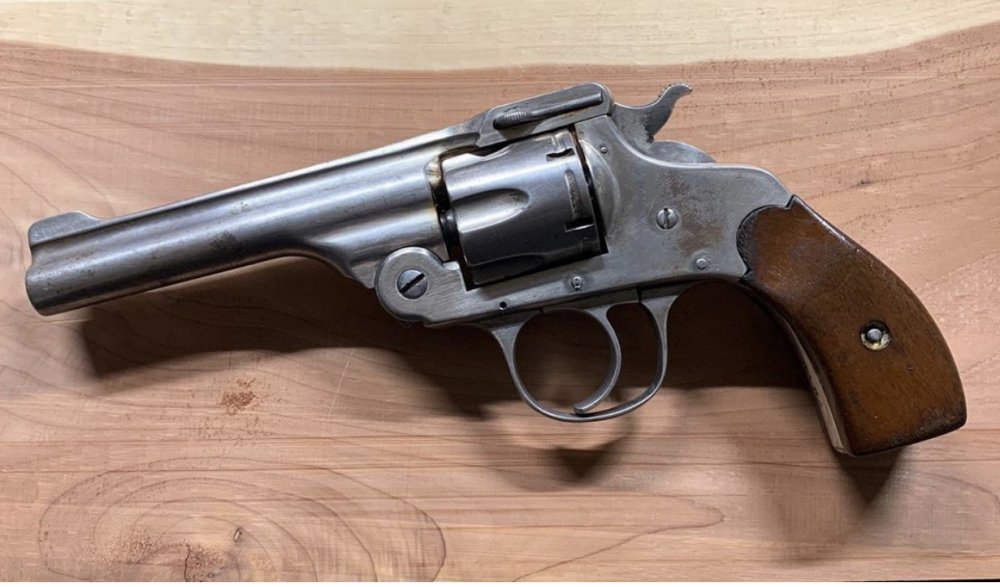

Rube Burrows Posted February 20, 2021 Posted February 20, 2021 I am looking to purchase an old Hopkins & Allen Safety Police Top Break Revolver like the one pictured here. I mostly need a firing pin but would gladly take a parts gun or another working gun that I may use for parts. The one in my photos was carried by my grandmother in her purse for many years so it has sentimental value for me. I lost the firing pin many years ago and have tried all the usual places to find one but no luck. It will say Safety Police on the top strap along with the patent date info. Thanks you.

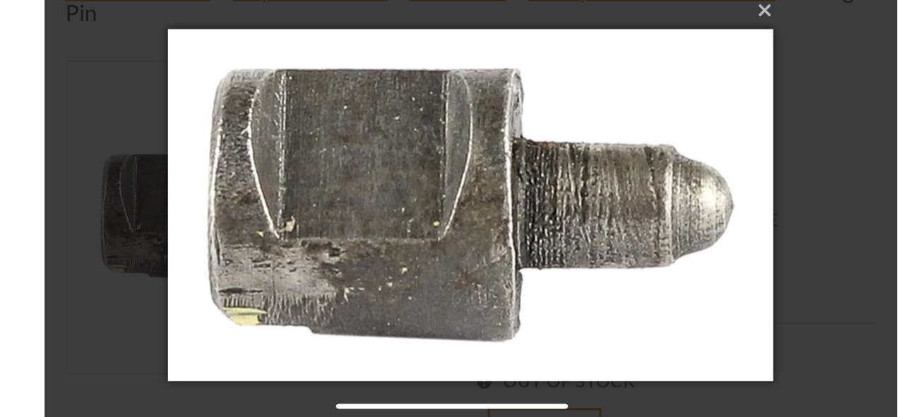

Rube Burrows Posted April 2, 2021 Author Posted April 2, 2021 Still looking for a firing pin for one of these. I have tried every place I know. here is what the firing pin looks like.
Snakebite Posted April 2, 2021 Posted April 2, 2021 Any decent machinest should be able to make you one. You would most likely need to harden it before installing.

Muley Gil SASS # 57795 Posted April 10, 2021 Posted April 10, 2021 On 2/21/2021 at 12:01 PM, Rube Burrows said: Hadn’t heard of them before. I’ll check. Thanks I have made pins using the "poor man's lathe": a good quality 3/8" portable drill held sideways in a vise. Using numbered drill bits, determine the diameter of the firing pin body. Buy an oversize grade 8 bolt or screw and cut off the head. Chuck the screw in your drill, set a low speed and use a good file to get the screw to the diameter to fit in the firing pin channel. Repeat to get the proper size of the point of the pin. Check the size often. It is much easier to remove metal than it is to replace metal. It will take you a while, but it can be done.
Rube Burrows Posted April 10, 2021 Author Posted April 10, 2021 I finally found a gunsmith in my area who has enough knowledge and skill to make a pin for it. I will drop it off sometime next week. Most gunsmiths around here don't seem to do any machining.
