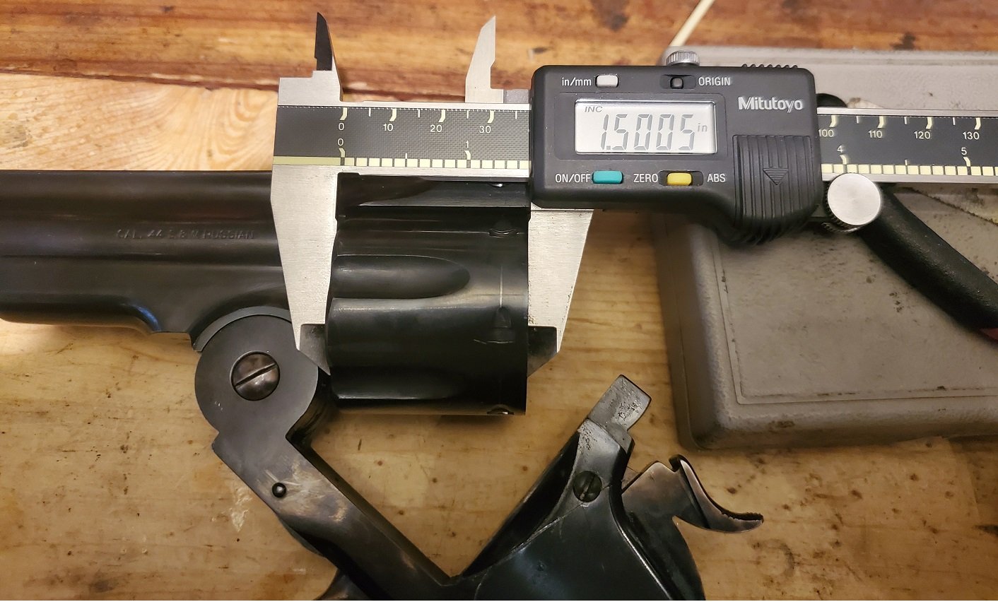

Three Foot Johnson Posted August 30, 2020 Posted August 30, 2020 I need a measurement - Uberti lists their #3 Russian in .44 Russian and .45 Colt, and I'm trying to settle an argument that they are produced on the same frame and not two different frame sizes. The cylinder is so short that a normal 1.6" OAL .45 Colt will stick out the end of the cylinder by .036", so the bullet would have to be seated deeper.

Three Foot Johnson Posted August 31, 2020 Author Posted August 31, 2020 This is odd. I sent an inquiry to Uberti asking how the .45 Colt could be chambered in this frame. They replied that the cylinders of of the .44 Russian and .45 Colt are the same length (1.57"), and the OAL of a .45 is 1.60". Less the .060" rim, that makes it 1.54" from the front of the rim to the end of the bullet, which would work. The problem is, all three of my .44 cylinders are 1.500+", so if the .45 cylinder is the same length, that leaves .040" of a .45 bullet sticking out of the chamber. Something isn't adding up here.
