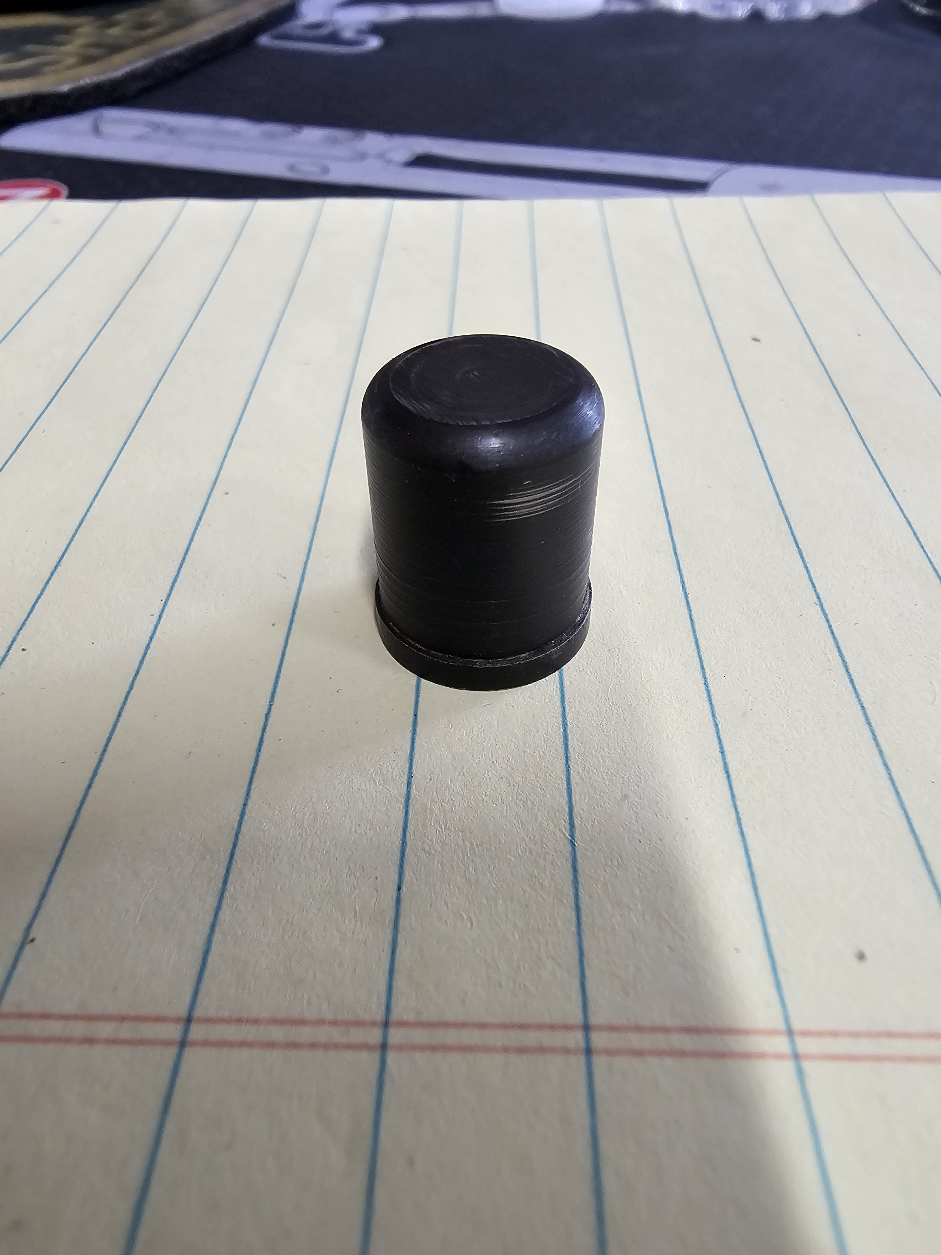

So I managed to get the stuck follower out by inverting the gun forcefully and letting it slam against the end of the tube several time until it popped out. Upon closer inspection I saw that it was getting hung up on the pin that secures the magazine to the front sight band. It protruded enough into the magazine that the edge of the follower would not clear it. I measured the two and found the stuck one was a couple of thousandths larger in diameter. I was also less nicely finished than the one that works and slightly worn. -

Just before I read your post that thought came into my head. I think that is the most likely reason the "first" follower won't slide out. I guess I could just leave it in for now and the next time I take the receiver down for cleaning I could remove the mag tube and tap it out. -

Getting my guns ready for the Four Corners Regional at the end of the month. My 1866 carbine is in 38-40 and I only shoot black powder in it. I have shot it several times before always loading 10 rounds, no problem. I decided to take out the magazine spring and follower to clean the tube. I had not done this previously. So, I removed the plug screw and spring, tilted the carbine and the follower came out. Put a light in the receiver end to check and could barely see the light.. Tilted the gun and heard a clink at the muzzle end. There is what looks like another follower, but it won't slide past the threads for the plug. It will, however slide freely inside the magazine tube. I assume when the gun was assembled the worker forgot they inserted a follower and put another one in? Doesn't seem to affect the functioning, but I would like to remove the part, just don't want to damage the threads.
