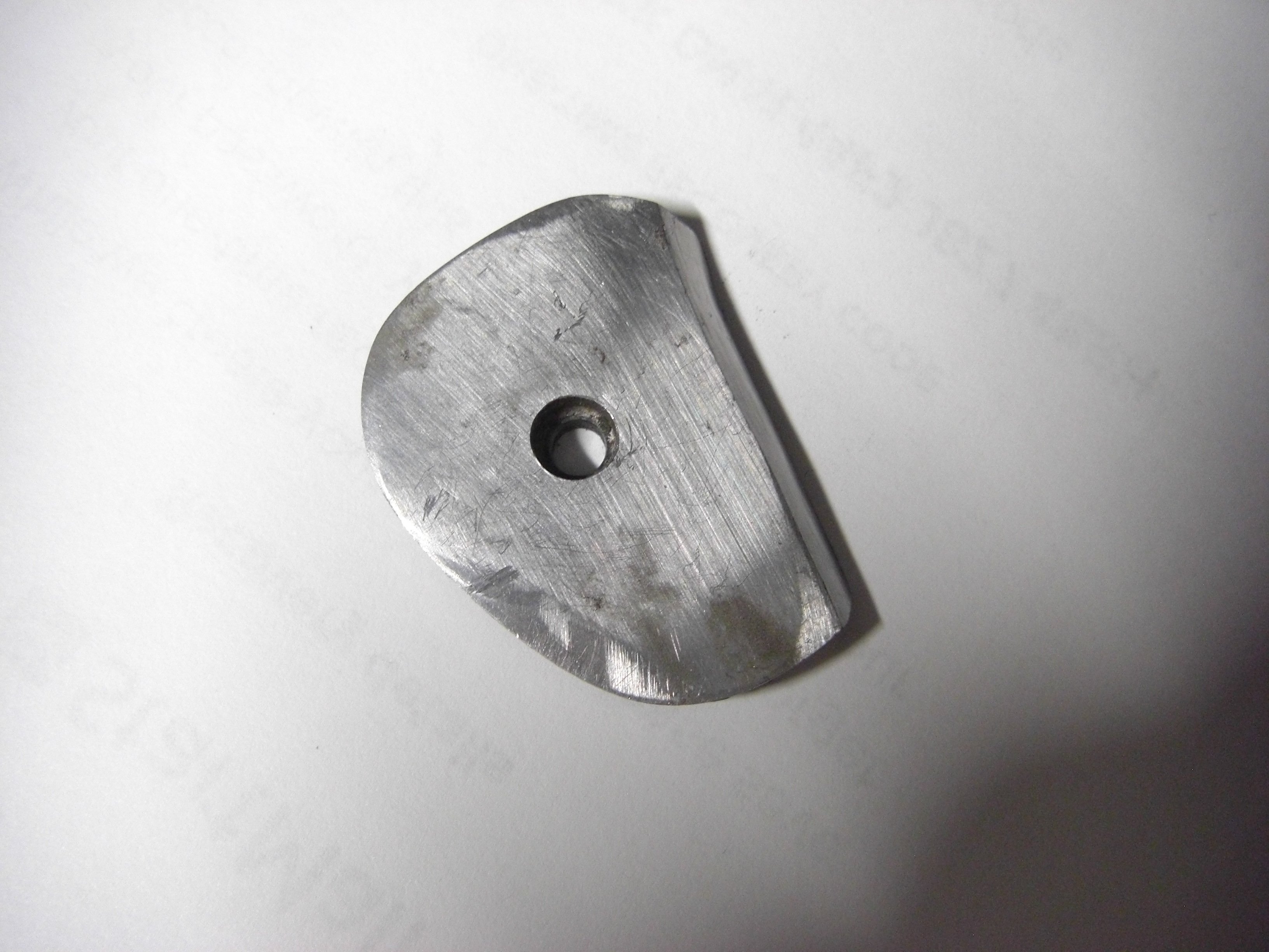

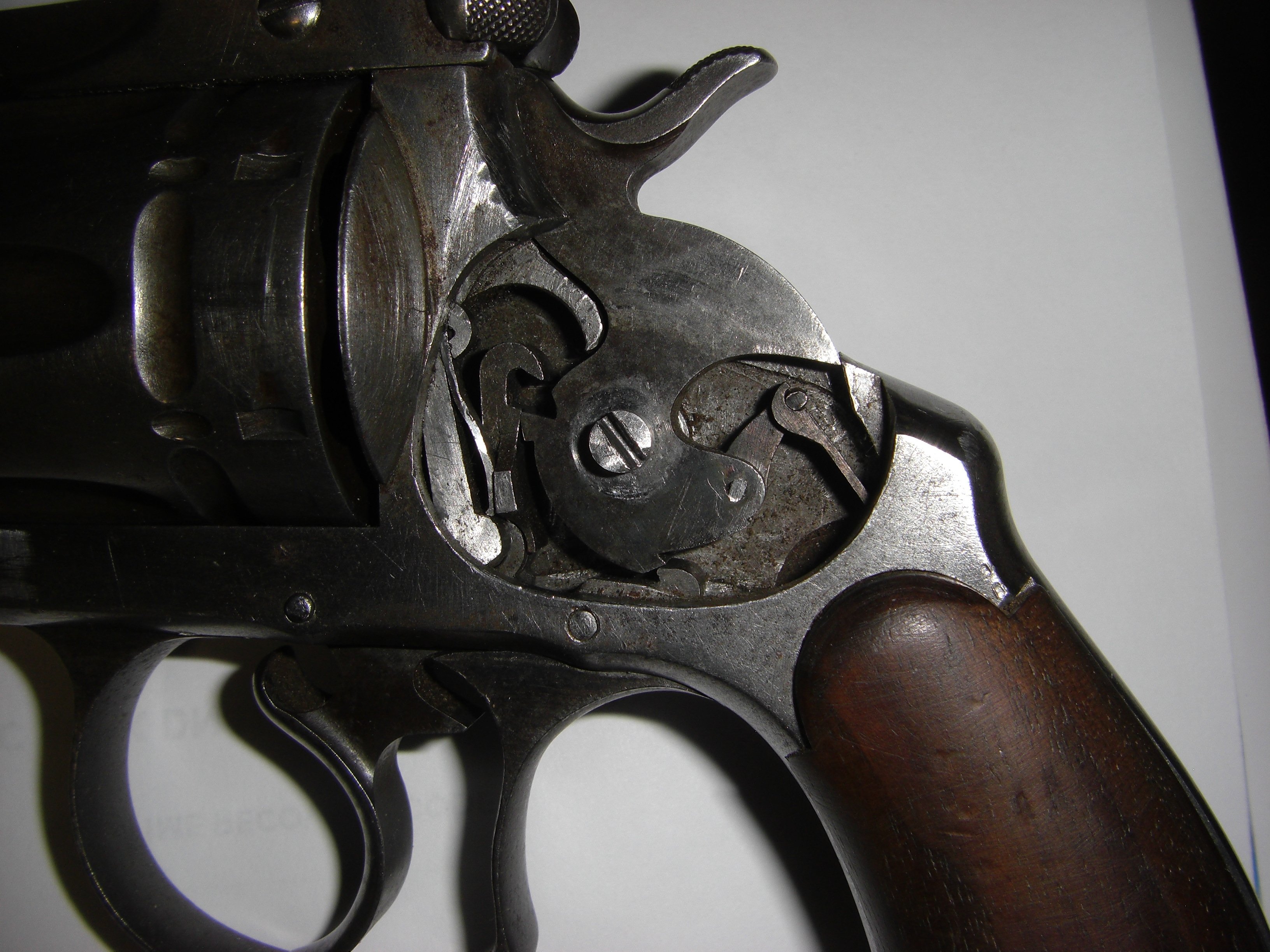

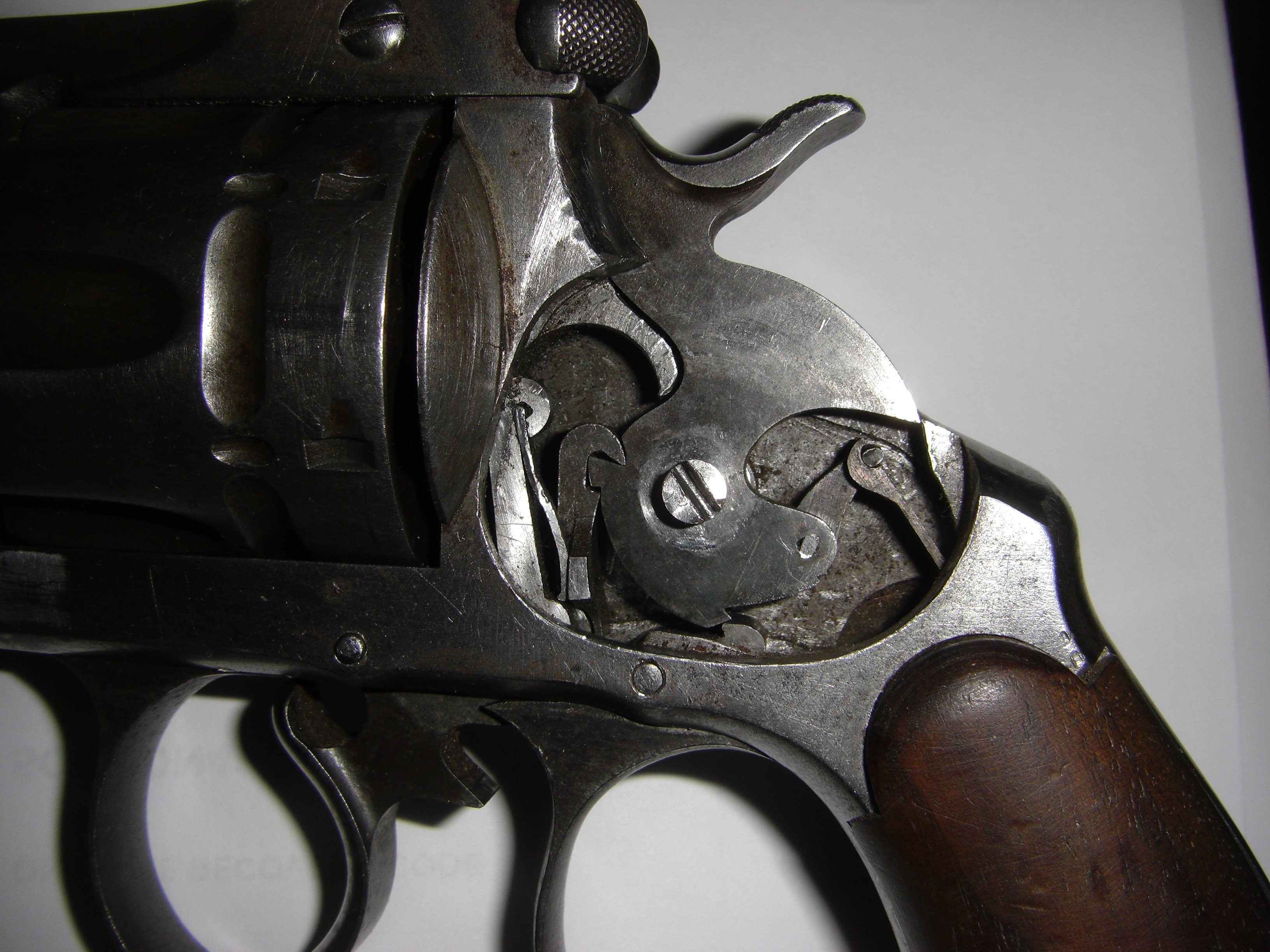

  4. I have an original S&W Breaktop in .44 Russian double action. Is there anyone, besides Chicoine, Gunsmithing Guns of the old west, familiar with it? Mine will not cock on single action as it appears not to catch on the sear (depth shallow) but will rotate the cylinder and fire on double action but does not return the trigger until I pull the slightly to the rear. Someone has removed the sideplate and polished it and probably filed some of it as the plate is loose (which normally is press fit and solid on S&Ws and usually requires a significant tap to loosen for removal) .  With the side plate removed and the hammer pin installed and tight, I can see some play in the assembly.. Since side plates where generally machined and matched to the specific revolver is it possible to find a new sideplate from a Uberti S&W 3 and fit it to tighten it up?
    I'm afraid to do any filing on the sear or hammer hooks until I can seat a side plate without play.
    I do have Chicoine's book.
    I'm attaching images of the side plate, hammer/sear after firing (trigger not reset) and after slight draw on hammer allowing trigger reset.
    FL
