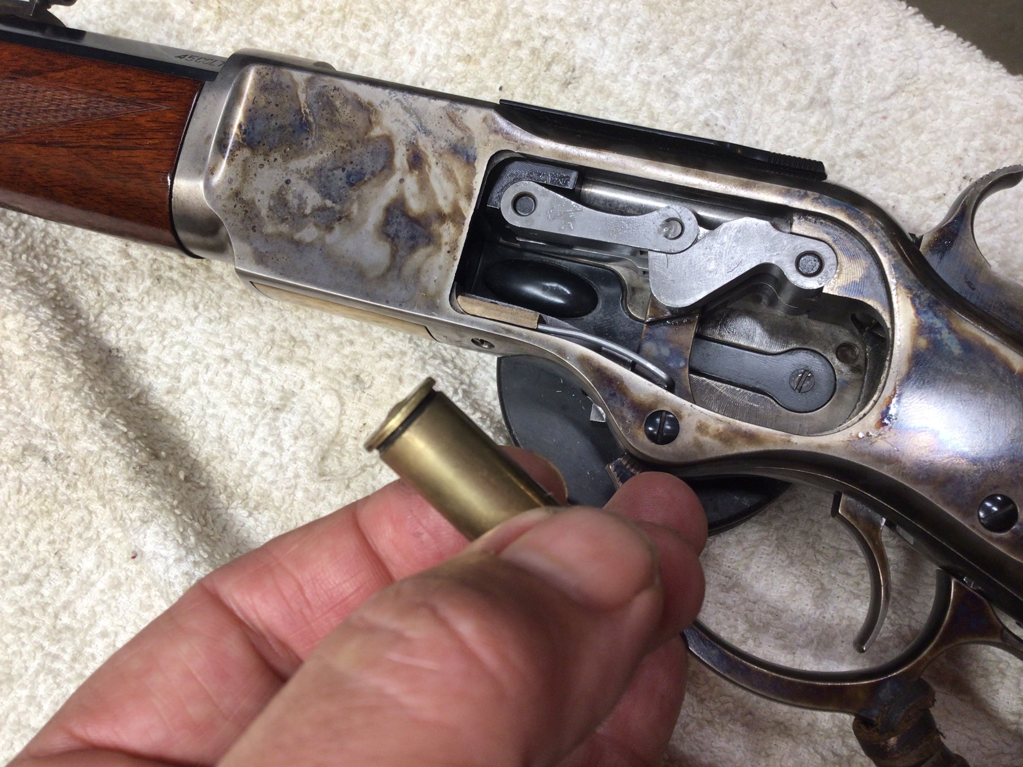

i just boight a 73 that someone slicked up.  Im guessing its a pioneer short stroke with bunch of aftermarket springs.  Gun looks new. 45 colt.
  I partially sized a spent case and partially extracted the primer.  Then i chambered the round to seat the primer.  The primer after chambering sticks out of the case 0. 020”
anyone have any suggestions?
i like idea of fixing it myself without throwing money at it
Pic of primer protrusion
I switched the short stroke kit into another 73 and it just changed the problem to the other rifle
Edited by Nickle
Yep, swapping the short stroke links over to another gun and seeing excessive headspace on THAT gun is an excellent test!  You have extra headspace.
I'd email Will Shootem (Joe Alves) at Pioneer Gunworks and let him know you need longer links for one of his short strokes.  You may have enough measurements already to tell him what extra length you need to close up the gap to around 0.005" of headspace between bolt face and  case head when chambered.   good luck, GJ.

I have made contact after i posted here though with a local gunsmith who recomends tig welding bolt face and milling down.  He quoted $50 so seems like cheest fastest option so im planning on going in that direction.
 Headspace seems to be a problem with used cowboy guns especially old henrys. I went to a gunshop that i knew had three 1860s plus 66s. These where 44/40s and 38.  I took headspace tools for those cartridges and sure enough the henry that i was going to buy had a bunch of headspace.
i wanted 45 anyway but i didnt take any headspace equipement for 45 becuase i didnt know they had any up there.  I ended up buying two 73s in 45.  One brand new and the other slightly used but built cowboy action gun and sure enough big headspace problem
The search function on this forum is clumsy and weak, and although some workarounds exist, the forum software ought to do better. So, no, I don't think you will get griped at about not "just doing a search," but posting instead.
Be aware that welding and re-cutting the bolt face will mean a longer firing pin is needed.  And maybe a non-standard extractor, too, unless the work is planned out real well.  "Stretching" the links (or making a larger knob on the forward link) is something that gunsmiths often do (welding and relocating the link's pin locations or shaping a new bearing surface on the forward link) which just moves the whole bolt forward a tad to close up headspace.  Meaning a replacement bolt should just drop in without work. You can read about that in David Chicoine's book "Gunsmithing Guns of the Old West" (available on used book market, and well worth it if you ever want to know the innards of one of our guns).
