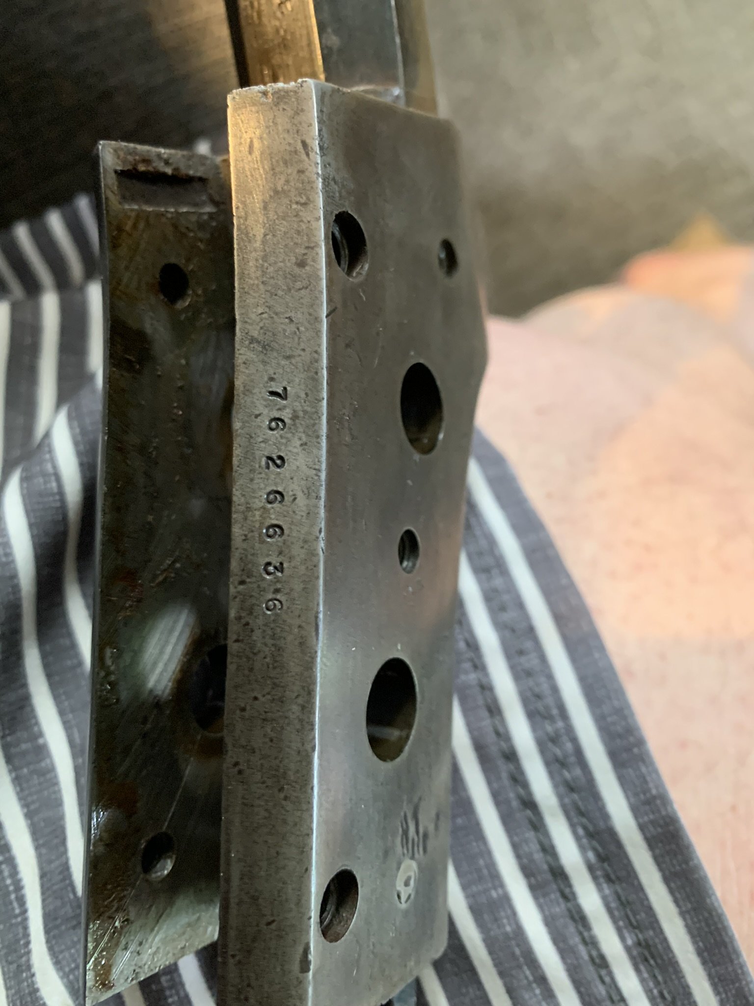

I am hoping you can help figure out some info on a rolling block rifle I just purchased.
It is a rolling block that is chambered in 38-55. It came with about 300 long brass.

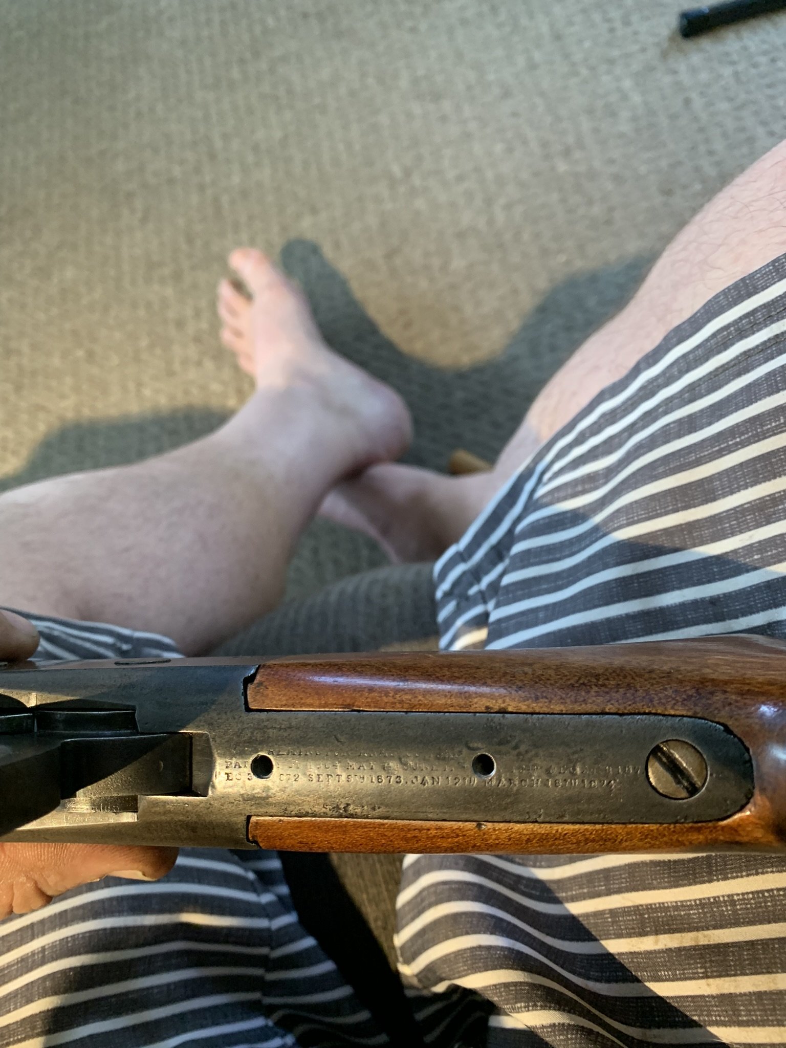

The Remington markings on the tang are well worn and difficult to read. The is a number stamped on the bottom of the left side of the receiver.

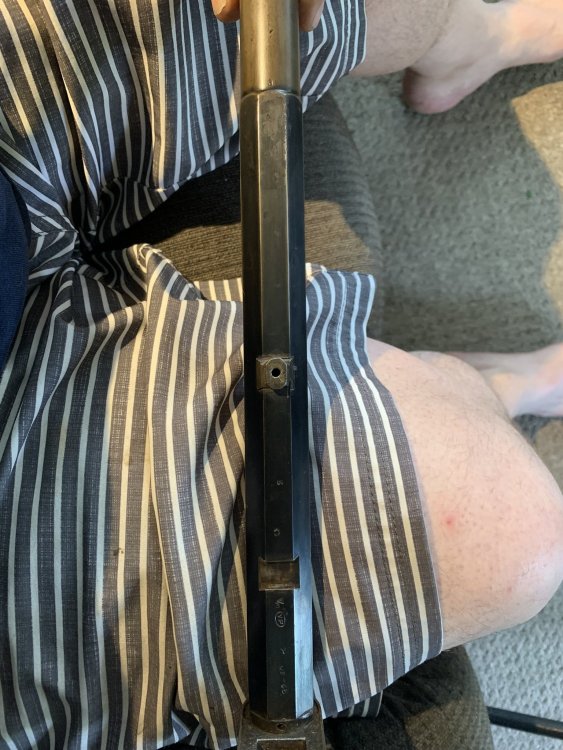

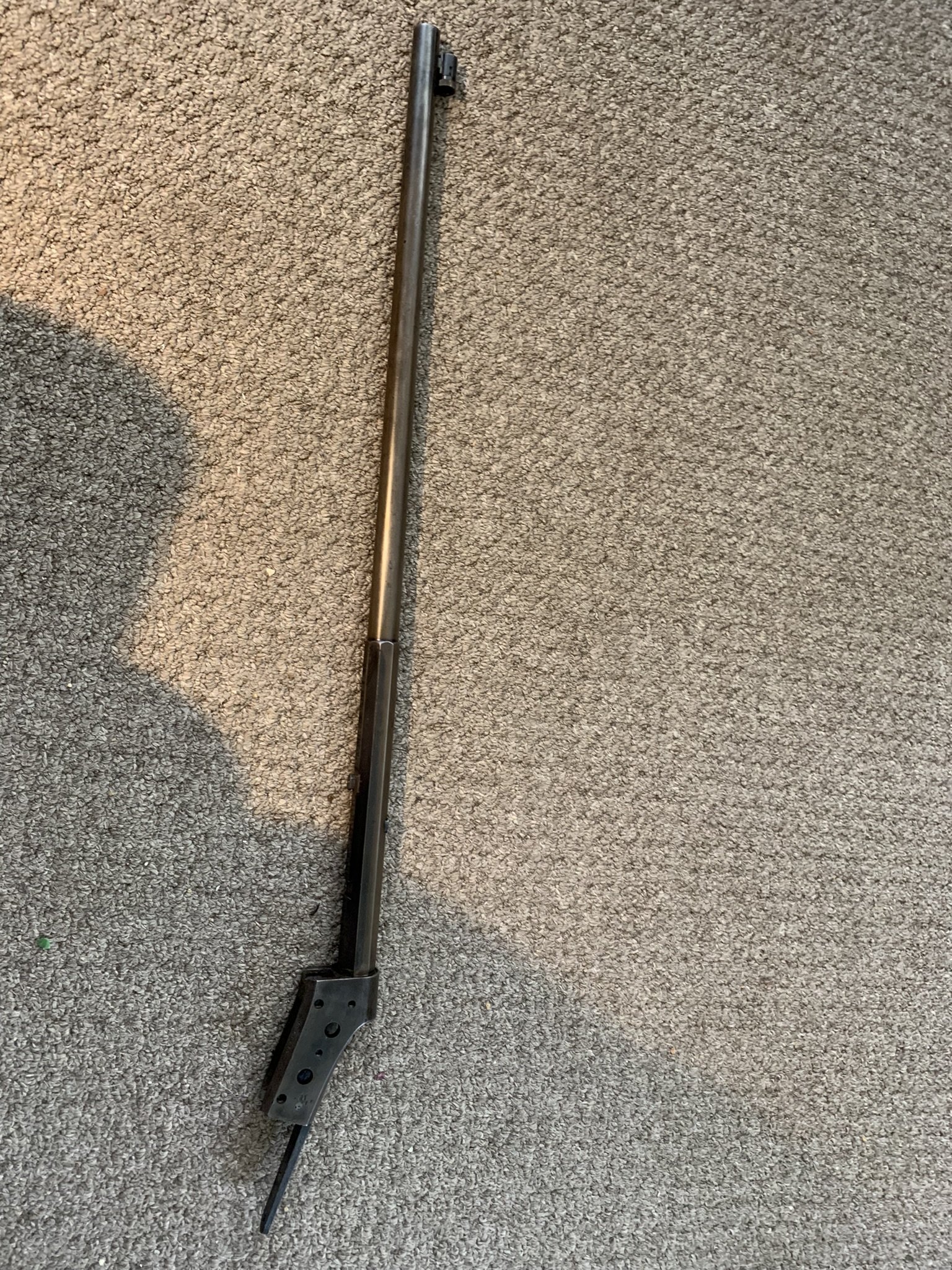

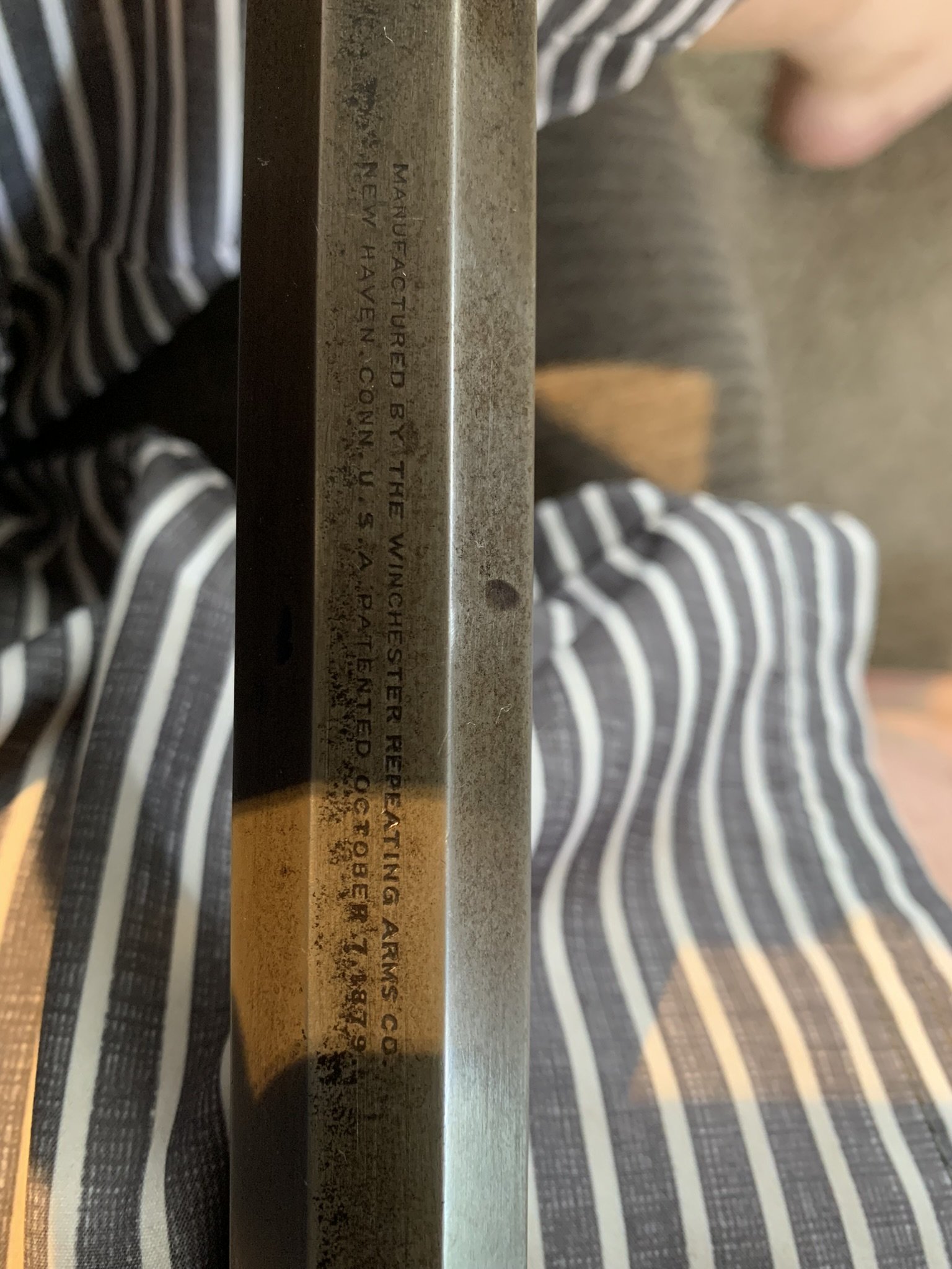

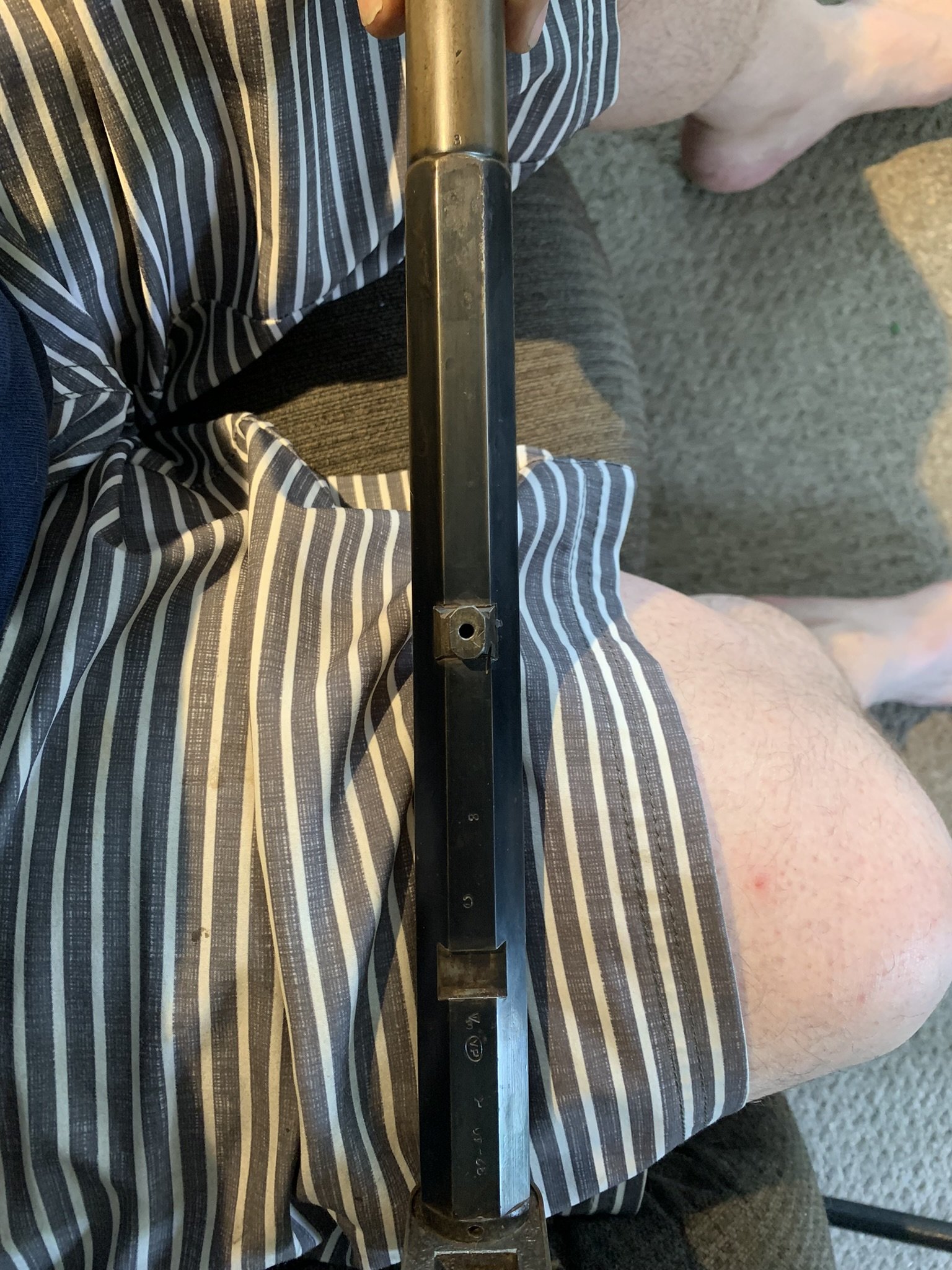

The half octagon barrel has Winchester markings on top that are visible. When I removed the fore end there are proof marks etc and it is stamped 32-40. (Not the 38-55 the I was told or the brass that came with it.)
My thoughts are it is a Remington rolling block that has a replacement Winchester barrel that was re-chambered from 32-40 to 38-55.  What do you all think?

My next question is, can the gun handle smokeless cartridges?  I am thinking the Remington action dates back to the 1870's or 1880's. The last patent stamped on the tang appears to be March 18th 1874.
I cannot see any manufature dates on the Winchester barrel.

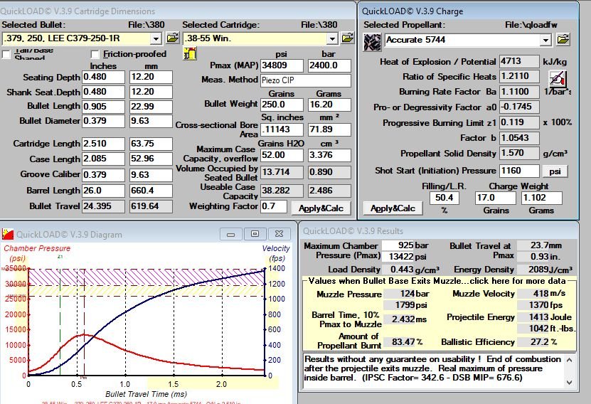

The smokeless powder I use to replicate BP loads in BP cartridges is Accurate XMP5744.  It has a moderately slow burn and a more gentle pressure curve than most smokeless powders.  I've used it 45 Colt, 45-70, .40-90SBN and .32-40.  I first used it on the recommendation of Mike Venturino in my .40-90SBN.  Since there's no published data with smokeless powders for this cartridge in any reloading manual;  in discussions with MV, he suggested to use the same data as 45-70, as the case volume is similar, and like bullets weights are available.  I did and found that velocities matched those attained with full loads of BP.  Here's a screen shot of what QuickLoad predicts with 17 grains of 5744 behind a 255 grain bullet in the .38-55.
As can be seen in the details it's predicts about 13,422 psi for approximately 1,370 fps from a 26" barrel.  This level is just below the minimum load listed by Hodgdon on their website @17.3 grains for a predicted 18,400 psi for a velocity of 1,324 fps out of a 24" barrel.  Their load data also shows a trim length of 2.075".  Whereas QuickLoad shows a case length of 2.085".  Also note that Hodgdon lists a COAL of 2.492" vs the QuickLoad length of 2.510".  QuickLoad doesn't have a data of BP rounds, so a direct comparison can't be made.  Since you don't know the date of your bbl, I also wouldn't recommend the use of any jacketed rounds, regardless of propellant.  While I won't argue with any of the above comments, keeping the load close to the velocities achieved with BP and with a powder that has those loads in the realm of BP pressures, I wouldn't feel unsafe using this powder at those minimal load densities.  I have an 1885 Highwall in .32-40 that I load with both BP and 5744.  In it I load 15 grains of 5744 behind a 170 grain cast bullet and achieve nearly identical velocities as my BP loads at the same trim and COAL lengths.  And while QuickLoad predicts higher pressures and higher velocities than what I actually achieve, it is not substantially more.  While there are stories of folks blowing up guns with 5744, I've personally never witnessed same, nor has anyone of my acquaintance.  Details are often sketchy, and in many instances, downright suspect.  The Hodgdon website, while a wonderful resource, is often lacking data on older cartridges.  Like my .32-40, the lightest bullet they list is a 196 grain, nor do they list any powders except Hodgdon's.  I had to find my load data in an older Accurate powder annual manual or in Lyman's Cast Bullet Handbook.
