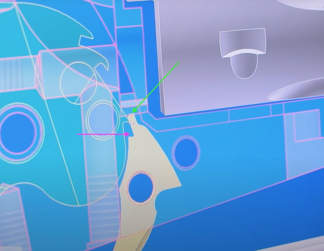

Larsen E. Pettifogger, SASS #32933 Posted September 22, 2023 Posted September 22, 2023 The timing of the Uberti short stroke is very precise. Advice that it might be this or it might be that is not going to fix the problem. The trigger, hand, bolt and hammer are all different. Here is just one critical adjustment. On a regular stroke the sear is the tip of the trigger (green arrow) and it fits into the half-cock and full cock notches and there is quite a bit of cylinder rotation between half-cock and full cock. On the short stroke the tip of the trigger (green) still fits into the half-cock but the full cock is a notch on the back of the trigger. (Purple arrow.) The parts are very hard to find so experimenting is not much of an option. If the gun is under warranty send it back to Uberti or one of the distributors and get it fixed. If the gun is out of warranty I would still send it back as parts are hard to get and not that many smiths can adjust them.
