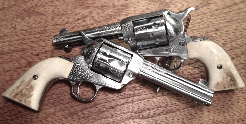

Silver Sam, SASS #34718L Posted April 26, 2022 Posted April 26, 2022 I ended using https://apwcogan.com/ For the brushed finish Hard Chrome They are Really Good Folks !!!! Here are the guns today..........

Silver Sam, SASS #34718L Posted April 26, 2022 Posted April 26, 2022 47 minutes ago, Father Kit Cool Gun Garth said: Silver Sam, That was your post from 2018 I posted forSeldom Seen. Nope.... The original Nickle plating was done at the same time I had the engraving done and had rubbed through in several places, was starting to have rust issues. So I send them to APW Cogan and they redid the finish in Hard Chrome. Yep, That was my post but the pictures in it were when the Nickle finish was new.... like 15 years ago er'so........ I dont think I will ever be able to wear off the Hard Chrome.
