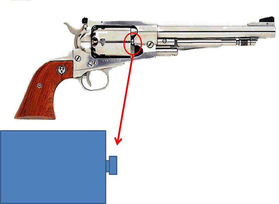

Gunner Gatlin, SASS 10274L Posted August 21, 2012 Author Posted August 21, 2012 Don't know why ya would want one. Other than cutting down on some weight forward. If ya don't use the rammer, which I don't, because I load out of the gun. The Ruger base pin works and I never turn the locking screw. The loading lever/base pin can't go anywhere. Also Ruger made the ROA pin a weeee bit different than the other pins. Must be why it never binds with fouling. Thanks anyway for thinking of us WJ Yes it is legal have seen some use it. Thanks - yup, just passin' along for those that may not be savvy to it I always thought the front of the cylinder and lip (here) was the big factor for reliable cylinder rotation by inhibiting fouling getting in the base pin area - the '58 Remmie doesn't have this and I think it's the Achilles heal.... GG ~

Gunner Gatlin, SASS 10274L Posted August 21, 2012 Author Posted August 21, 2012 OK Here are my thoughts on this and are probably not worth a thing. The ROA base pin/loading lever is not the same diameter through the whole cylinder. So therefore a very small area of it contacts the Cly. like a Vaquero. The Vaquero BP is the same Dia. for the total length of it. So more contacts the Cly. I shot Vaqueros that I sat up with the same clearances as the ROA. Barrel to Cly gap .080, Cly bushing .002 use same Goex 3F no lube with the ROA Vaqueros would bind after 2-3 stages. put a little Ballistol on the base pin no problem. ROA will shoot all day long with no oil, grease, lube on top of the ball, or no wonder wads. So the only difference is the base pin. IMHO, WJ My Vaq's cyl gap to barrel is about .007" - and they run all day with FFg Goex - Slim-Pony lubed Big Lube Bullets. I have heard folks trying to do grooves and such in their Remmie base pins, even adding lube in them before putting them in....but to no avail. The cylinder gap does have an effect I know that. The cylinder on a Vaquero doesn;t have collar like the ROA does here I always thought that the collared version in the ROA helped. GG ~
Wyandot Jim Posted August 21, 2012 Posted August 21, 2012 :rolleyes: :rolleyes: :rolleyes: My Vaq's cyl gap to barrel is about .007" - and they run all day with FFg Goex - Slim-Pony lubed Big Lube Bullets. I have heard folks trying to do grooves and such in their Remmie base pins, even adding lube in them before putting them in....but to no avail. The cylinder gap does have an effect I know that. The cylinder on a Vaquero doesn;t have collar like the ROA does here I always thought that the collared version in the ROA helped. GG ~ Hey GG, I don't know how that could help. Ya still got one surface running against another one. But just to set the record straight " I'm not the shapest knife in the drawer.
Gunner Gatlin, SASS 10274L Posted August 21, 2012 Author Posted August 21, 2012 :rolleyes: :rolleyes: :rolleyes: , Hey GG, I don't know how that could help. Ya still got one surface running against another one. But just to set the record straight " I'm not the shapest knife in the drawer. ..neither am I GG

irish ike, SASS #43615 Posted August 21, 2012 Posted August 21, 2012 The extended cylinder pin/face is like the old Schofields. That projection takes the opening of the cylinder and pin forward of the barrel face. It makes it much more difficult for the powder or crude to get into the cylinder and pin. Ask anyone who owns reproduction Schofields. They eliminated that cylinder protrusion and that made the pistol almost impossible to shoot black powder in. The BP frame colts have that same protrusion on the cylinder. Ike
