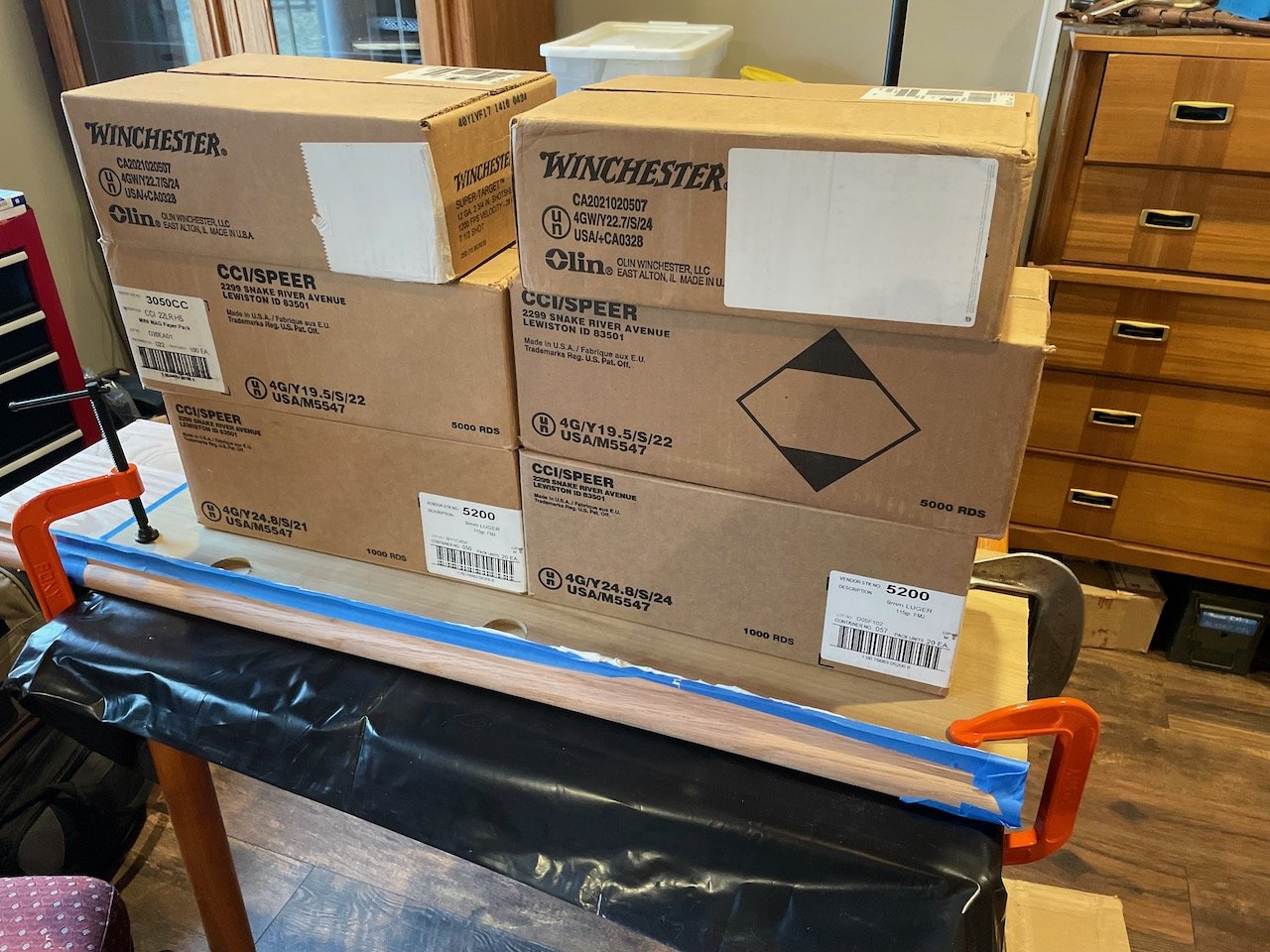

When glueing up panels, always use clamps to secure the work until the glue cures. Having some weights can also help:
I'll just let this sit and cook for a couple days.
4 hours ago, John Kloehr said:
When glueing up panels, always use clamps to secure the work until the glue cures. Having some weights can also help:.
9mm Luger and .22 lr are NOT CAS approved weights!
.45 Colt, is, of course, as decreed by God, the preferred weight.  Or, at least a historically correct 19th century cartridge, such as .38 special or .44-40, would be adequate, in a pinch.
i agree with the weight , i often use ammo cans of 45acp , 9mm , as well as 45co;ly and 38 spcl ,
