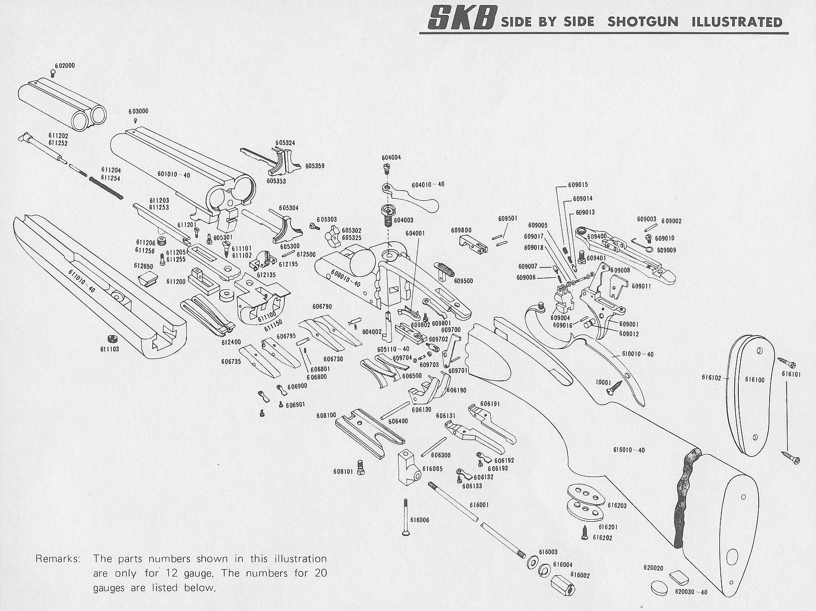

Blackhawk Bantry Posted June 4, 2023 Posted June 4, 2023 Howdy, I'm in the process of preparing my SKB 100 for CAS and what's next is to make sure that the gun switches barrels after the first shot while firing low recoil rounds. How do I do this? I've heard it can be achieved through a spring change, which spring do I have to change and how do I go about it?:

Larsen E. Pettifogger, SASS #32933 Posted June 5, 2023 Posted June 5, 2023 Before you do anything fire the gun with the loads you intend to shoot. If it switches barrels then you do not need to do anything. If it does not switch reliably the spring you have to change is part 609006. Remove the e-clip, push out the shaft and the pendulum (609004) will come free. Make sure the spring and plunger (609007) do not get lost. Where to get a lighter spring in Sweden I do not know. I have boxes of springs and just change them until I find one that works with my loads. Be careful not to put to light of a spring into the pendulum. If you do and point the barrels above horizontal the pendulum can swing back from its own weight and the gun will not switch or fire correctly.

Blackhawk Bantry Posted June 5, 2023 Author Posted June 5, 2023 9 hours ago, Larsen E. Pettifogger, SASS #32933 said: Before you do anything fire the gun with the loads you intend to shoot. If it switches barrels then you do not need to do anything. If it does not switch reliably the spring you have to change is part 609006. Remove the e-clip, push out the shaft and the pendulum (609004) will come free. Make sure the spring and plunger (609007) do not get lost. Where to get a lighter spring in Sweden I do not know. I have boxes of springs and just change them until I find one that works with my loads. Be careful not to put to light of a spring into the pendulum. If you do and point the barrels above horizontal the pendulum can swing back from its own weight and the gun will not switch or fire correctly. Thanks a lot.
